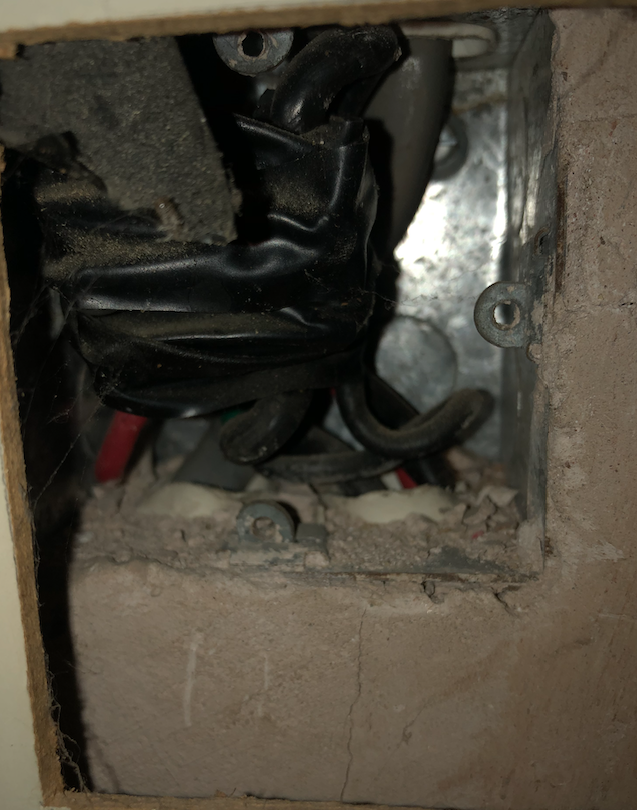

So I traced the 4mm hob cable and the 10mm oven cable back to see where they were fed from, expecting to find a cooker plate behind one of the kitchen units. Instead I found a flush mount back box buried in the wall and in that (with no cover on it) a big lump of terminal block wrapped up in insulating tape. See attached photo. The terminal block had a 10mm feed from the CCU going into it and then the 4mm and 10mm cables for the hob and oven. At least one of the terminals was quite loose.

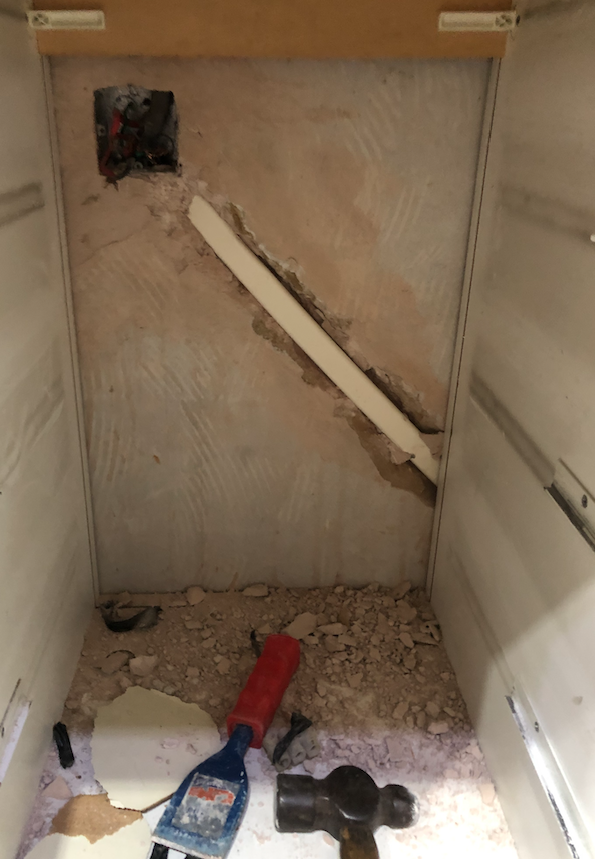

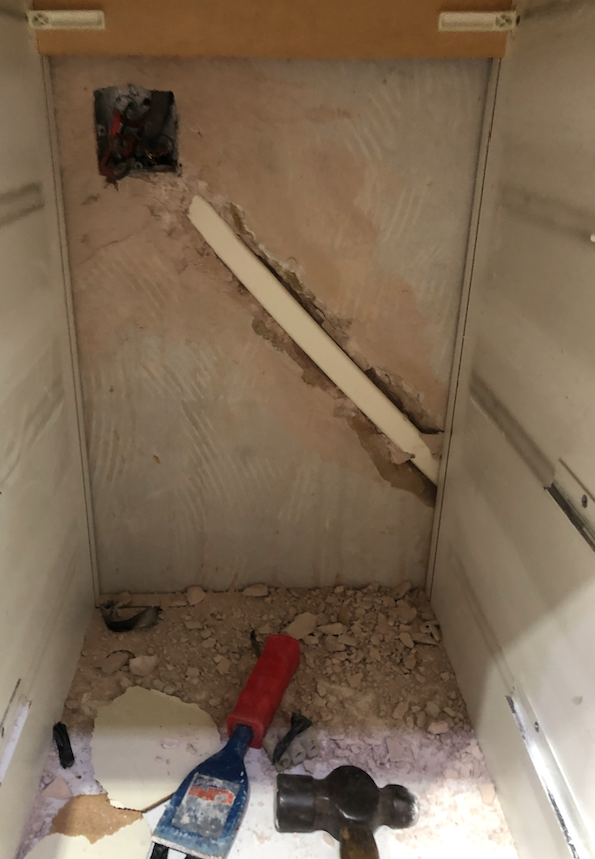

As a temporary solution, I have ripped out the buried 10mm cable to the oven (see attached photo) and replaced it with unburied 2.5mm T+E - which means that (after much swearing) I've been able to get everything to fit securely into the terminal block. But I now want to fix it properly.
My plan is to get a double cooker plate (https://www.tlc-direct.co.uk/Products/AA45DCOP.html) and fit that where the open back box is. This will be fed with the 10mm cable from the CCU. I'll run a 4mm2 T+E cable from the plate to the oven. And the hob will either be wired directly into the cooker plate using the flexible cable that came with it (if long enough) or I'll keep the existing arrangement of using 4mm2 T+E from the cooker plate and joining that to the hob's flex with WAGOs.

Everything is hugely oversized. 10mm² T&E is rated (method C - clipped or buried in masonry) at 64A
A 32A 4mm² (method C) circuit would have been sufficient for supplying all your appliances.
So, fit a double outlet plate and connect the hob to one with 4mm² flex and
the two ovens to the other, each with 2.5mm² flex.
