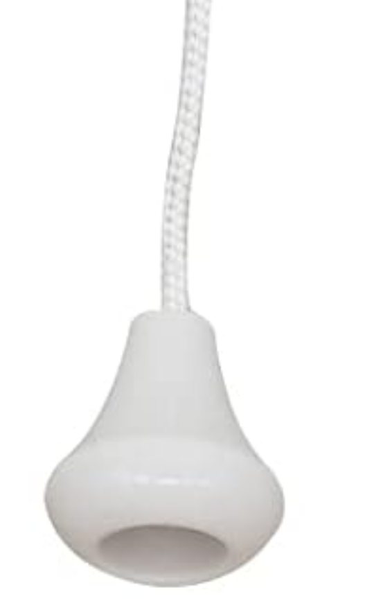

Which is exactly the reason there is a plastic 2 compartment insulating joint supplied with every pull-switch and replacement cord set.You can absolutely wet nylon. Water can attach to small crevices in nylon as it can attach to anything else similarly structured. Go find a cord and get a drop of water on the top. The water will conduct all the way down.
Water vapour will condense/settle in/on the nylon cord.
That was very probably part of the thinking which resulted in that design (the other being that it often enables one to replace most of the cord without having to fiddle about inside the switch).Which is exactly the reason there is a plastic 2 compartment insulating joint supplied with every pull-switch and replacement cord set.
I've always thought that the "other" reason was the only one.That was very probably part of the thinking which resulted in that design (the other being that it often enables one to replace most of the cord without having to fiddle about inside the switch).
Yes - or, at least, the only sensible reason - since, as you go onto say ...I've always thought that the "other" reason was the only one.
However, that by no means precludes the possibility that the 'non-sensible' reason may well have also been part of 'their' thinking..... can't possibly be a real hazard - the amount of (distilled) water which would need to soak into a nylon cord and travel upwards to bridge the electrical connections in a switch is utterly implausible.
Who said anything about distilled water?I've always thought that the "other" reason was the only one.
Because this:
can't possibly be a real hazard - the amount of (distilled) water which would need to soak into a nylon cord and travel upwards to bridge the electrical connections in a switch is utterly implausible. Cords get grubby, particularly when they have the "traditional" end like this:
and need to be easy to replace.
Eh? You shouldn't need any 'persuading' - evaporation followed by condensation IS 'distillation'.Who said anything about distilled water? .... Where is this ficticious distilled water coming from? .... Please don't try to persuade us the moisture in the bathroom miraculously goes through some form of distillation process while you have your shower.
Whilst much of what you say is correct, the progression to the insulating device was as I described, IE introduced to reduce electric shock risk.Eh? You shouldn't need any 'persuading' - evaporation followed by condensation IS 'distillation'.
In any event, even if it were 'dirty' tap water, full of minerals etc., there would be virtually no significant 'risk' - indeed, that would still be more-or-less true if the cord were bare copper wire![]()
I'm pleased to hear that you agree ....Whilst much of what you say is correct,
As I said at the start, it wouldn't surprise me if such were one of the reasons in the minds of those who designed these devices (even though 'ease of replacement' would seem a much more practically-important reason), but I'm not clear as to how you can be so sure that such was the primary reason. The change from machined brass to moulded plastic might, for all I know, have been entirely down to cost!the progression to the insulating device was as I described, IE introduced to reduce electric shock risk.
Well surely the cheaper version would not include the plastic insulator, to maximise profit make the pull switches sealed units so total replacement is required when the string needs replacement - just like so many other components these days.... As I said at the start, it wouldn't surprise me if such were one of the reasons in the minds of those who designed these devices (even though 'ease of replacement' would seem a much more practically-important reason), but I'm not clear as to how you can be so sure that such was the primary reason. The change from machined brass to moulded plastic might, for all I know, have been entirely down to cost!
As for 'reducing electric shock risk', I think the risk of a significant shock has always been extremely close to zero, throughout the evolution of the various designs of pull cords.
