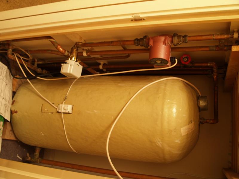

Hi,
I've seen various questions relating to pump noise etc and I've narrowed down my fault, but wondering if there is any advice as to cure?
Background:
Potterton Netaheat 30 boiler
open vented system
Grundfos Selectric 15 50 pump
Drayton controls incl Drayton mid position valve
When the Potterton is on control setting 1 it all works fine, but if the temperature drops down to the -5 degrees outside, the boiler can struggle to keep the house at 21 degrees. Therefore increase Potterton to 3 and when it all fires up, the grundfos pump draws in air and makes a horrible grinding noise. Air can be heard circulating round system for a bit. The open vent pipe is 2m in height so tall enough I understand not to be drawing air in, though not had a chance to try the pint glass test yet.
Seems like it's the boiler causing the problem, but I don;t yet understand what it's doing or what is causing it.
Any ideas?
Obviously, if I need to supply more info, let me know and I'll confirm.
It's not the boiler but restrictions/blockages in your system close to the cold feed and open vent.Need more info on system.Can you upload a pic of your airing cupboard installation?
Ah ok. I'm off out now, but will post up a photo later/tomorrow.

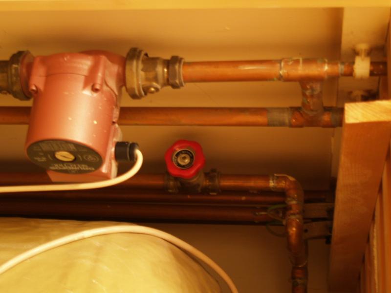

Possibly scaled up heat exchanger restricting flow to pump, which causes cavitation to pump, which with hotter water means the water boils, leaving the pump short of cooling/lubrication.
Second picture down will be where the problem is.Called the H section just above the pump and will be restricted in that area.Needs cutting out and cleaning.Blockage usually in 15mm cold feed.Forget about scaled heat exch. :)
