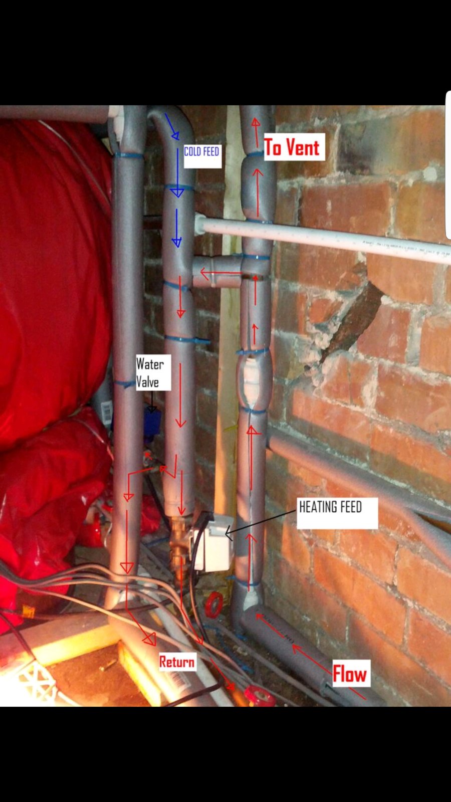

Pump in wrong place on Open Vent system...

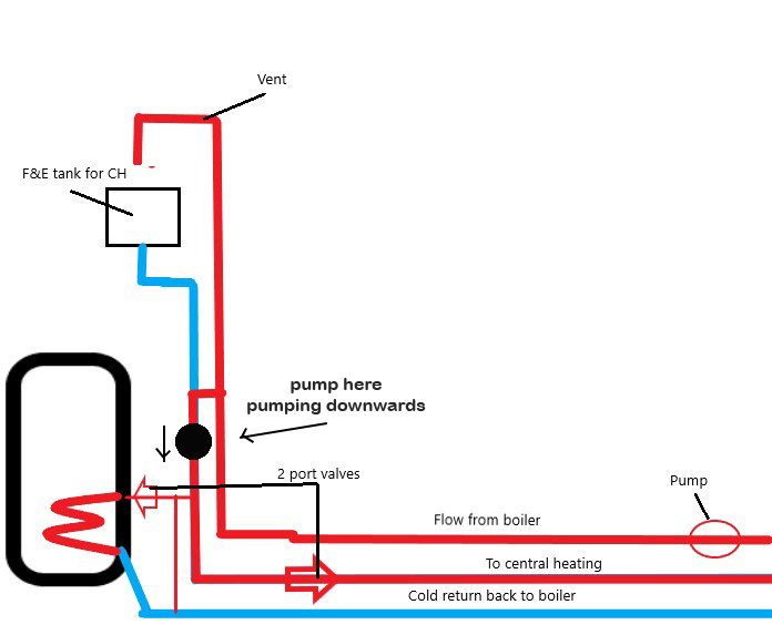

this is where your pump needs to be, if there's no room on that pipe you're going to have to re-configure the pipework to accommodate it
Exactly as I thought, however the pump needs to be connected (electrically) to the boiler due to the overrun function. Getting a connection up there is going to mean a lot of upheaval with regards to running the cable. Unless I can run a cable externally up the side of the house? Is that possible, or are there rags that prevent this?
Basically, all that stuff on the left of the picture is up in the loft, the boiler is on the ground floor at the back of the house with the pump right after it on the flow pipe. I have attached a picture but the pipe labelled return is incorrect. I think that's actually the hit water going to the taps etc.... The pipe that's actually returning to the boiler is the white plastic one you can see that comes out the bottom of the cyl

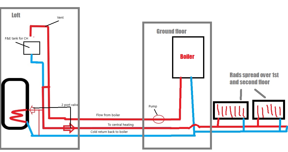

The photo doesn't give the whole story, a sketch of the complete system would be better.
You say the vent is in the loft, obviously that's where the outlet into the F/E tank is, but the pipe must be tee'd off somewhere, maybe that point isn't quite as remote.
Is the cold fill on the boiler return? For an old system it probably is. If so, I think you'd be OK repositioning the pump to the return, between the cold fill point and the boiler. With pumped return the open vent would normally be between cold fill and pump, but yours would be OK. Some say it's better to have the boiler on the return, as it runs cooler there so should last longer.

There's not much more to show in a sketch, but I have added some extra info in this one which may help. I'm not sure what you mean by the cold feed being teed off somewhere? The cold water feed that comes from the tank, is shown in the sketch and the picture. Its a 22mm pipe dropping from the tank and heads towards the central heating two port valve. If that valve is shut, there is a 15mm pipe that links that feed back round to the 22mm pipe coming out of the bottom of the cylinder, which fffrom my workings is what heads back to the boiler (return). The flow pipe from the boiler which heads to the vent splits off and joins the cold feed from the tank (where red meets blue before the vent in the sketch)

looking at the latest supplied information,info helps :idea:. A repair to prevent gurgling/boiling over warming the plastic expansion tank needs to be sought.
Alterations should include wiring the pump to the boiler,fitting a system bypass,converting to sealed system,ensure the radiators actually need the full boiler output and anything else following onsite investigation.
straight forward repair to bring it up to how it should have been installed :!: Hopefully the boiler or the system is not already damaged (n)
Just to answer this point - it's the vent being tee'd off a pipe I was talking about, not the cold feed. If on your sketch you follow the pipe down from the vent above the F/E tank, the tee is the first junction you come to. I assume that point isn't in the loft.
Incidentally, if your sketch shows how it is physically, I wouldn't do it like that, as the circulating flow can shoot straight up to the vent, and exacerbate the risk of pump over. Better to tee off a horizontal pipe.
