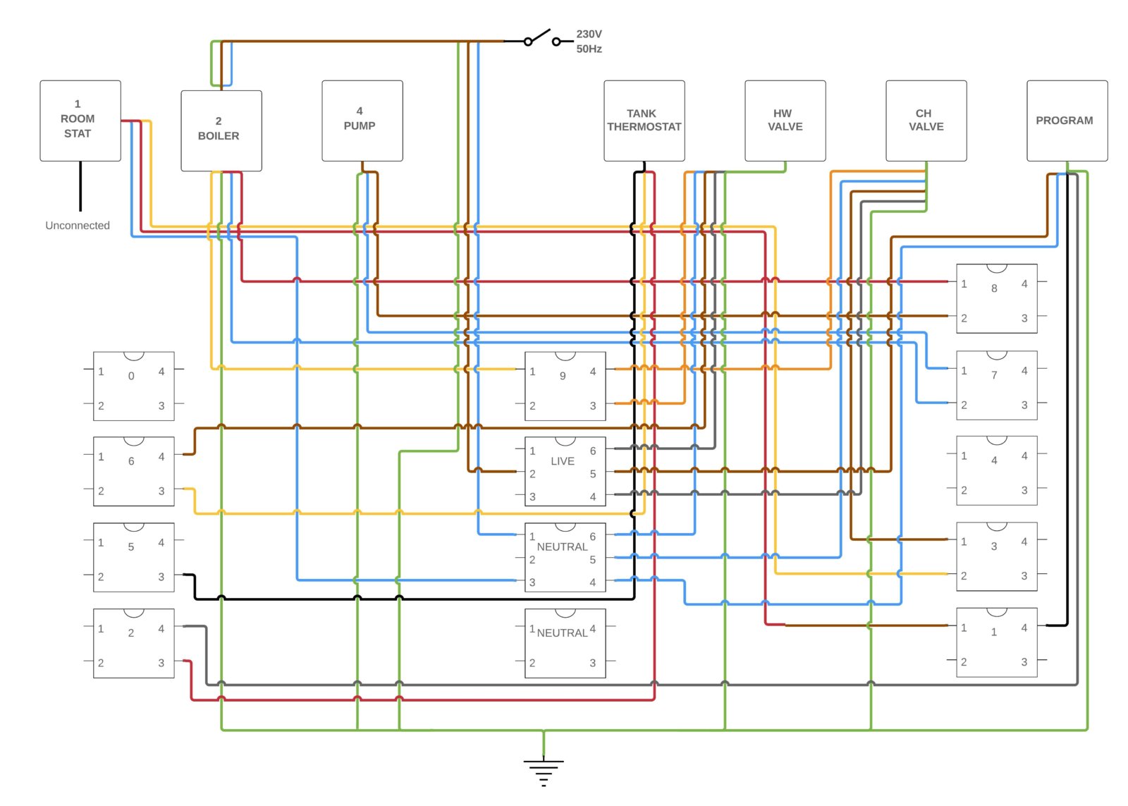

Hi all
I have a Worcester Bosch Greenstar Ri boiler.
When the boiler switches off, the central heating pump switches off at the same time and the boiler makes a grumbling chuntering sound for a few minutes. I believe this maybe due to the fact that the pump is not running for another 3 minutes to dissipate the heat as it says it should do in the boiler installation and maintenance instructions.
I suspected this might be due to some incorrect wiring so I've had a look at the wiring centre and have drawn a diagram of the connections.
But as far as I can see, everything is correctly wired.
The live pump and neutral pump wires appear to be connected properly to the boiler.
So I'm a bit baffled as to why the pump switches off when the boiler does.
If anybody can see a problem or has any other advice I'd be very grateful to hear it.
Thanks a lot!
I think I follow your wiring diagram.
It looks like there is no permanent live supply to your boiler.
This is required for the pump over-run to work.
Though looking again it also looks like there is no neutral either, as you just show the neutral connected to the pump, but there must be if the boiler is working.

Oh sorry I should have said that the boiler has a separate permanent Live, Neutral and Earth connection which I've just added to the diagram.

That wiring layout is highly dangerous...you should only have a single source of mains power...either to the boiler (and then to the wiring centre) or vice versa.
Engineers have been electrocuted due to thinking the systems isolated not realising there are multiple sources of 240V.
Get it sorted out asap.
Who installed it like that?

Apologies, my diagram was crap and I had left out the fact that the boiler and wiring centre share the same same mains source. I've updated the diagram. Thanks for your input, much appreciated.
Pump overrun is controlled by a timer on the boiler PCB, which is why the pump is wired to specific terminals on the PCB (terminal block ST2). As the pump works OK when the boiler is on, there's a good chance that the timer is fault. Unfortunately this means a new PCB. WB do a fixd price repair.

If the boiler is still under warranty you should not involve a third party. Get the installer back, he will handle the warranty claim for you. You should not be charged - unless the fault is not boiler related.
It turns out that the boiler has been wired differently to what is described in the manufacturers instructions.
For some reason the installer had connected the permanent live mains feed to the boiler's switched live/call for heat terminal, and the switched live/call for heat wire to the boiler's permanent live terminal.
So this is either done intentionally, or it's a cock up.
Is there any possible reason why a boiler would be wired like this on purpose?
