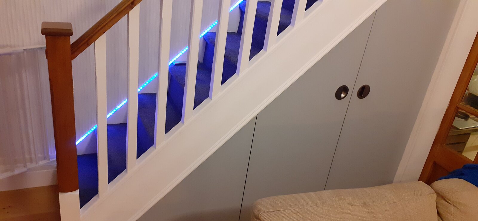

general comments not sure what you are trying to acheiveve
the thickness off the door makes zero difference to the amount the door opens that is decided by the hinge position the skirting position and angle off cut
if you move the hinge knuckle out say 3mm the door will open perhaps 10% more the same with increasing face angle to shallower and increase the set back on the skirting by 2mm each side you could perhaps be at 45 degrees with all 3 actions ??

The pic was my cheap and nasty cupboard under the stairs, in my cheap and nasty house, that I made from cheap and nasty IKEA wardrobe doors - I was quite happy with the result!
