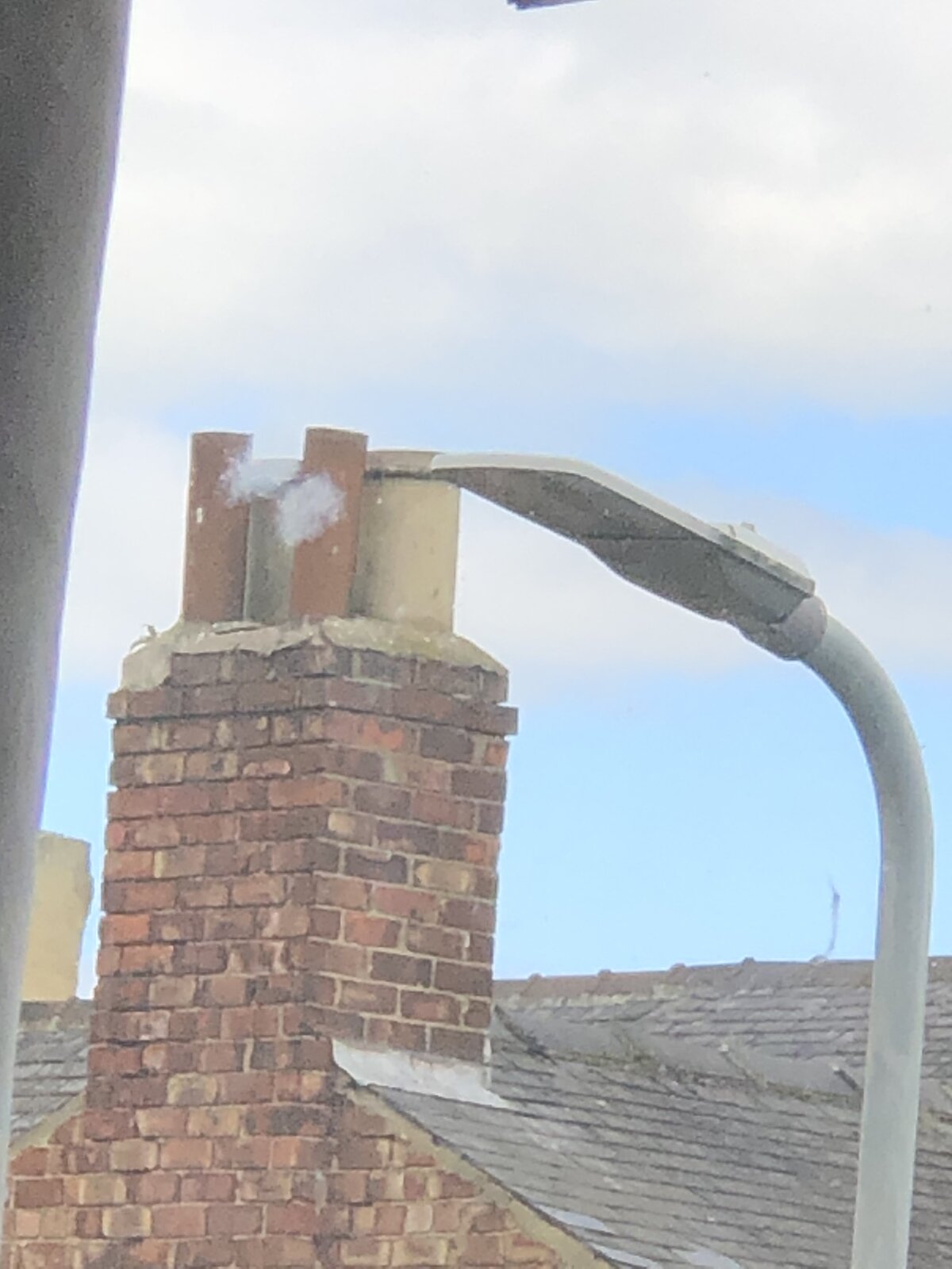

Purpose of very skinny chimney pot
3 Jan 2014
176
4
Middlesbrough
Hi all
Working at someone’s house last week and happened to notice the properties out the back had 2 pots on the rear chimney stack
I noticed how skinny the rear ones were, more like a very thin tube
What’s the likely purpose of this one? I know most likely for an old bedroom fireplace but I’m surprised to see them that thin
Might be for a gas appliance, might be a lash up using bits of clay soil pipe.
So the next question is why?
What’s it serving
Around 10 houses have them and a few others would have had them
Bedroom fireplace? Surely not going to clear enough smoke to make it useable
Unless there’s some Edwardian gas heater or ventilation for something

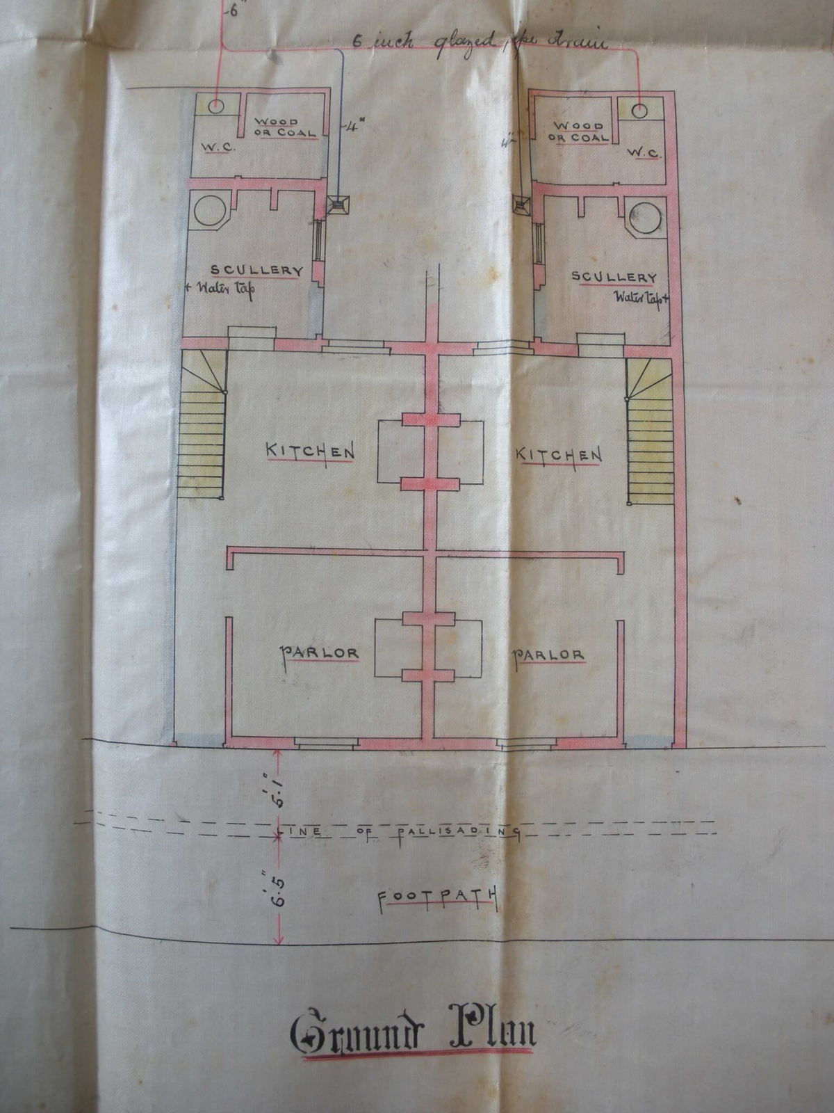

My guess is this.
The water heating in Victorian terraces was usually carried out in the scullery, at the rear of the house - the original 'Copper' is the circle shown below...
This would likely be the first places in the property to be equipped with a gas geyser, or other means of heating the water cylinder; hence a dedicated clay flue from the scullery may have been installed?
Examples here..
Edit:
Or, it could be the original flue from a slightly later style of 'Copper'?
