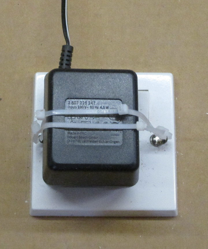

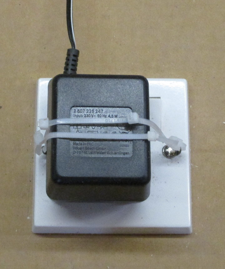

Probably the most common situation is when someone wants to have something in the loft space (aerial amplifier, other AV/IT equipment etc.) which is powered by a wallwart, and with the only wiring in the loft space being lighting circuit(s). In that situation, my personal view would be that putting a 13A socket on the lighting circuit could not be 'reasonably conveniently avoided', and I would therefore do it - but I certainly would label the socket accordingly and/or take steps to prevent the wallwart being removed 'without the use of a tool' ... and here is one "I did earlier" :) ....

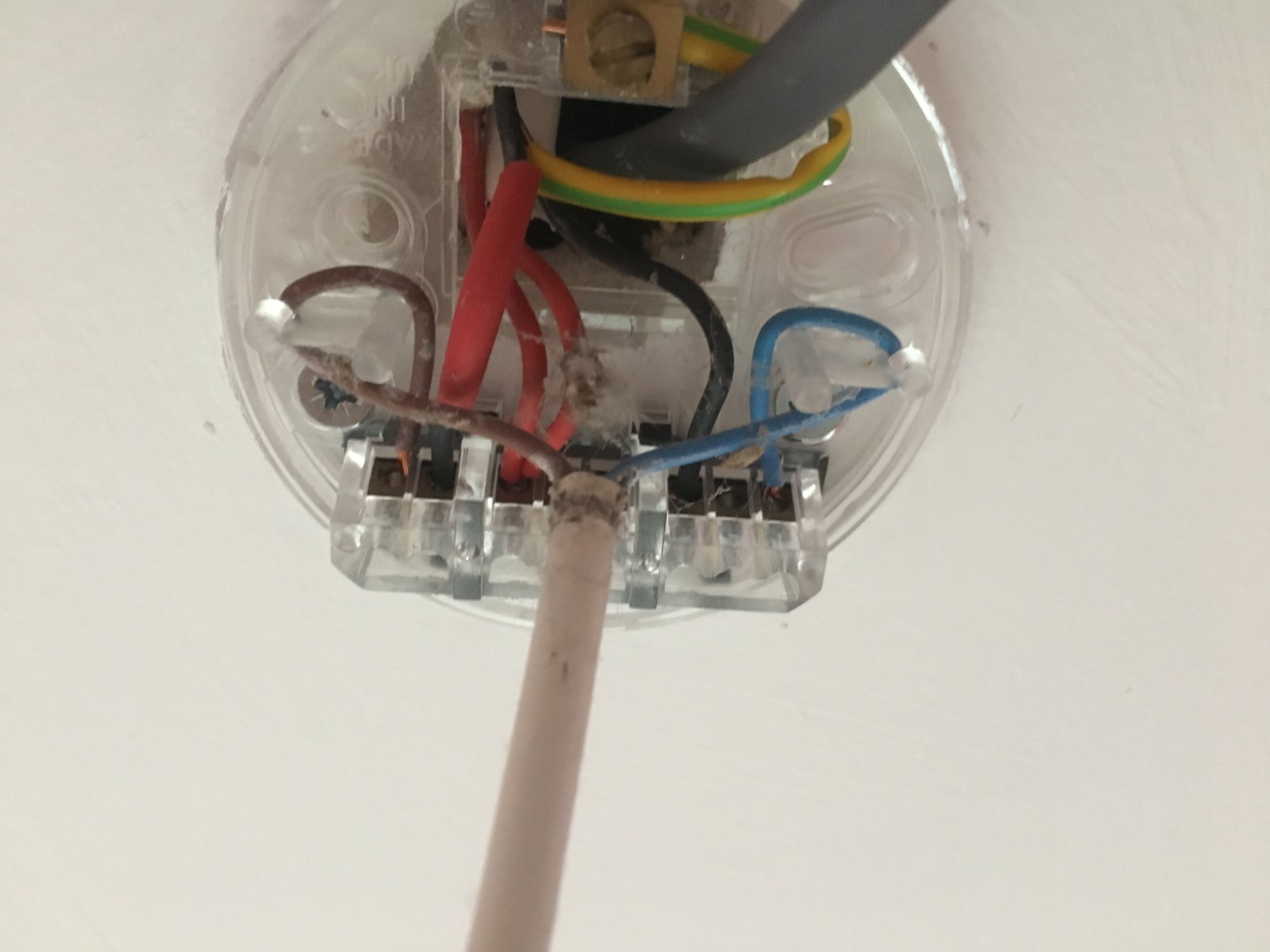

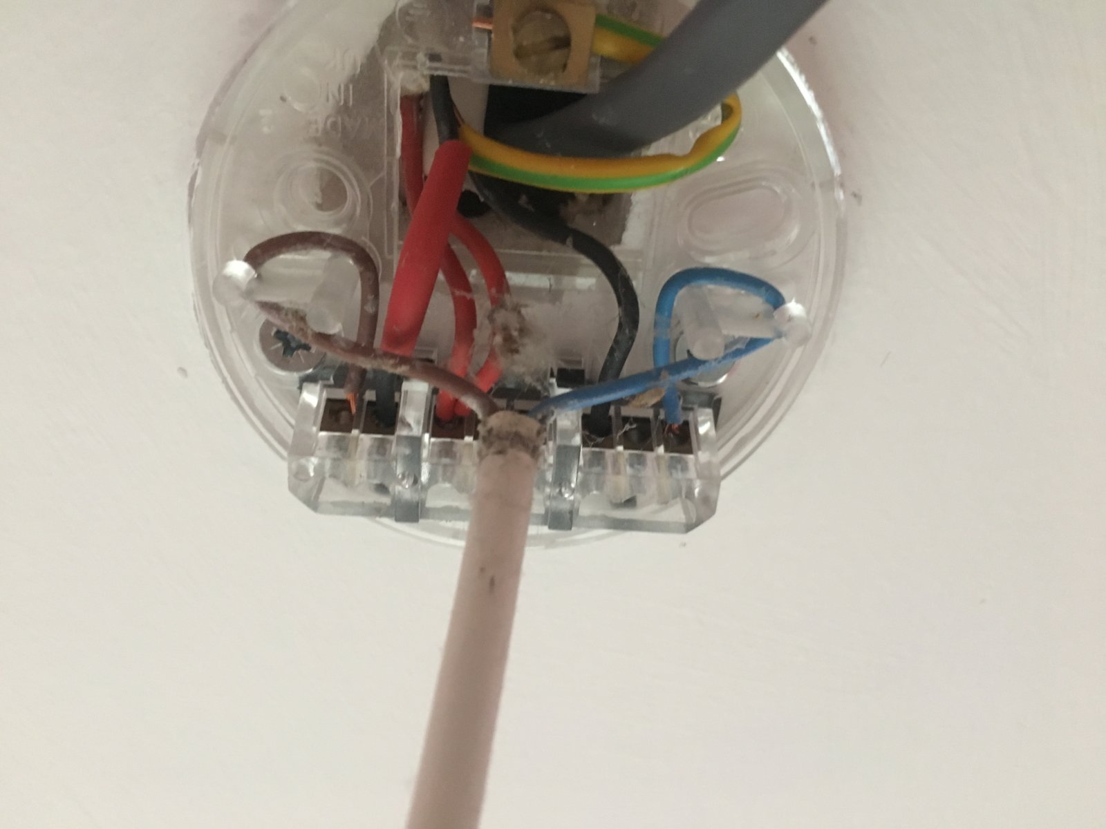

Ok, so I’ve wired the socket into a ceiling rose as suggested.
I’ve clearly done something wrong. It works fine, but only when I turn the light on. Have I used the switched live terminal? I take it I can have it powered all the time without having to turn the light on!
The picture is the ceiling rose before I began.
