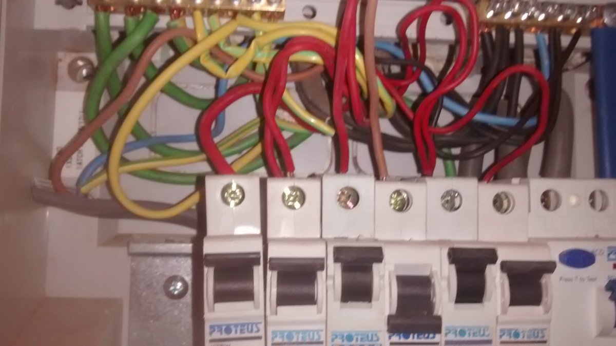

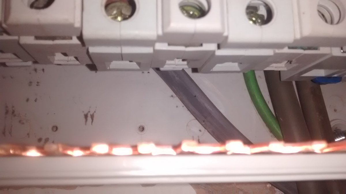

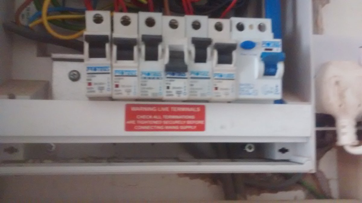

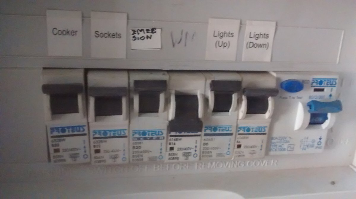

Okay the puzzle continues I have taken some pictures
When the busbar is removed from RCD/ISO and MCBs, the socket still remains powered up when RCD/ISO is closed and powers down when RCD/ISO is opened.
