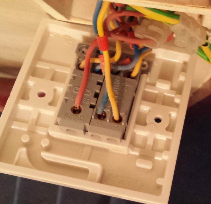

As part of a redecoration project I'm looking to replace several light switches with something "posher". :)
I've worked out what I need in all cases except one. The switch looks like it's been put together from modules, but I'm hopeful that I can source a replacement from a standard range.
Can anyone identify what I need? The switch is part of a lighting set controlling upstairs landing and downstairs hall lights. The upstairs lights can be controlled from three locations. I hope the attached pic clarifies things.
The one on the right is an intermediate so that's what you need.
A pair of intermediates will be fine.
Thanks for the prompt reply. Presumably the intermediate not used as an intermediate will need to be wired to function as a normal two-way. How's this done?
Back in the old days they did not make double internediate switches. They aren't too common even now. So maybe select a range that has a 2 gang intermediate or you'll be forced down the grid switch road and end up with something like you already have :!:
There's info in the wonderful WIKI on how to use an intermediate as a 2-way switch. Its is at the bottom of this page //www.diynot.com/wiki/Electrics:Intermediate
