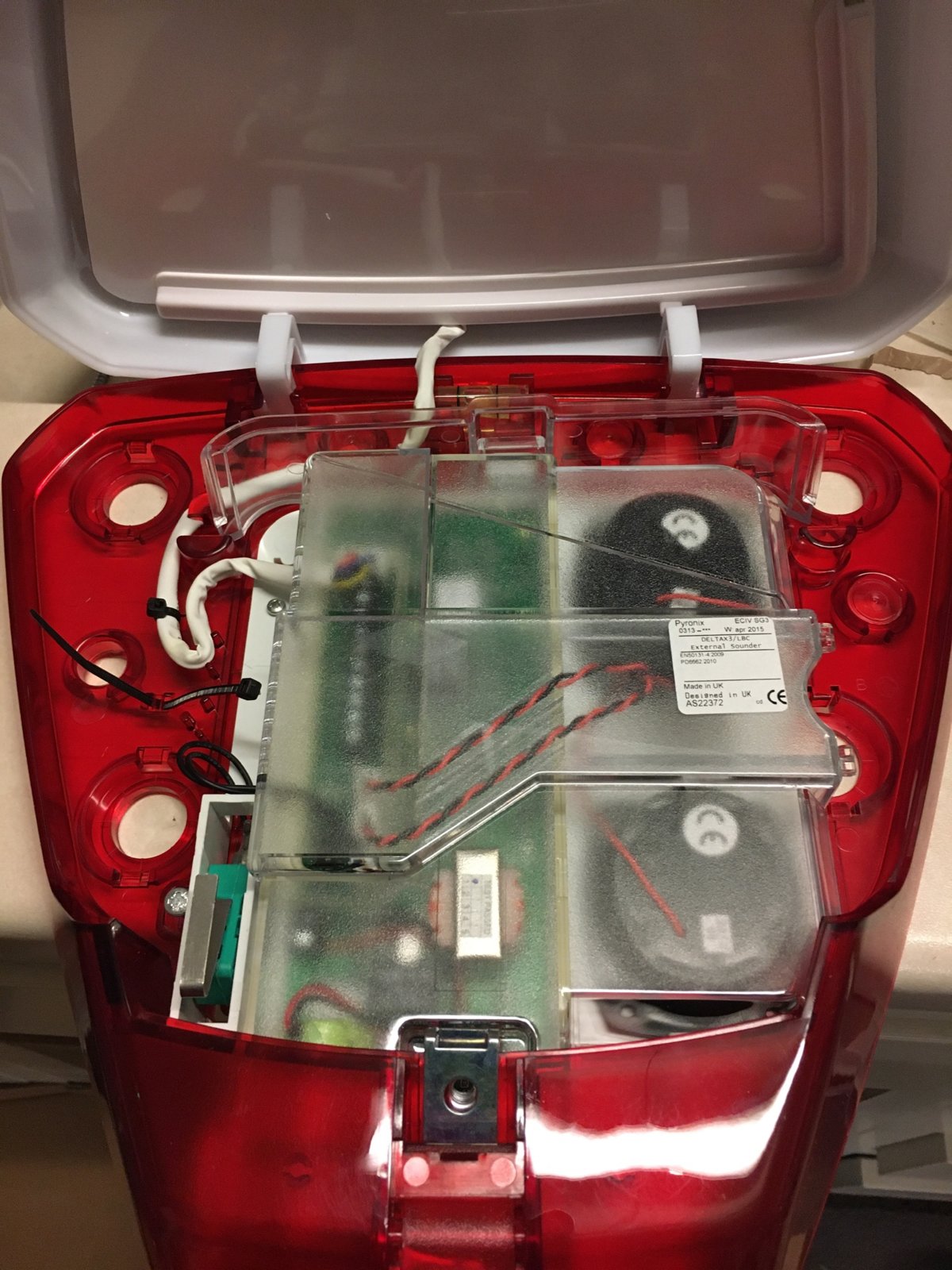

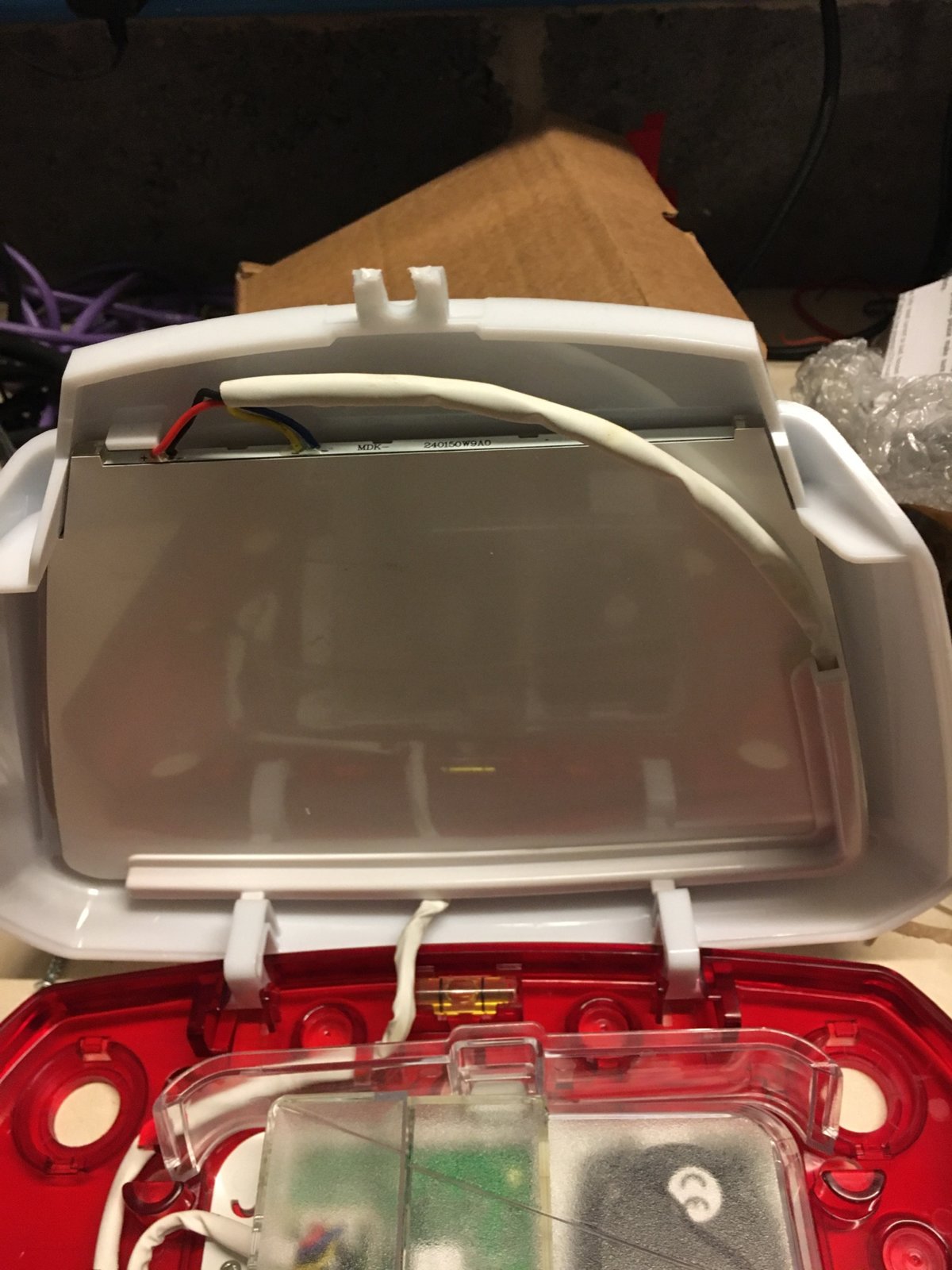

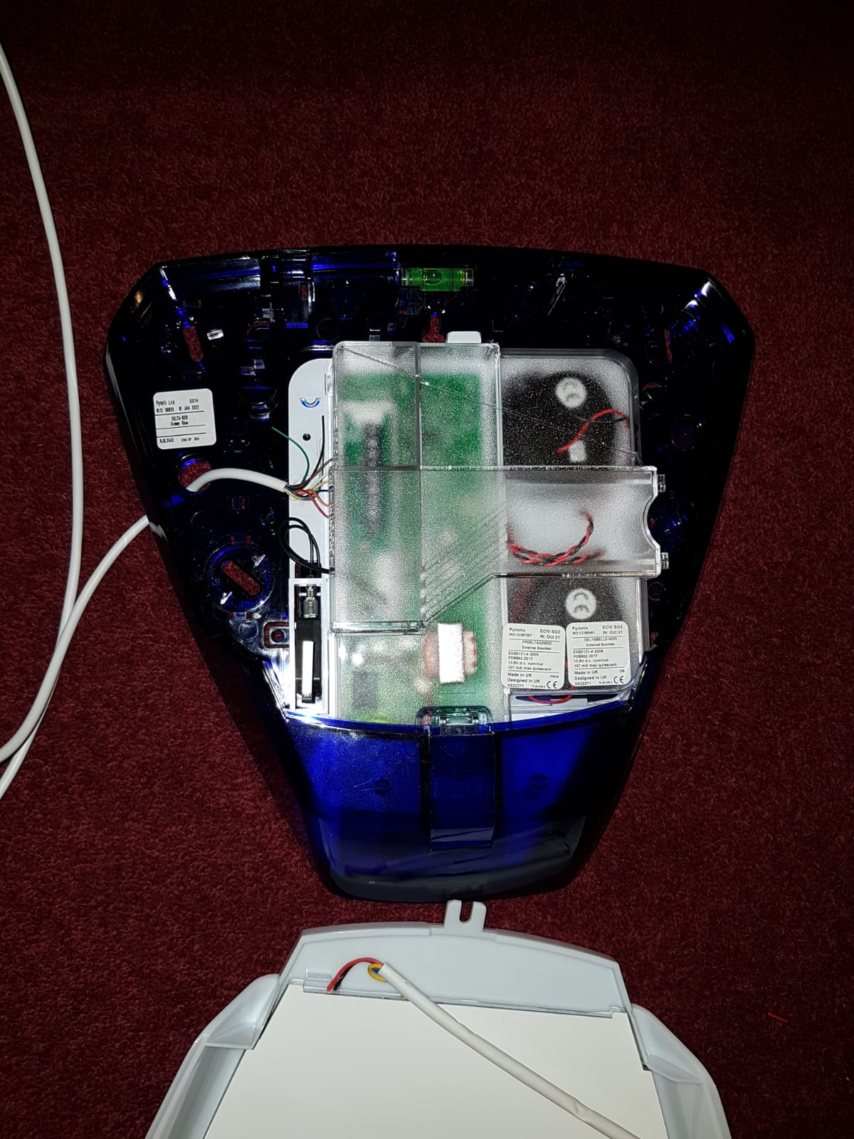

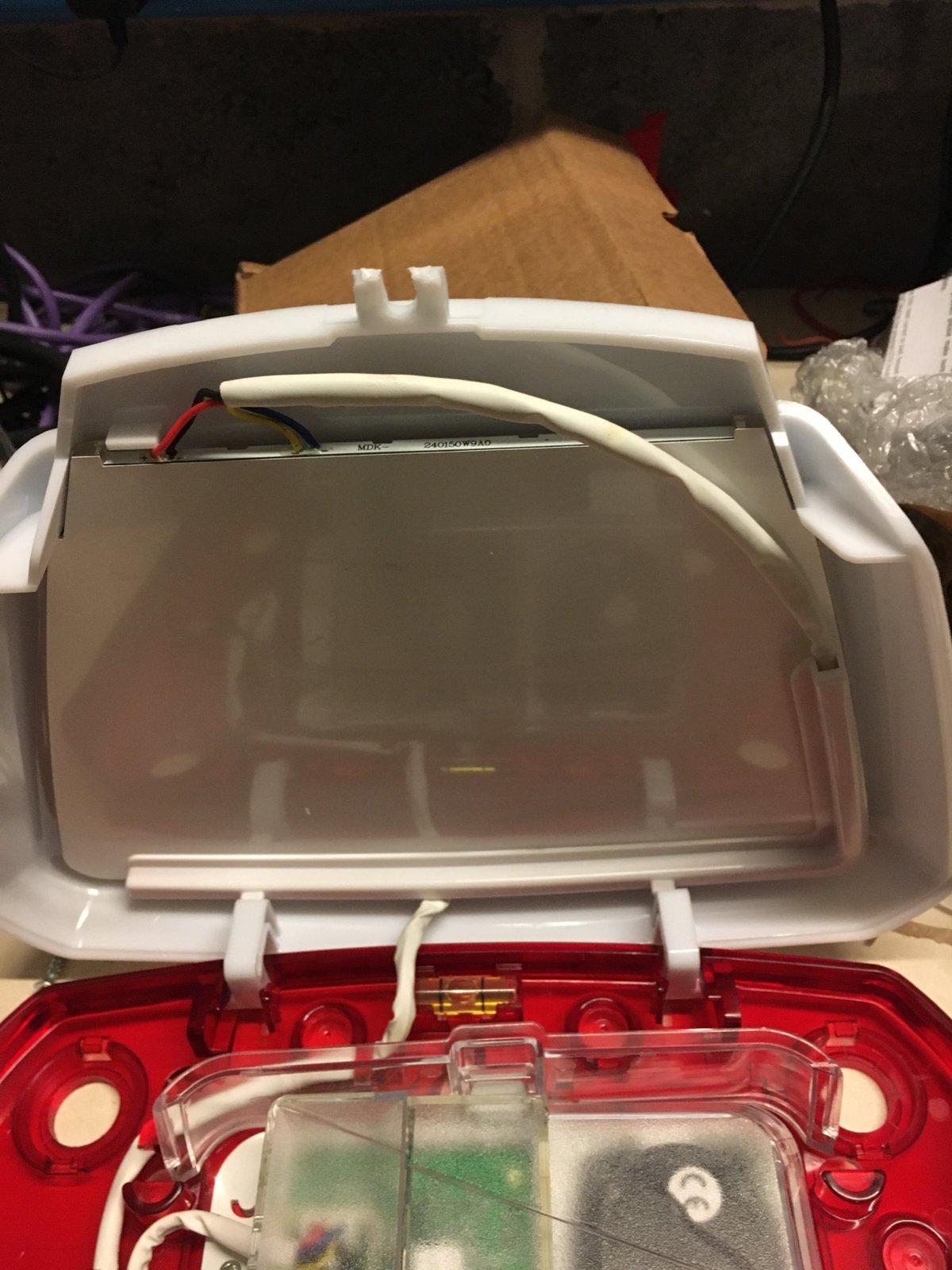

Hi, Hoping someone can help....
I've fitted a lightbox module (FPDELTAX-Light) to the inside of the lid/cover (FPDELTA-CW) but can't seem to close the lid. The lightbox cable gets in between the lid and deltabell x module (FPDELTAX2MOD). The back plate is FPDELTA-BDB.
What am i doing wrong? is there a different lid to be used with the lightbox?
any help appreciated.
thanks.
I've tried using brute force but then the lid doesn't close flush with the base and there is a risk of water seeping in. The only other option ( i can see) would be to somehow route the lightbox cable around the module.
have you done one of these and can say if it was straighforward or a little tricky to move the cable out of the way?
thanks sparky. hats off for all the help you give to others on here.

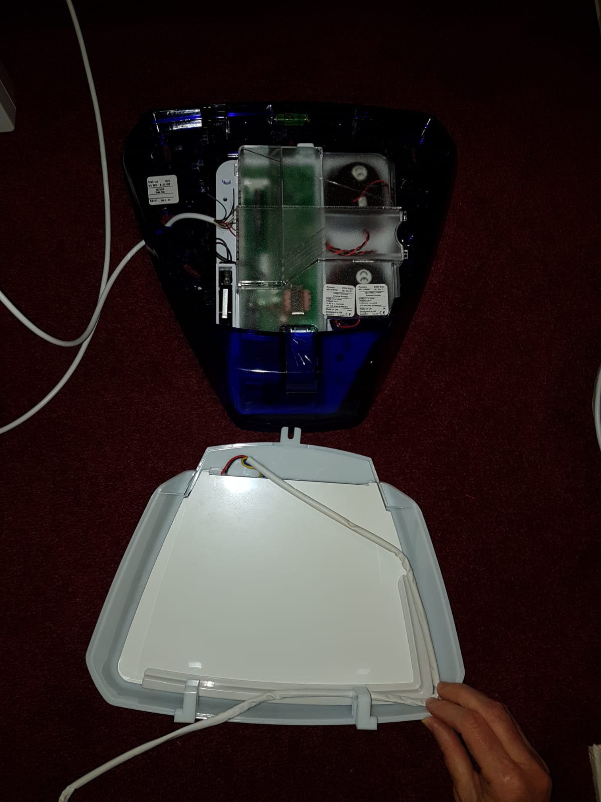

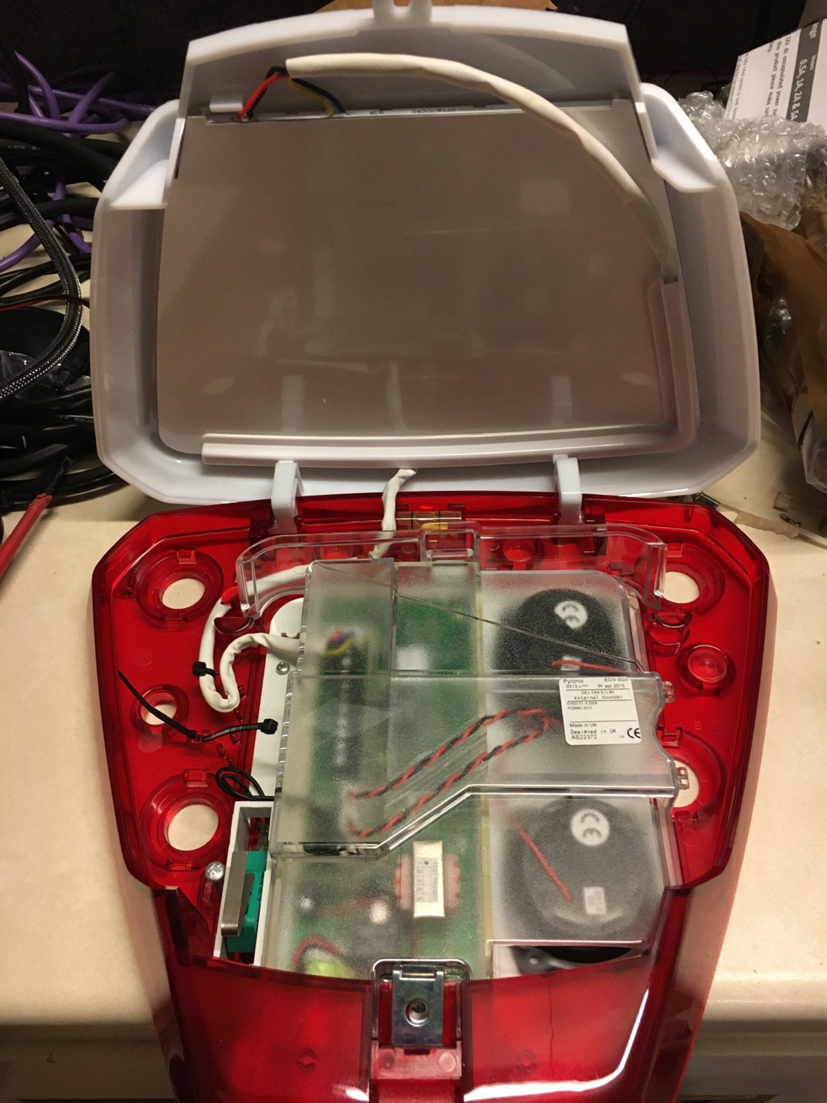

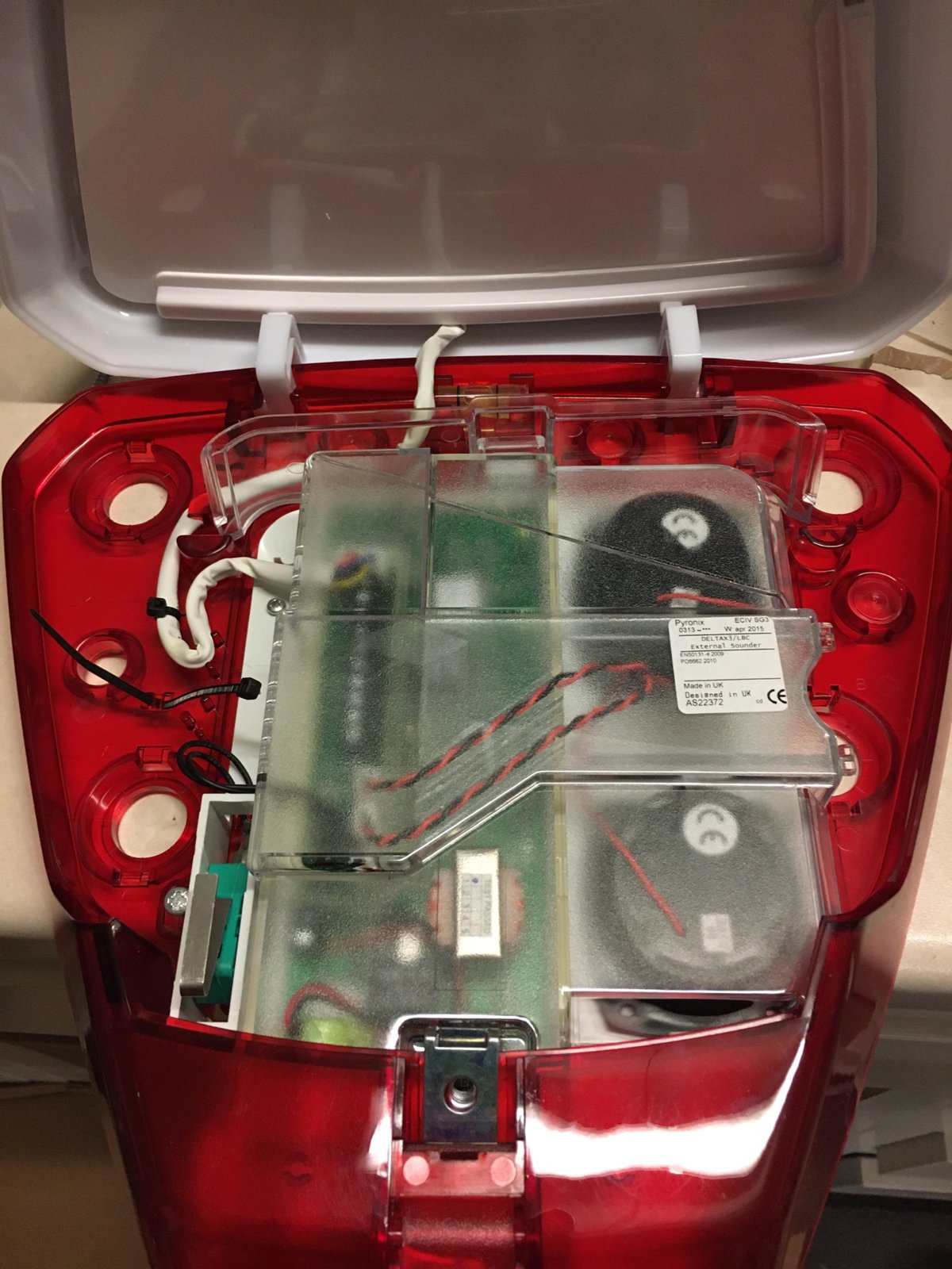

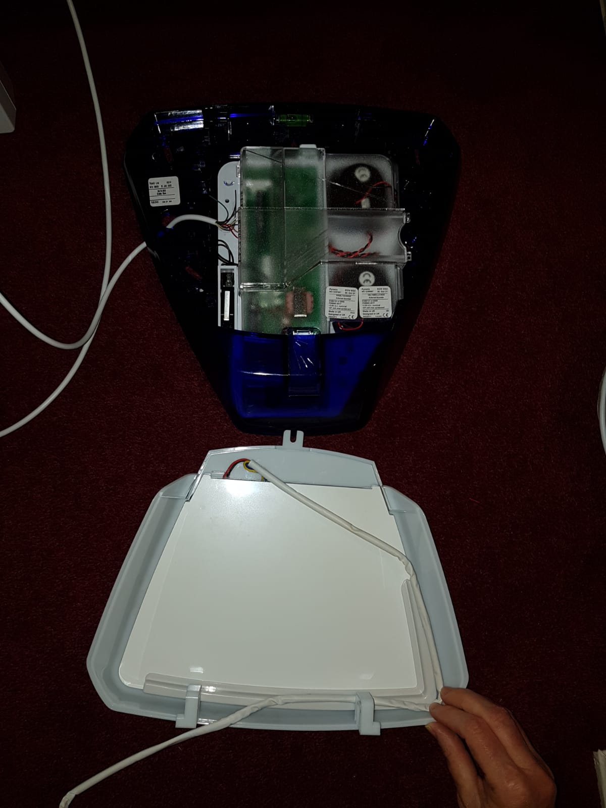

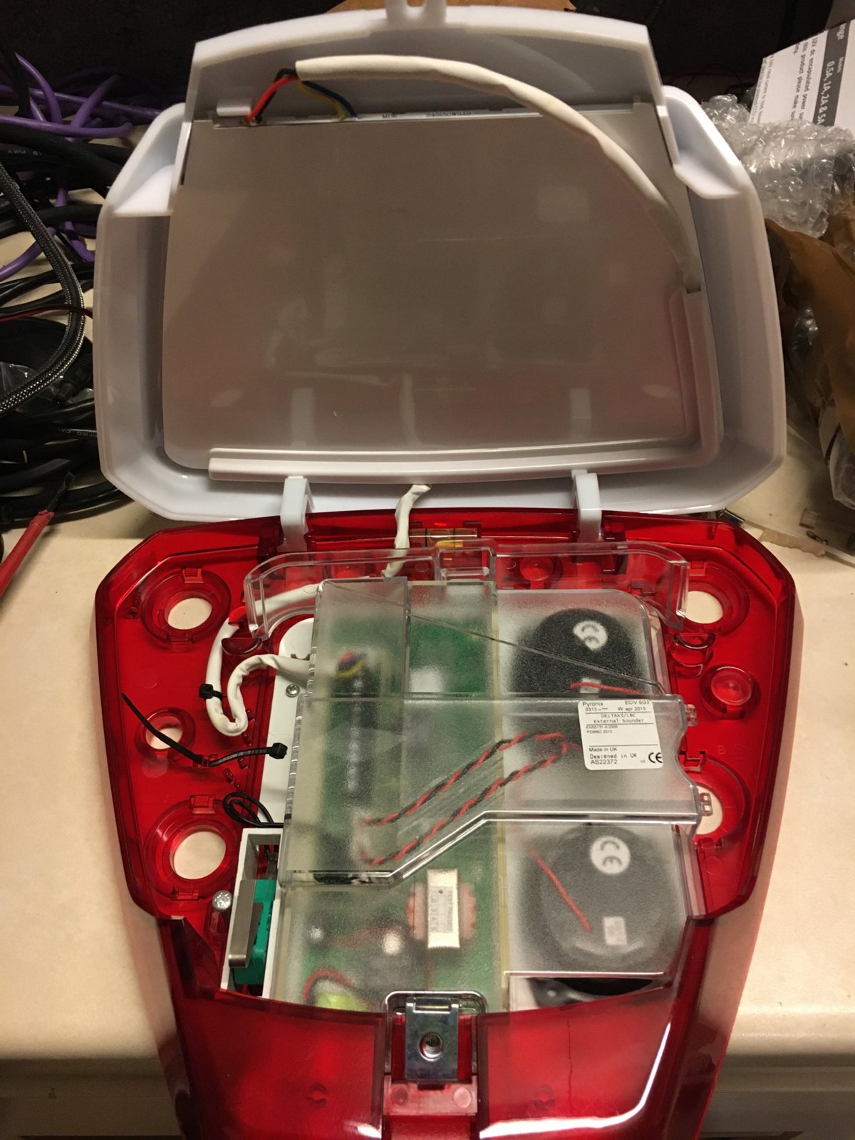

see 2 pics below.
the white cable for the lighbox was in the plastic housing (which can be seen underneath it) but i took it out to try to make it fit.
When it was in its housing and i tried to close the lid it would get jammed between the lightbox and the module lid. You can actually see the small indentation in the white cable from where i've tried to push the main lid down.
thank you. it looks like your white cable has a bit more give in it so it can be moved out of the way when closing the lid. anyway, i know what i need to do.

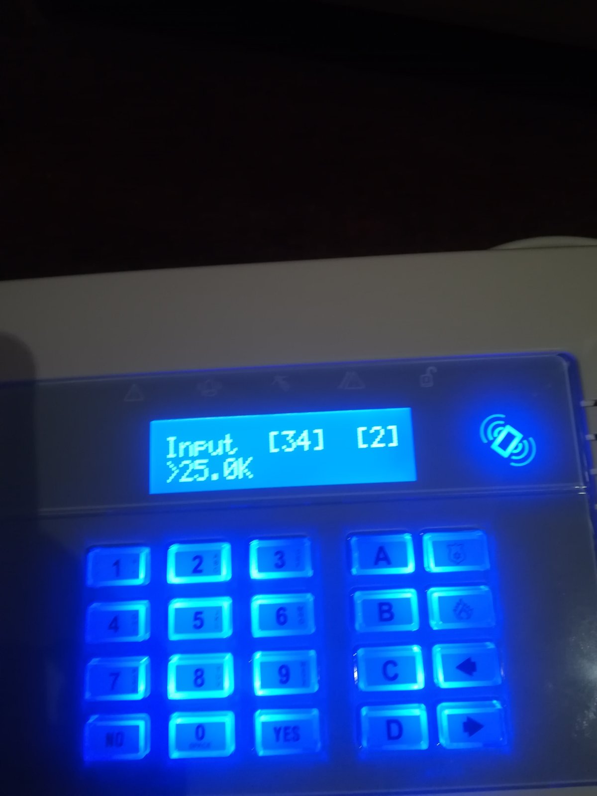

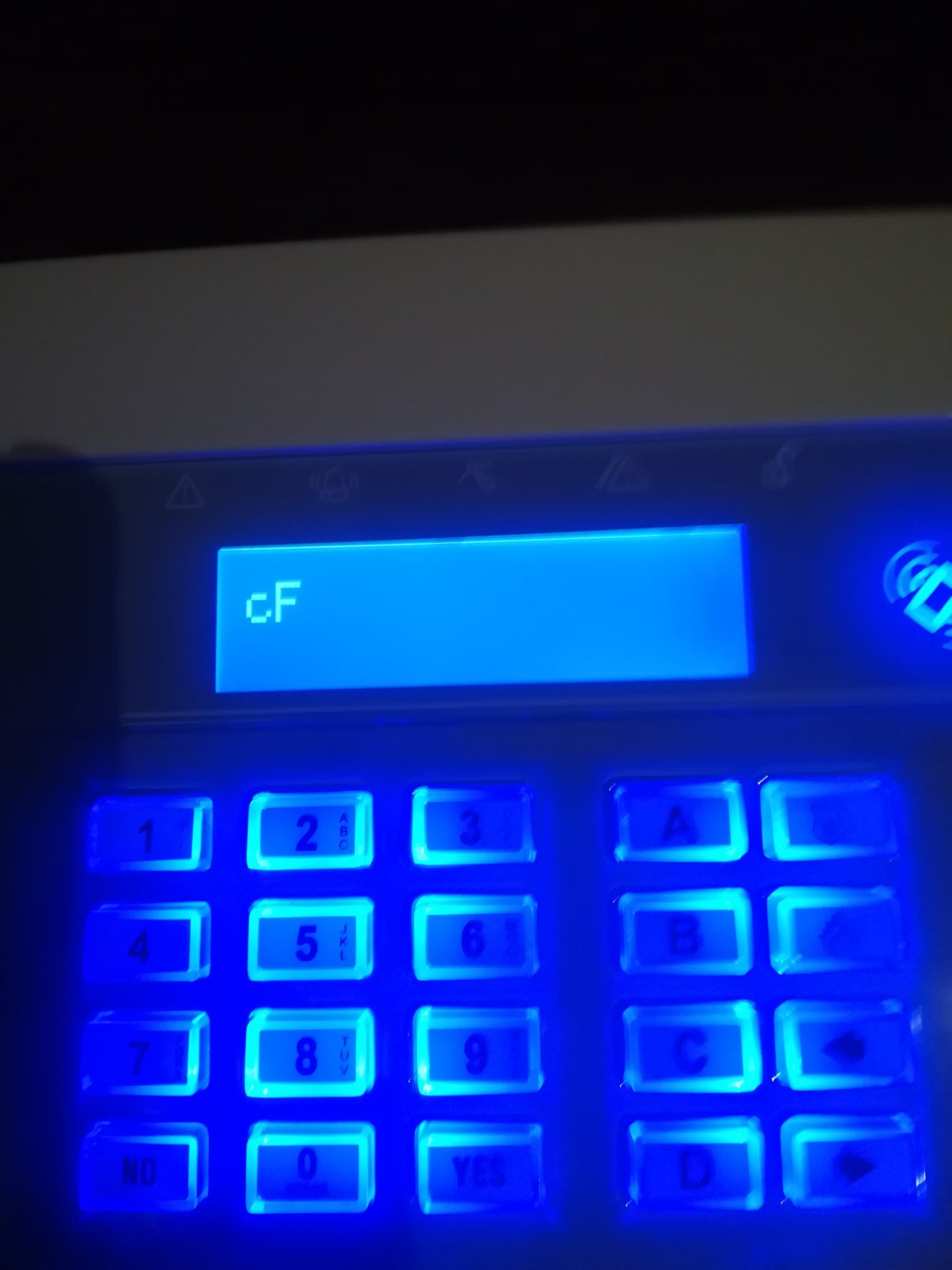

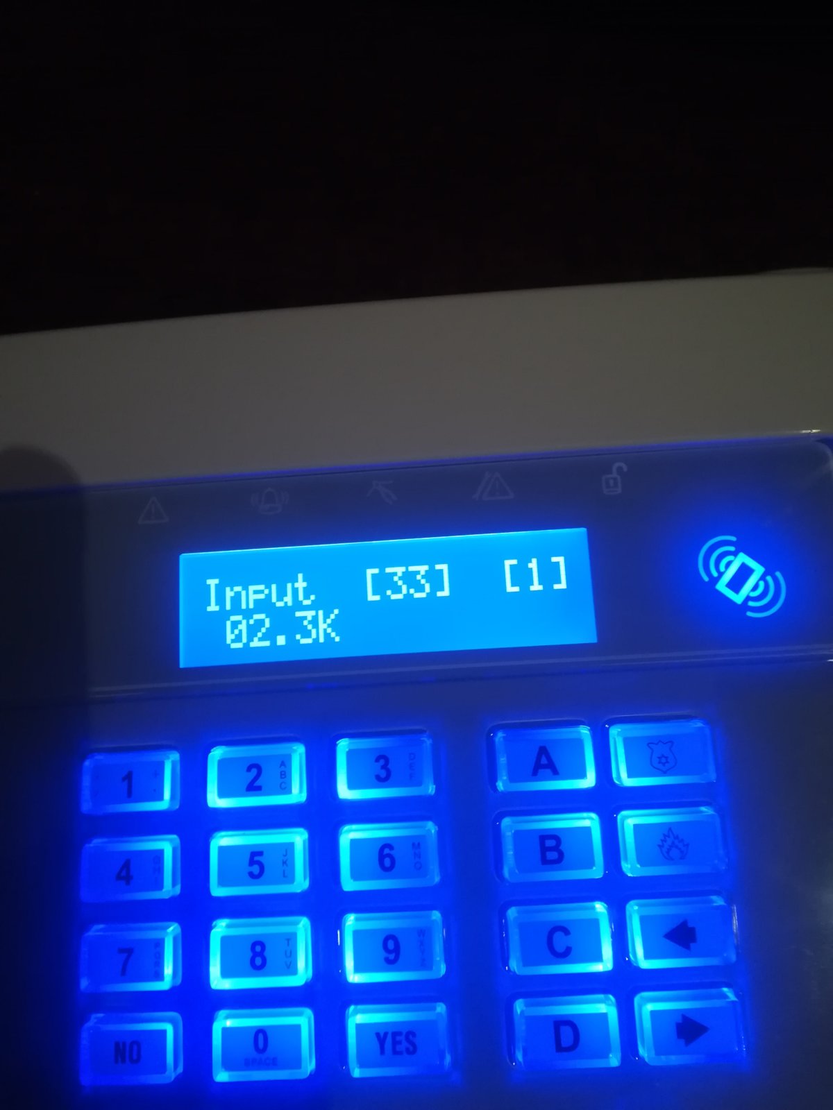

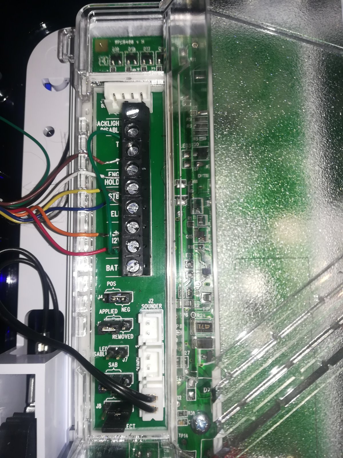

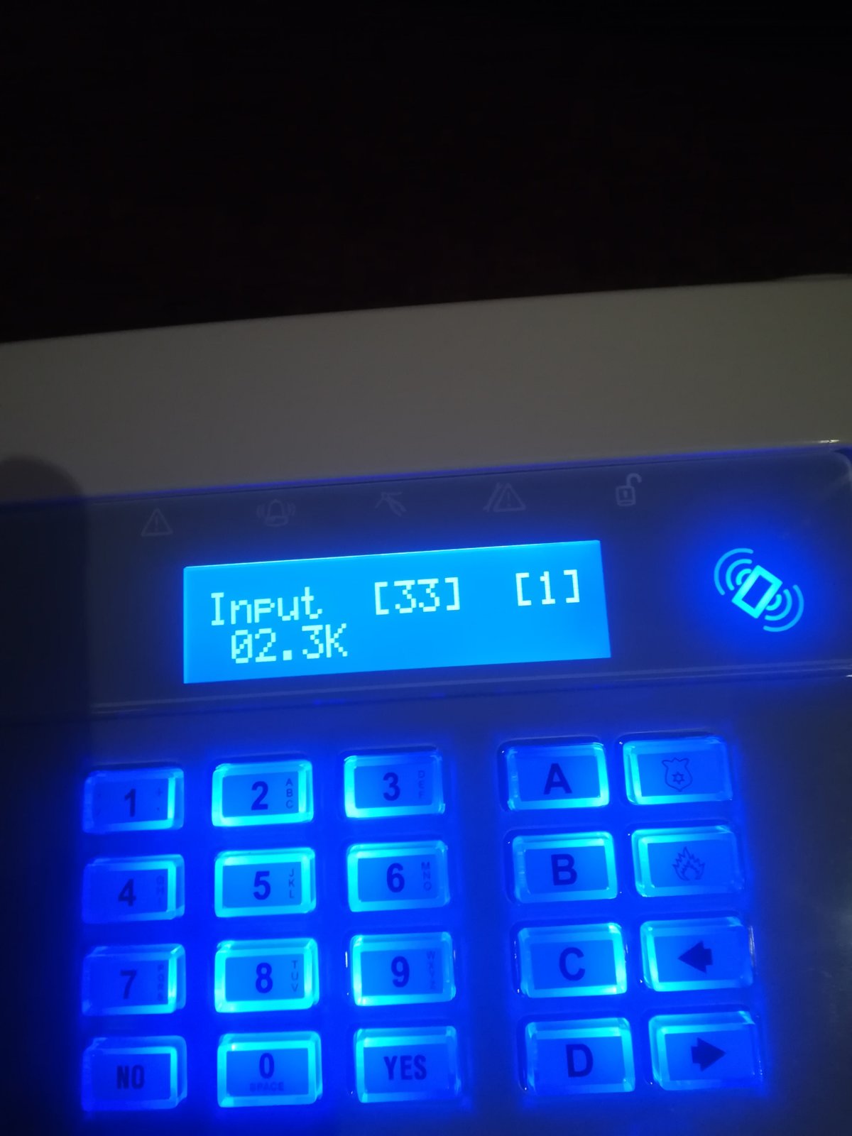

I have another question about the wiring of the deltabell x, which i'm hoping you can help me with.

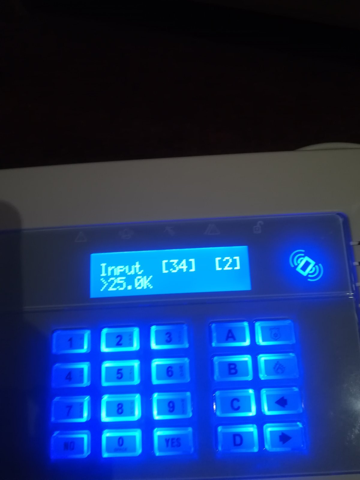

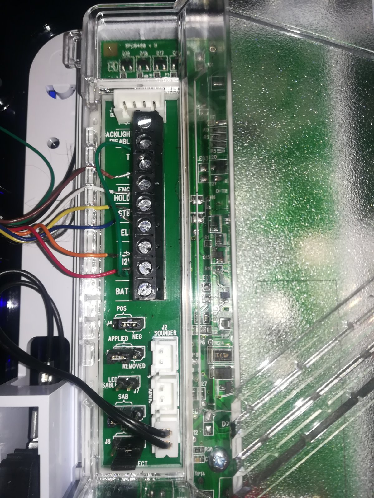

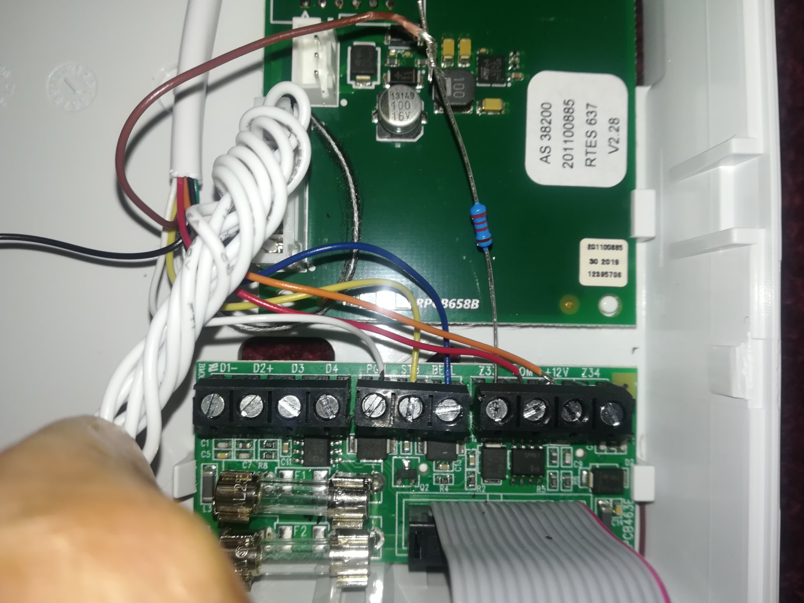

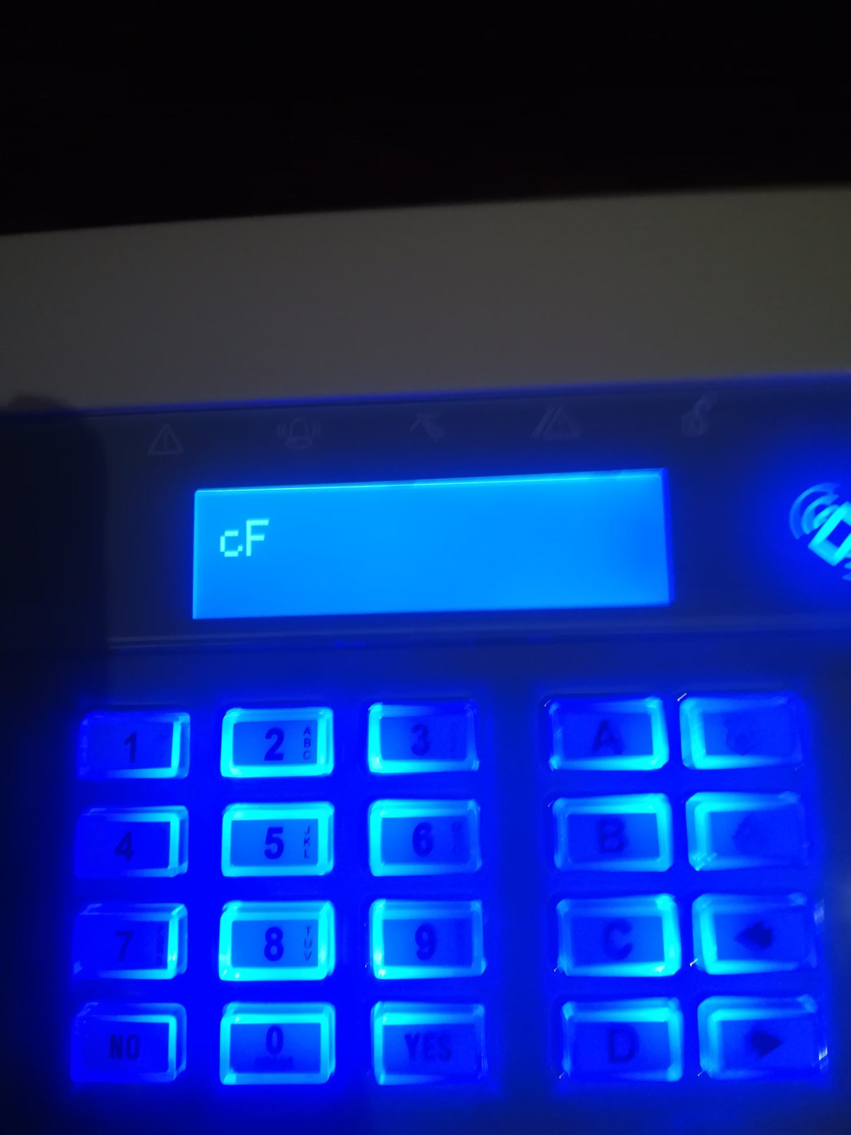

I've copied your (sparky's) suggestion from another post and have wired the delta x to the control panel. see pics. The deltabell blue leds flash continously which i guess means it's working ok. However, when i go into diagnostic to check the wired outputs i get "cF". When i look into each input i get
Input [33] [1] 02.3k
Input [34] [2] >25.0k
I guess 'c' is for tamper which is closed. What is the F for?
Is there a better way to connect the resistor than just twisting the brown cable around one end of it?

F ....fault as you don’t have anything in input 34
Yes ....replace the green link wire in the bellbox with the resistor ....
