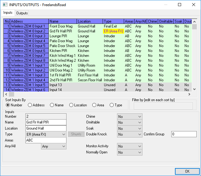

Hi guys, was wandering, need some help please.. have this setup.
A = Full Set, B = Night Set, C = House Parameter
Input 1 / Front Door Mag / A, B, C / 07 Final Exit
Input 2 / Kitchen Window Mag / A, B, C / 06 Intruder
Input 3 / Kitchen PIR / A, B / 06 Intruder
Input 4 / Utility Door Mag 1 / A, B, C / 06 Intruder
Input 5 / Utility Door Mag 2 / A, B, C / 06 Intruder
Input 6 / Lounge Door Mag / A, B, C / 06 Intruder
Input 7 / Lounge PIR, / A, B / 06 Intruder
Input 8 / Ground Hall PIR / A, B, C / (WHERE PANEL IS)
Input 9 / 1st Floor Hall PIR / A / 06 Intruder
Input 10 / 2nd Floor Hall PIR / A / 06 Intruder
now, what do i need to change the ground floor PIR too? is it 09 ER (Part fx), obviously in full set you need to walk through hall to get to panel to disarm, same goes at night when i part set, i will need to go via Ground hall PIR to unset night mode, so will that still be 09 ER (Part FX)?
reason i kept it in for parameter, as i was worried that someone might come down stairs and forget that the parameter is set and they open a door and the alarm goes all off? unless there is a better idea?

If the set up of the hall pir as 09 ER working? Im sure if the entry timer isnt started by a 07 final exit zone first, inputs programed as 09 behave like a normal intruder input 06 when set?
So if you set the alarm and walk in front of a input set as 09 it just triggers the alarm it doesn't start the entry timer.
i haven't programmed it yet (this weekend), so i haven't tried it. what do you think it should be? 07 Final Exit as well? would it work having both the mag and hall PIR as 07 final exit? as the sensor will pick me up once i set the alarm and set the alarm, and then it will go off again once i open/close the front door?
09 is entry route in full set A .....so coming in by the front door ( final exit ) allows you to get to the panel
09 is final exit in all other parts B ,C,D so starts your timer in these settings e.g. A hallway detector at the bottom of your stairs , you set at night , come down in the morning and ....the timer starts
ah ok that makes sense, but how would i assign two different ones? as under input/outputs it only allows you set to set one type for a sensor? as below?
What are you talking about ? ?
That input changes in different settings! As explained above it does it automatically depending on what level you choose when setting
