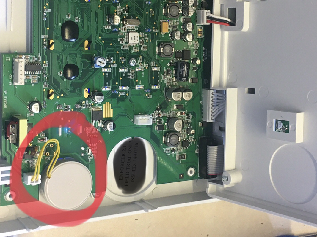

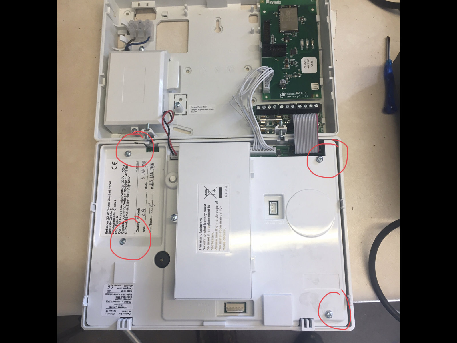

Hi all can anybody help with how to relace an internal piezo unit in the above system. I have managed to source one from the manufacturer, after the volume could not be increased.
Take front off , silence with code , remove the psu plug , remove all the screws holding the backplate on , open up , unplug the piezo , replace , put back together , press yes to reset ...
Hi sparkymarka I am afraid as a pensioner I am not to skilled in what a psu plug is or where it is located I managed the code and opening the unit ok any more on what to do next how to remove psu plug etc
Many thanks

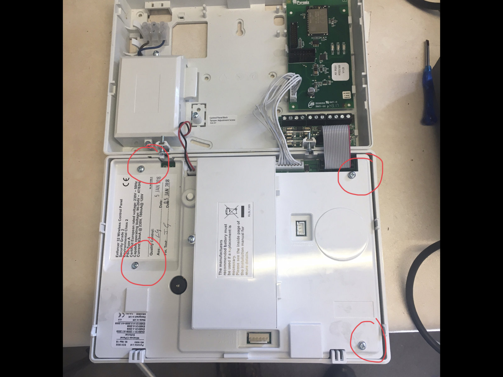

Remove these screws

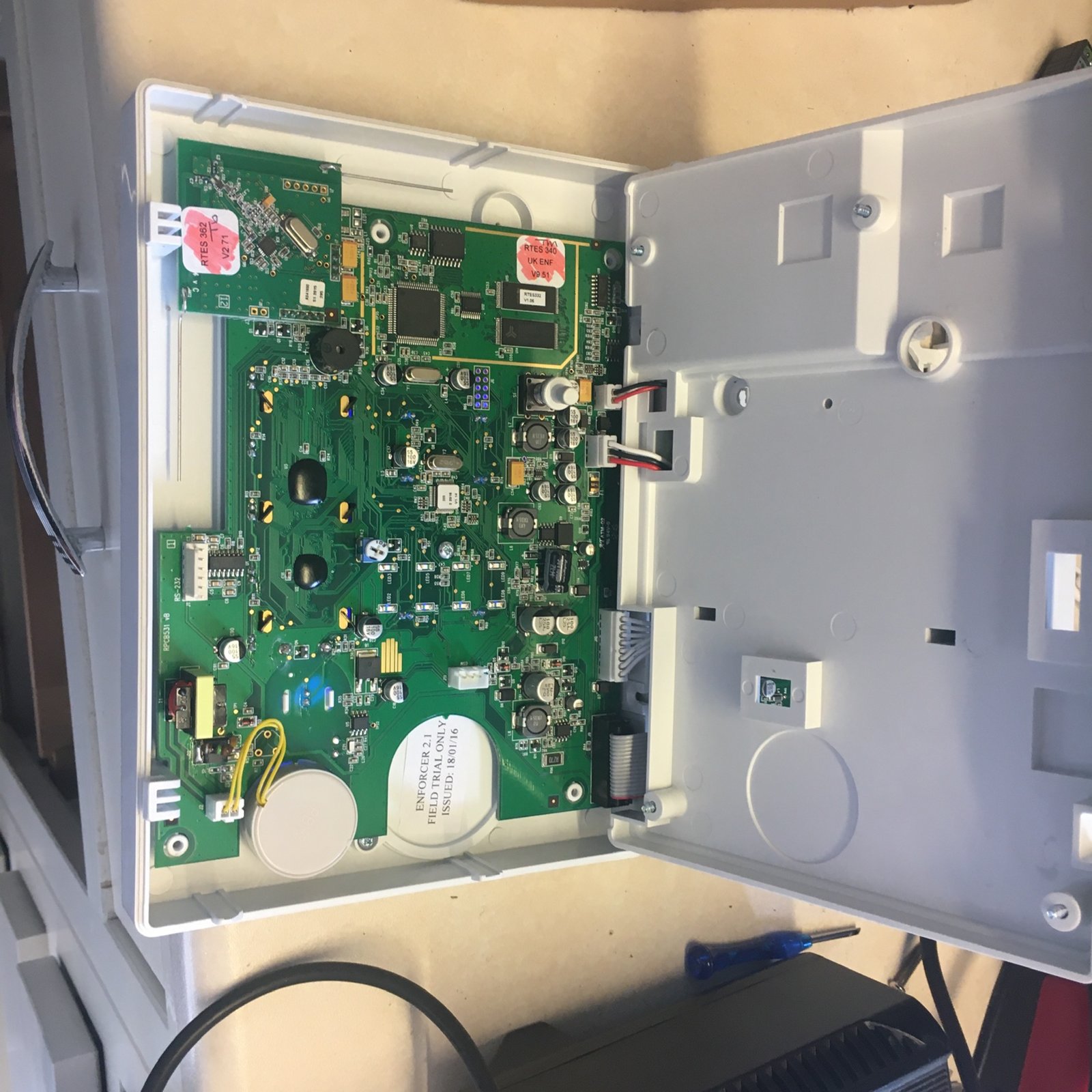

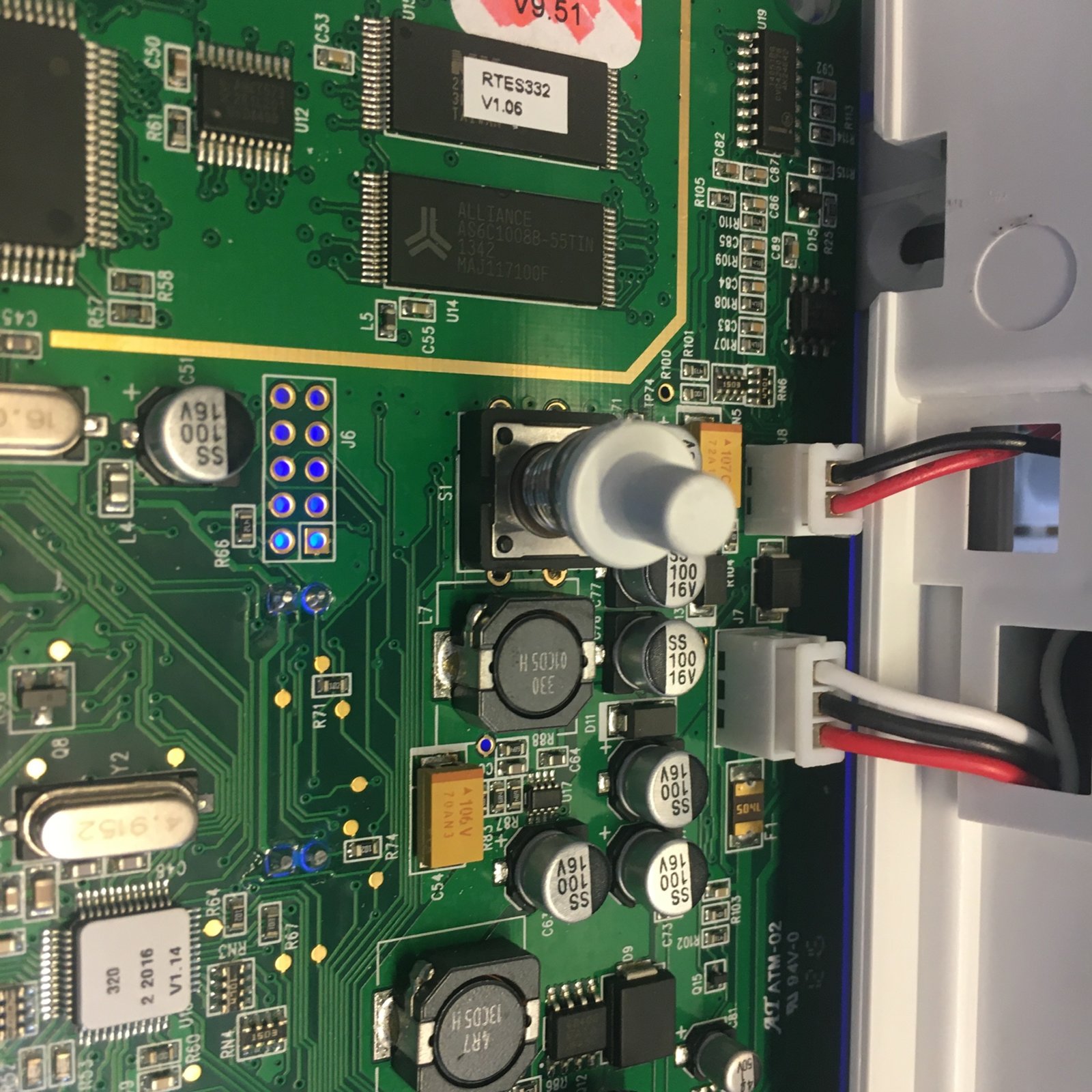

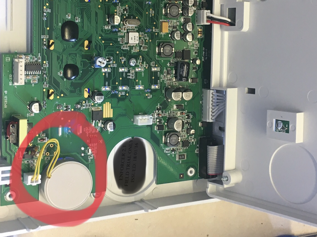

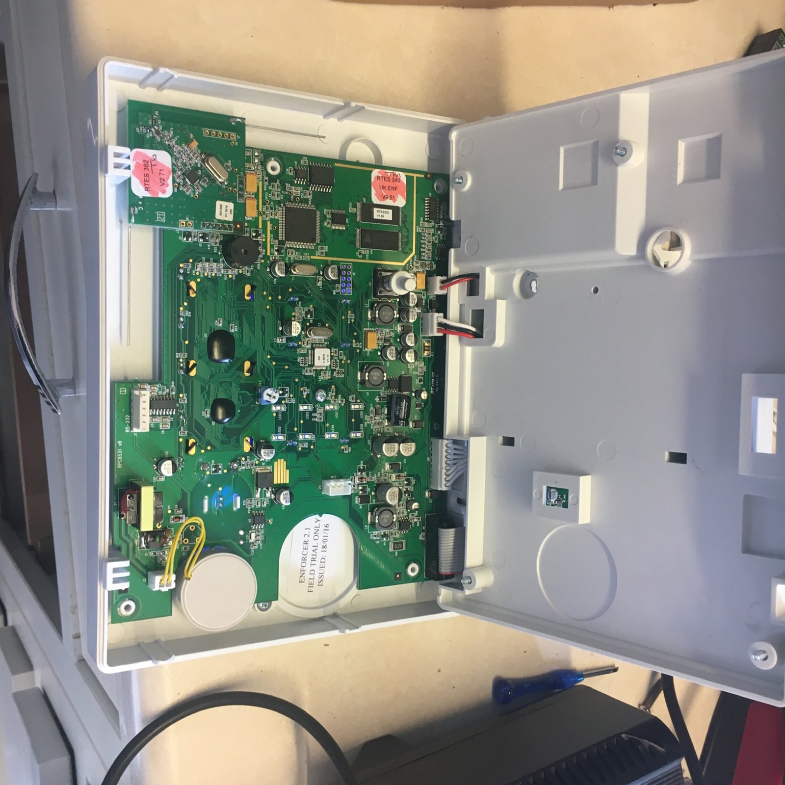

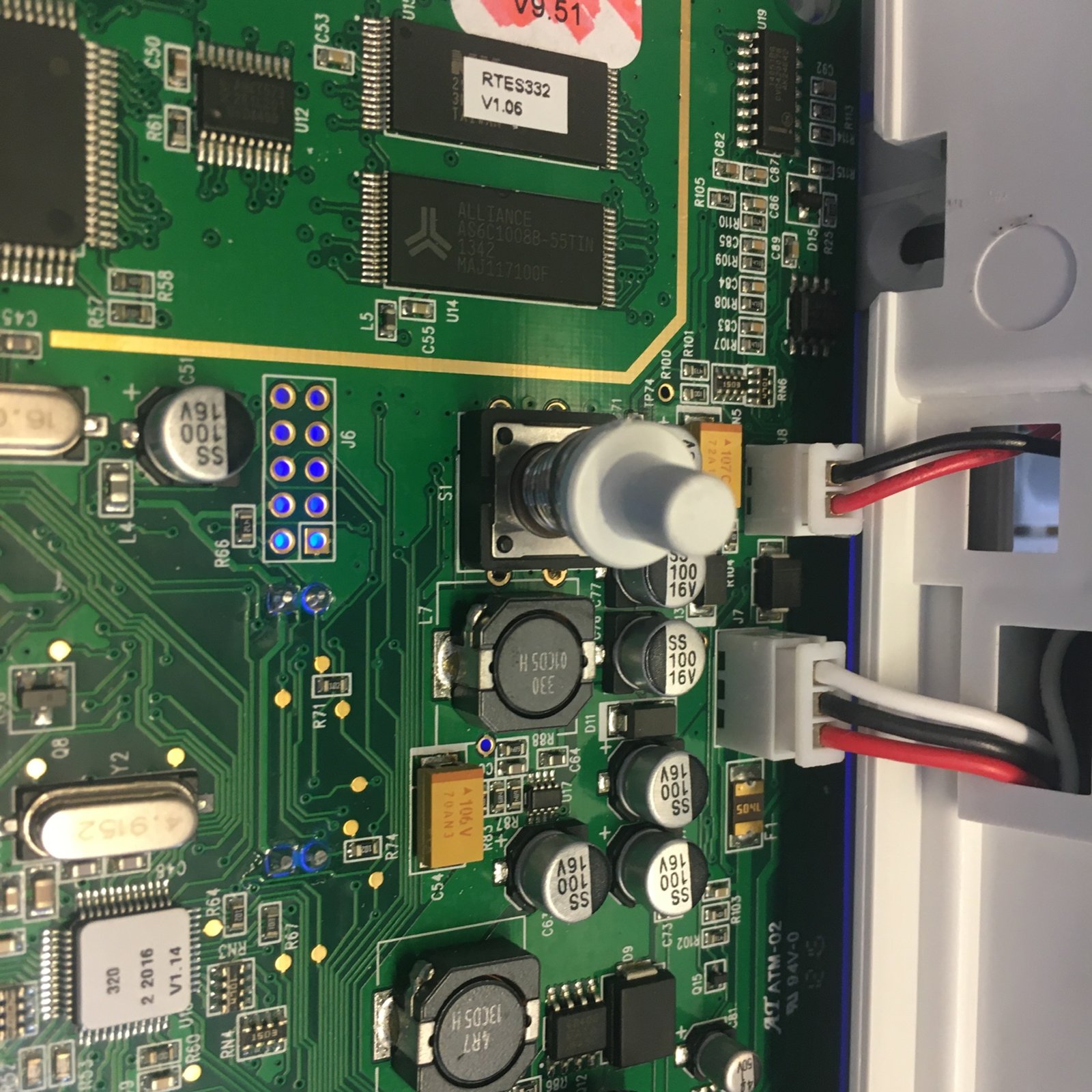

FB981288-DB57-4BB7-8C36-BC5EA2415741.jpeg 733BC135-54C2-4EC5-B754-528A5F20BFC4.jpeg The back should come away without removing any of the connectors , replace the piezo , it just unplugs and pulls out , put back together , making sure the rear tamper plunger goes into the cut out ...
Thank you so so much sparkymarka got it changed and is working fine
