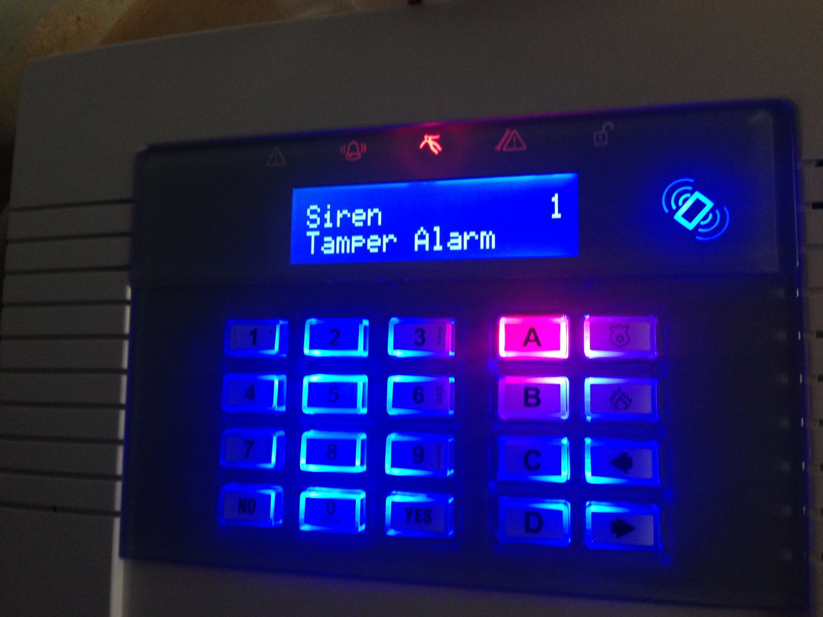

Hi all,
I installed this in 2016 and only recently has the alarm been going off during random hours of the night when set. I have attached a picture to show the issue.
I have tested the signal strength and the signal is very good for all devices paired, I had done a system test and all is coming back normal. When installing the bellbox I did hear the "click" from what I remember.
Any advice please?
Faulty bellbox tamper switch ....I've replaced a couple so far ...check the tamper switch to see if it's a green and black one
Thank you for your reply, I will check on the weekend, do I replace the switch if it is the green and black one.
