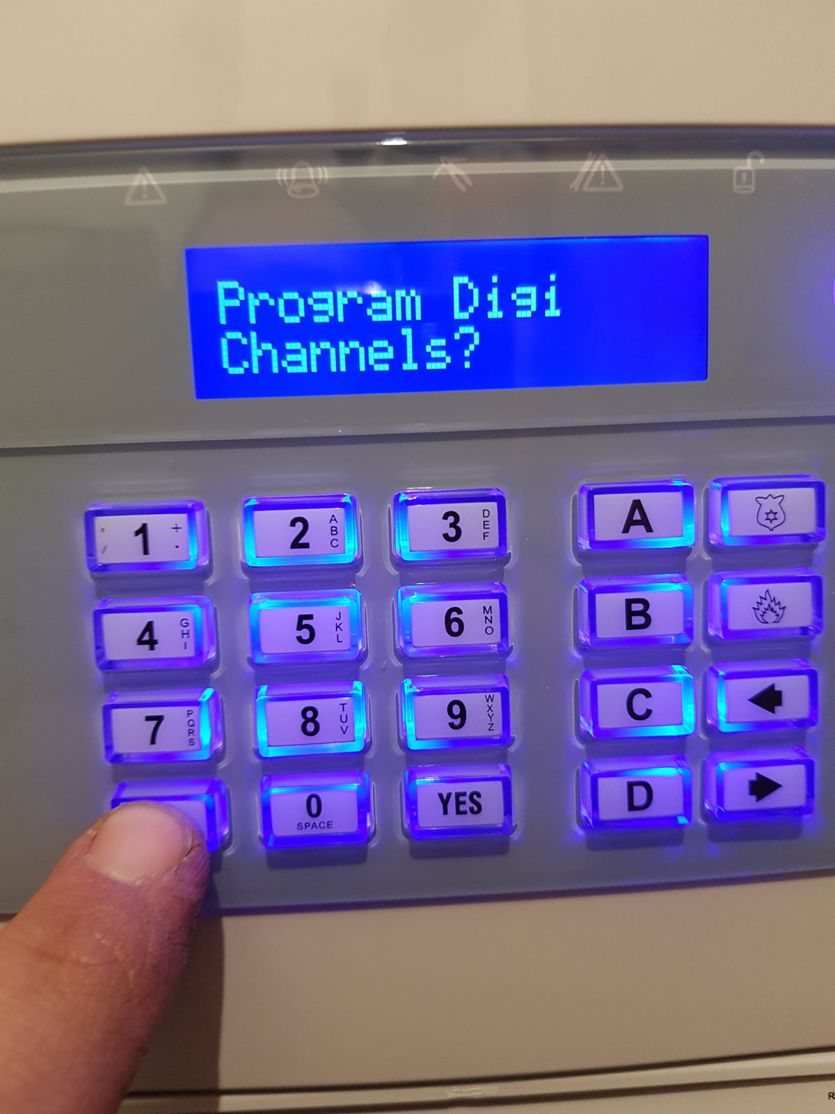

Hi my son fitted a pyronix enforcer v10 can't find any Wi-Fi settings on it to connect to the Wi-Fi could it be a SIM card type how can I tell
Also we are installing it our selfs were do I get engineer codes from thanks
There is nothing for set up app or wifi the onkybthing I can find is sms phonebook

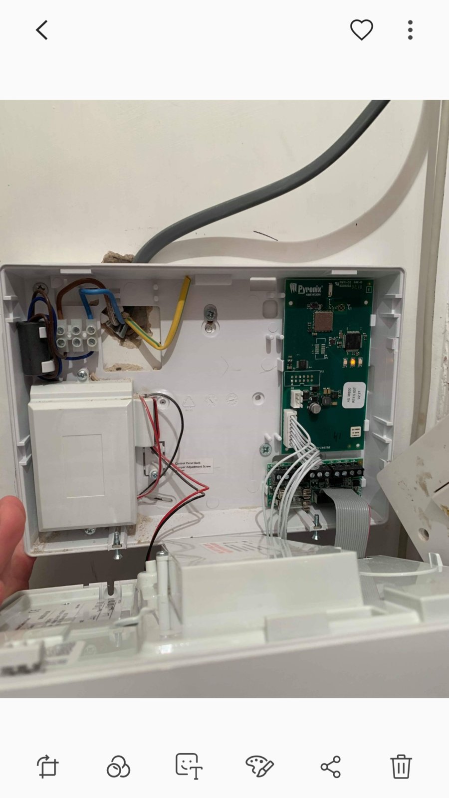

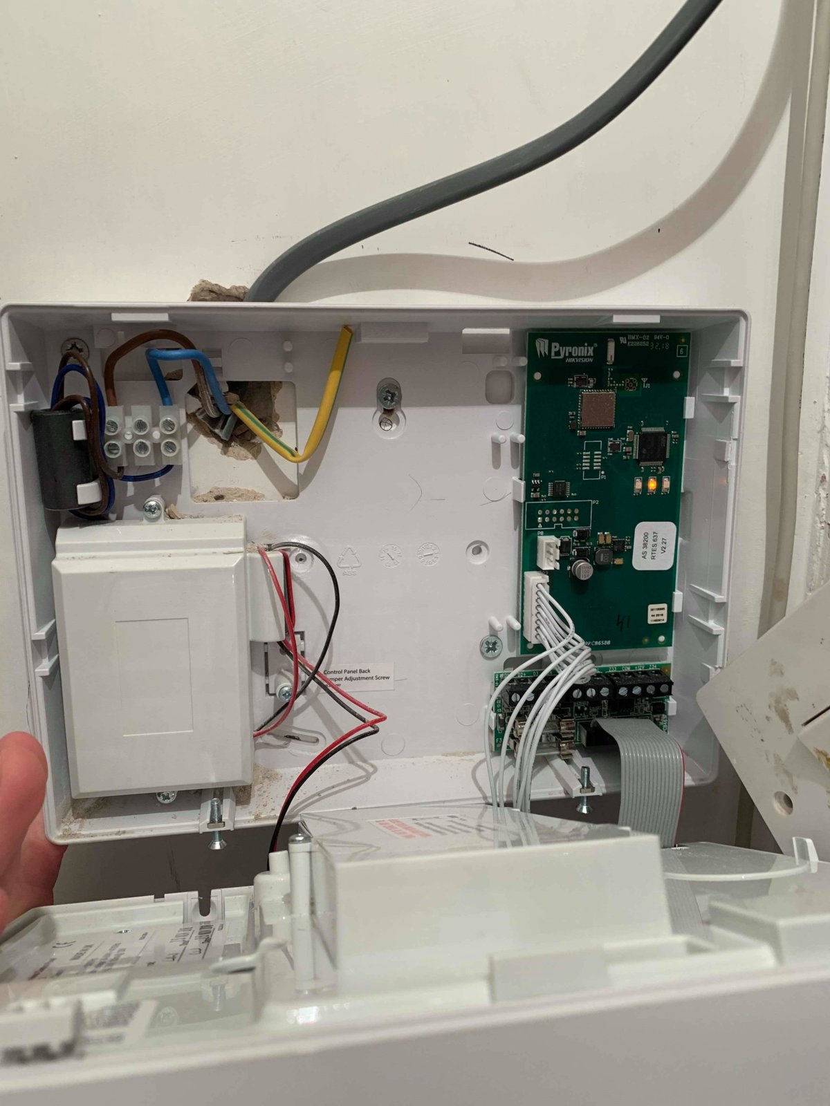

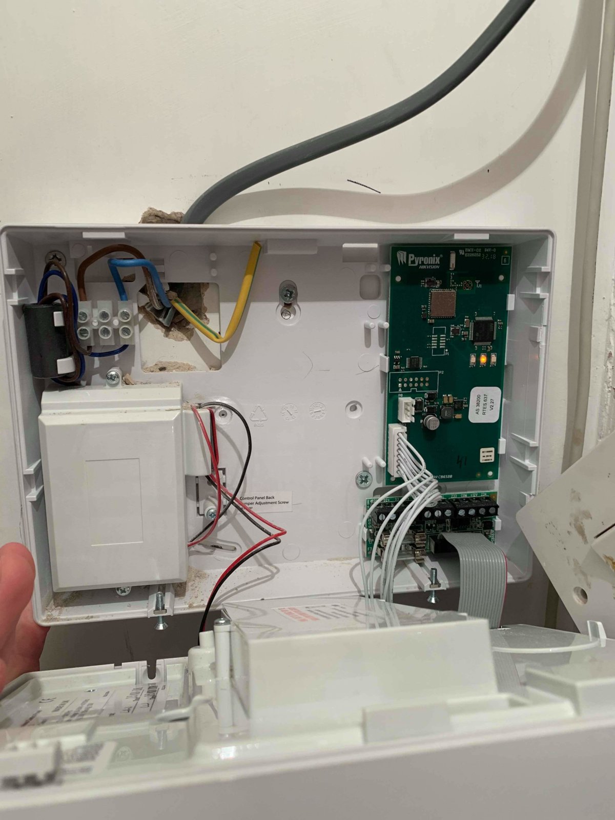

Is the WiFi card plugged on ? If not down power inc battery connect it then re power ...or screen snot of module inside of panel and post it

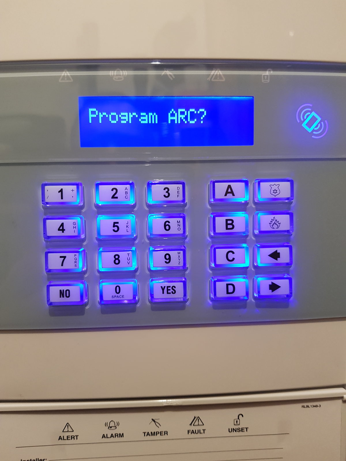

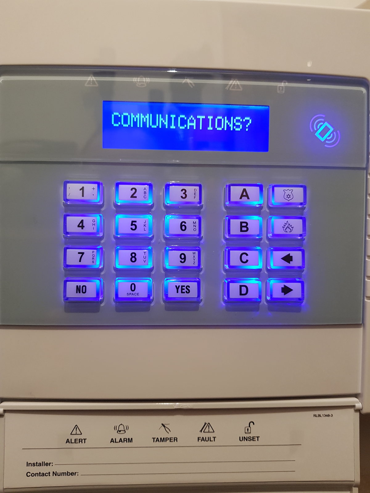

Its is a wifi module, like what has been said if nothing is shows up in the communications menu you will need to fully down power the panel.
You need to go into engineering mode
Down to communications
Set up Wi-Fi
The system ID is in set up app in the communications menu.
