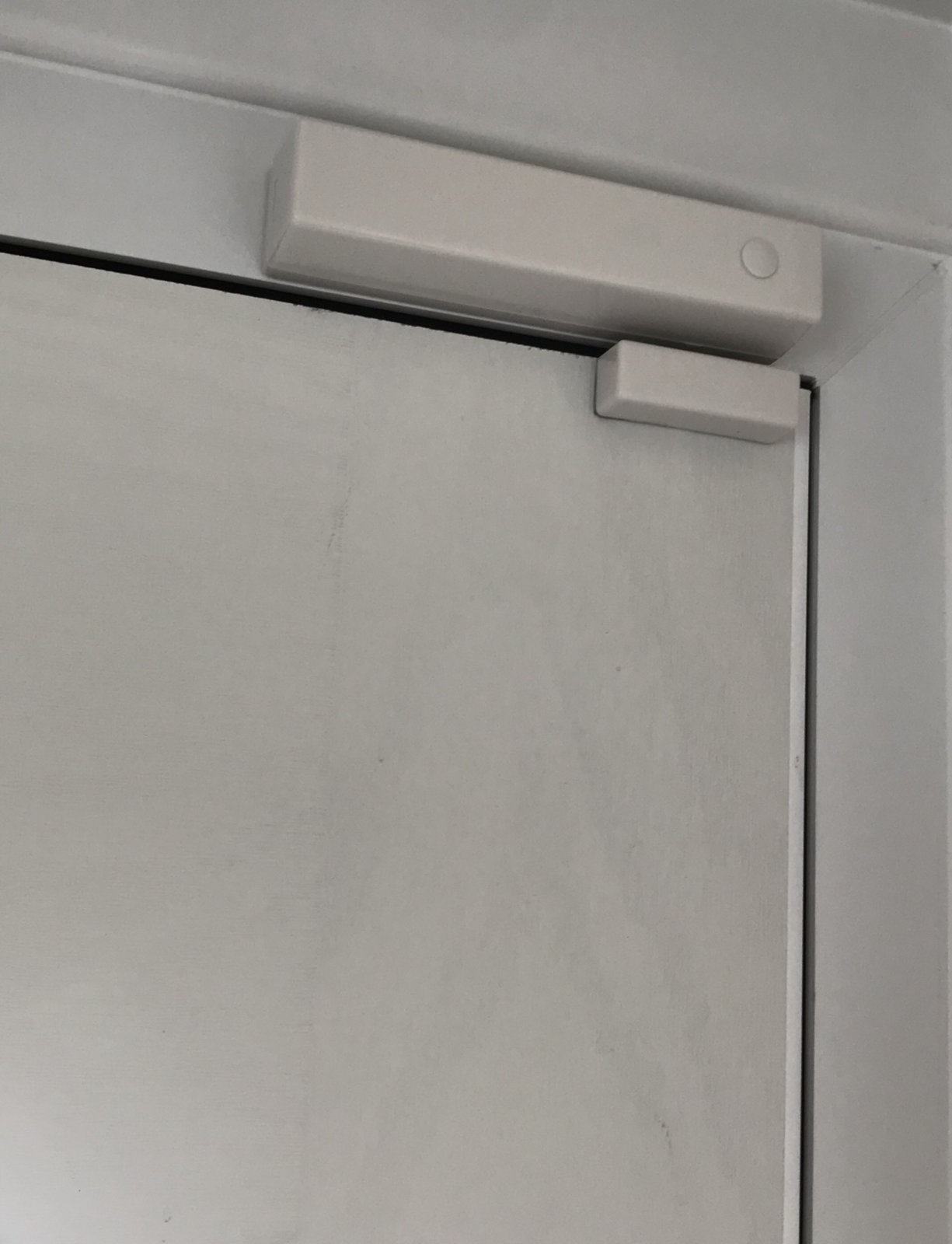

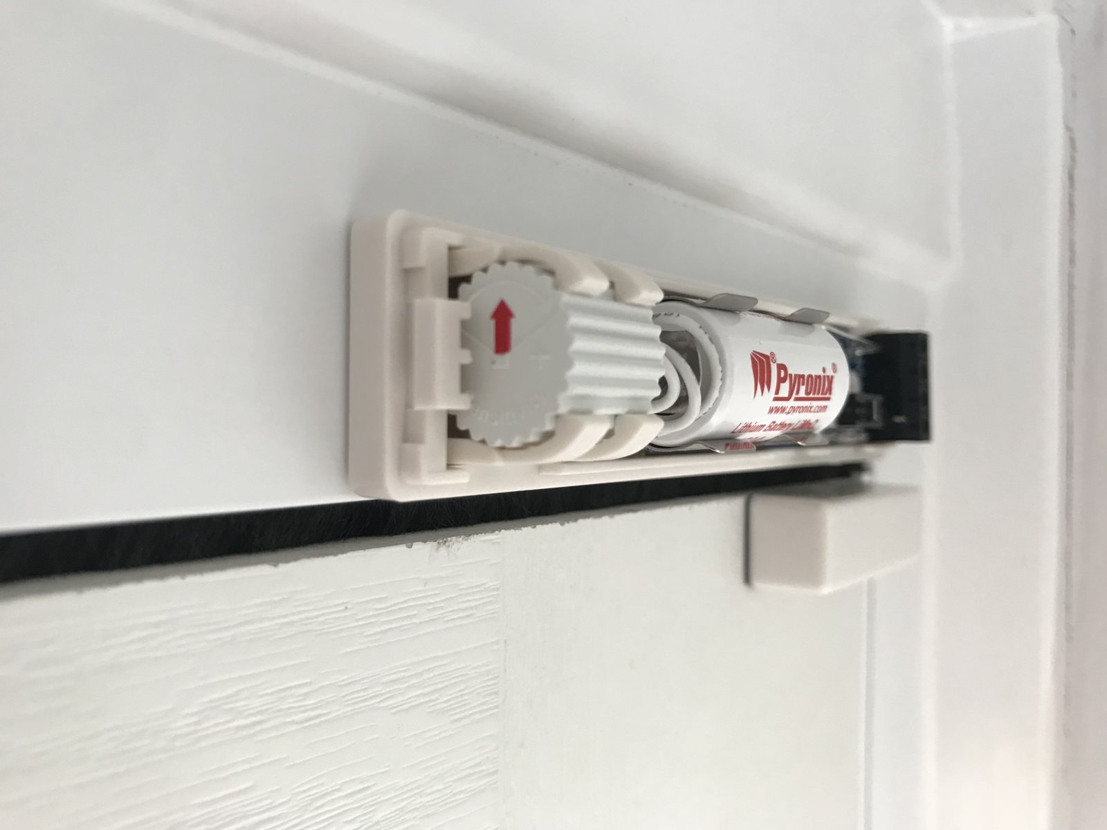

2) In the hope that shock sensors may deter an intruder before breaks in occur I installed contact and shock sensors (Shock-we) on all my doors and some windows. I’m wondering how the front doors shock sensor should be set up to achieve this. All my sensors are set to 06 Intruder except for the front door contact and shock 07 Final exit and hall PIR 09 ER. In this configuration the shock sensor on the front door does not trigger alarm because of entry timer. If I change it to 06 the alarm is triggered when I open the front door and it is too late to unset it. Should I adjust sensor sensitivity and leave it at 06 or maybe it should be configured in a different way? I could use a keyfob to unset the alarm before I open the front door but this is not an ideal workaround.

Regarding the shock detector what I meant is that opening door is enough for sensor to detect vibrations hence triggering alarm. Should I set it to 06 anyway and try to calibrate sensitivity or is there any other more appropriate setting for this sensor?
Is the internal shock sensor the correct way depending on mounting location ?
Post picture of shock on door and inside of unit
Yes arrow pointing to the sky. I can post pictures in the evening. So as far setting is concern it should be set to 06?

34A271AC-98DF-4C32-A41C-845E0DEE10A9.jpeg 8E93A4E3-5030-4DA9-BE34-9CEA3D1C4DED.jpeg 6B74CE32-25BA-4AF9-AC85-E815E747340C.jpeg
As promised I attach the photos, however while taking the photos I decided to recalibrate the sensor and retest. That did a trick and it now works as expected with sensor set to 06.
