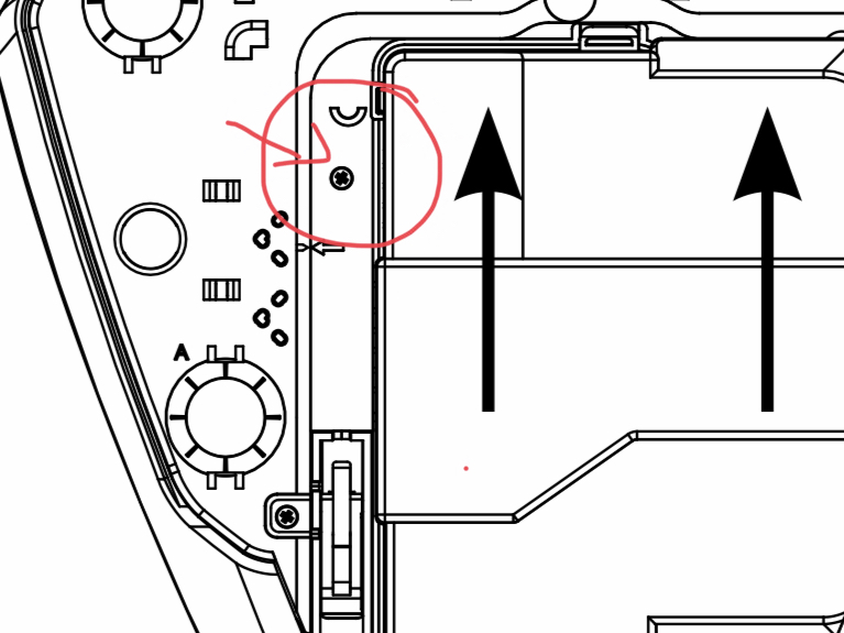

I managed to get to the box, and remove the PCB board (it is designed to lift off) and it is the Twin Pack - BATT-ES1 type. Going to order a set now.
Only issue. When I re-connect the the battery on the ground, the tamper will sound. Is there a mode to put the device in so it does not sound, until I am finished putting everything back?

I take it the pcb retaining screw wasn’t fitted ...and why would you take it out to replace the plug in battery pack ?
There isnt a screw. The PCB is housed in a plastic casing which slides into the main housing.
Because
You can lift the PCB up and out of the housing fairly easy if want to replace on the ground
There you have it. Glad I didn't pay this company ridiculous amount to come and maintain it under a minimum 4 year contract,i they have missed out screws during installation. One of the larger ones too.
No it’s just a small screw to stop the pcb moving up and causing a tamper fault
