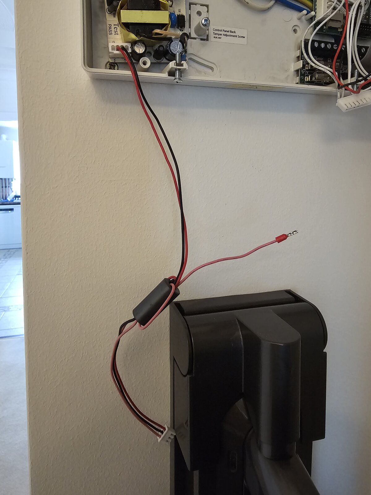

I am upgrading my Enforcer from V9.51 to V11 using the Pyronix Enforcer V11 upgrade kit, which comes with a new PCB and associated kit in the box.
I notice that a new power cable that goes from the PSU to the front panel is included in the box, and this has an additional flylead on it.
I have attached a picture showing the cable connected to the PSU, with the 3-pin block on the other end going to the front panel; unsure of the pink flylead and where it needs to go.
I can't seem to find where this additional flylead is supposed to be connected - the documentation doesn't mention this flylead from what I can tell.
Can anybody assist with this please?

Pyronix confirmed that this lead is to be connected to Earth, just in case anyone wondered!
