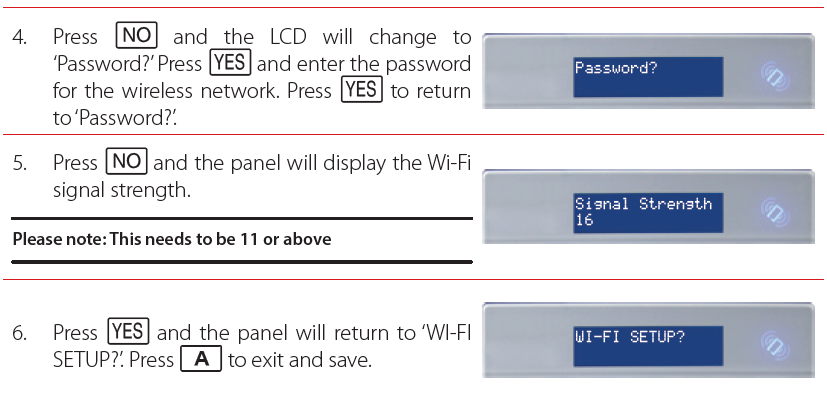

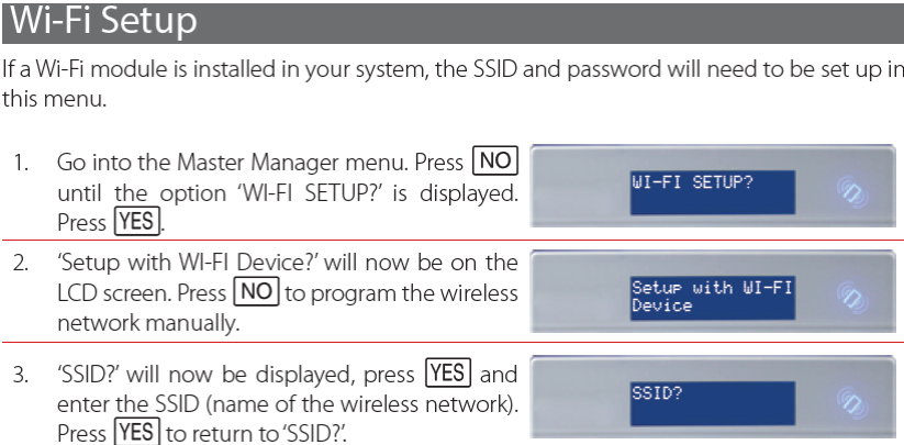

if you need to check this may help
no but you can see how the wifi is performing when connected ? had a few reactivations, some been off for over 6 months and changed routers only to find subscription has expired a few months ago.
