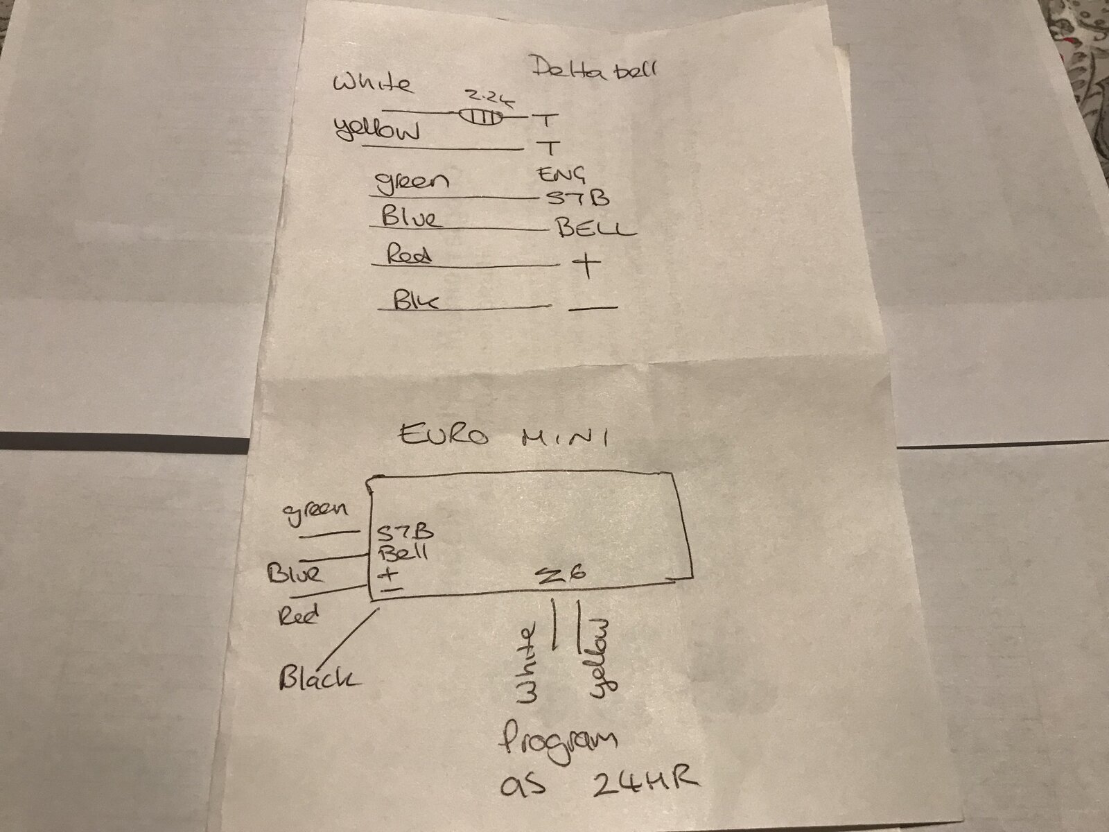

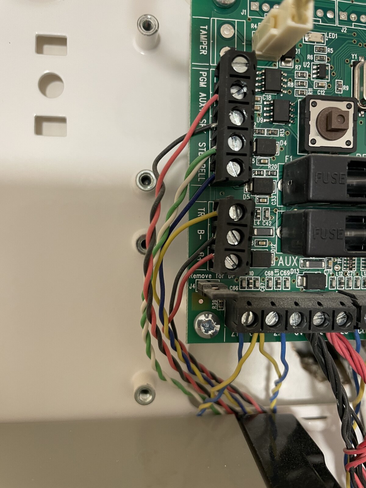

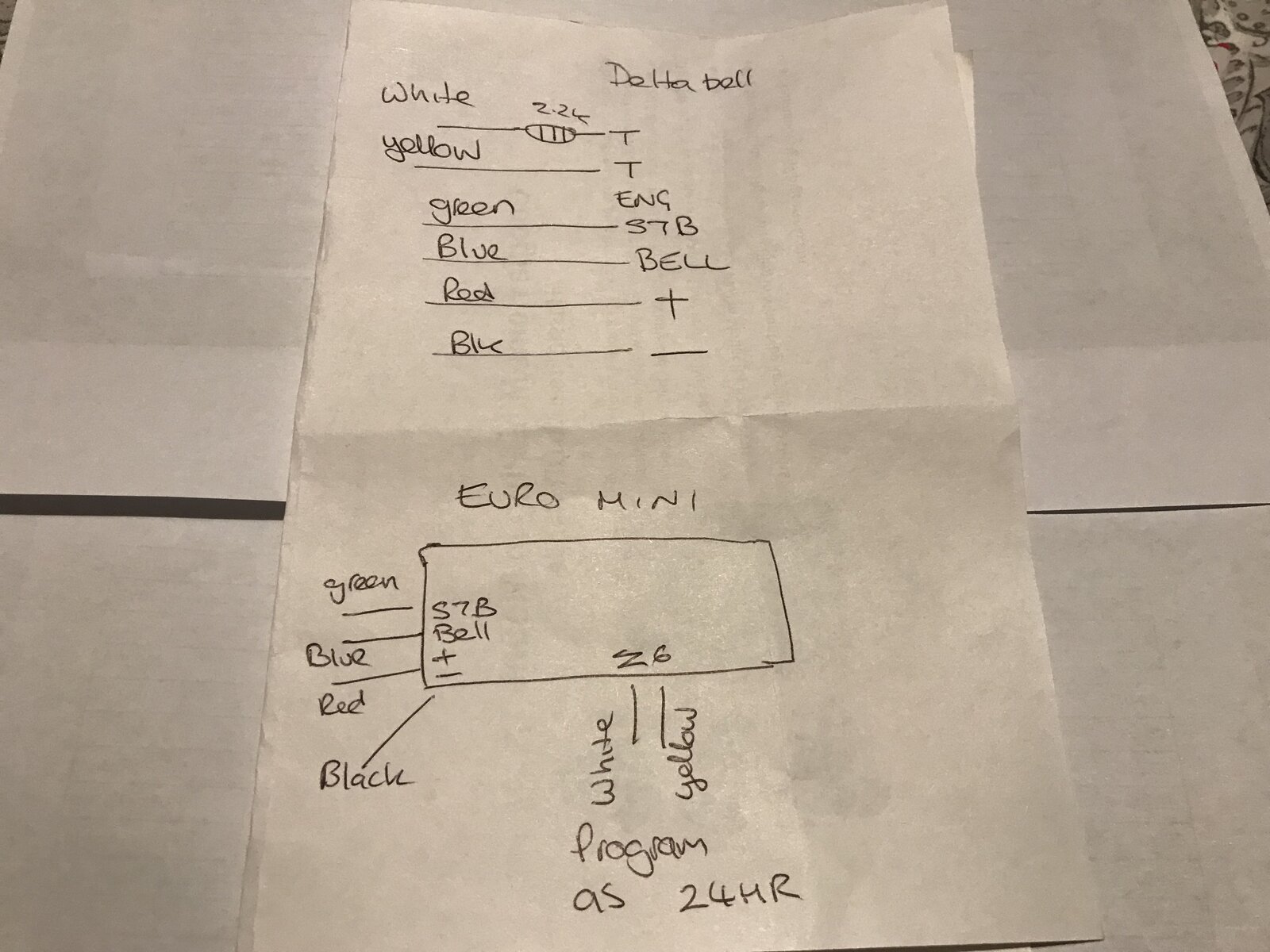

View attachment 251988 You could power the bell from the aux terminals if there isn’t that many pirs on the system the bell output is 800ma the delta plus is 300 ma in alarm x 2 =600ma

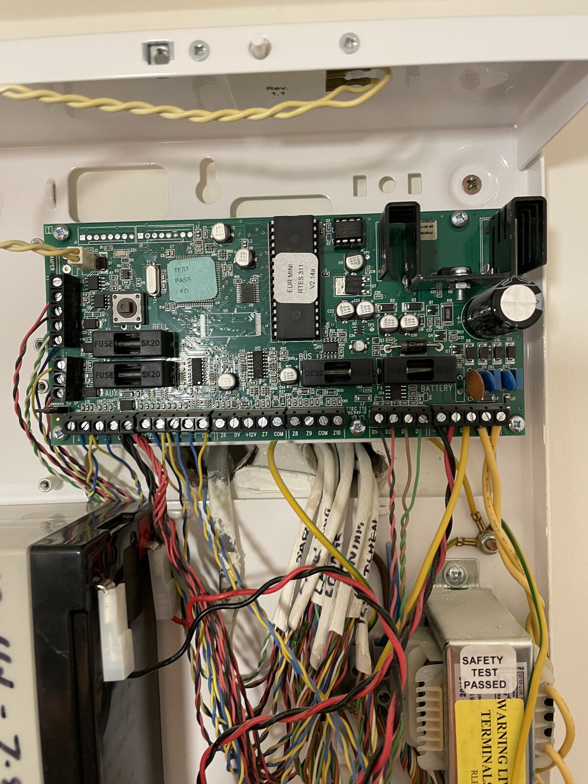

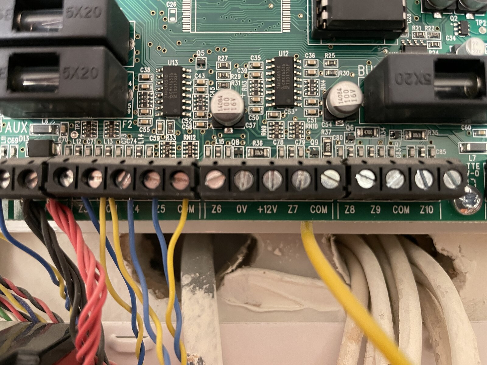

Ok I have attached a couple of pictures of my control panel, and as you suggested z6 is available so happy days. You said program this to 24hours is that correct.
