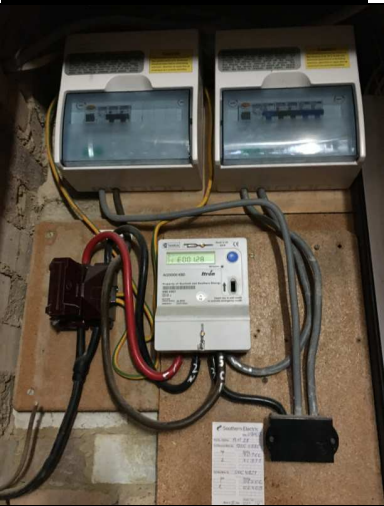

Looking for some guidance here
The left hand side fuse box in the pic only have 2 fuses which are used for economy 7 storage heaters, rest of the fuses are in the right hand side fuse box. bot the fuse box serves same property, I am applying for EICR and there is one question in the checklist where it assumes that the EICR is for 1 fuse board. what will above be considered as ?
thank you for the guidance in advance.
You will have one EICR for the whole property. The EICR will have a number of sheets, for a property with one consumer unit (CU) there will be one sheet that has the circuit designations and test results for the circuits on that one CU. As you have two CUs, you should have two circuit details sheet, one for each consumer unit.

The E7 CU will not be live during the day time. I hope that is understood and test will still be carried out?
All testing can be done with no power and "live results" calculated, I prefer a good live test myself but you've got to do what you've got to do.

Could you post a photo showing the circuit breakers with the front cover open?
this is BTL property that we recently bought and we need to get the EICR done before we rent it out hence i need EICR.

When an EICR is ordered / agreed with a competent person the scope and limitations need to be agreed before it starts.
Unless you are happy to pay a night rate for the spark to test during the E7 hours you’ll need to agree that dead tests will only be completed on the E7 board. This board will not have the Ze confirmed either
