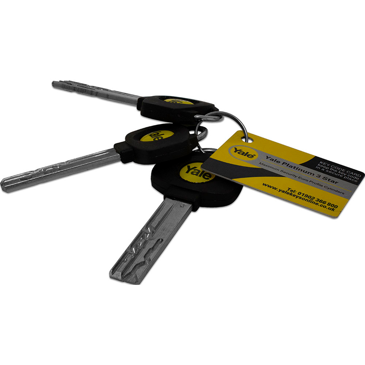

Recently fitted a replacement euro cylinder for someone, key design as per image below (not my keys.) First time I've had experience of this key type. You need to be very precise to get it inserted, even when it's the right way up you sometimes think it isn't. The person using the key is elderly and finding it a bit difficult.
The keys are chamfered on the longer flat edges however the end profile of the key is nearly completely squared off and I reckon this isn't helping matters.

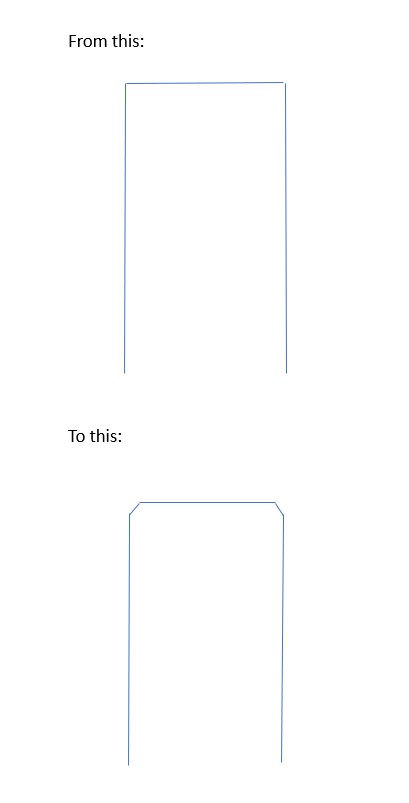

Could I chamfer a little bit from each of the short edges with a view to aiding insertion, or will this likely render the key useless? See below.
I'm sorry, I can't say if a chamfer will impair functionality.

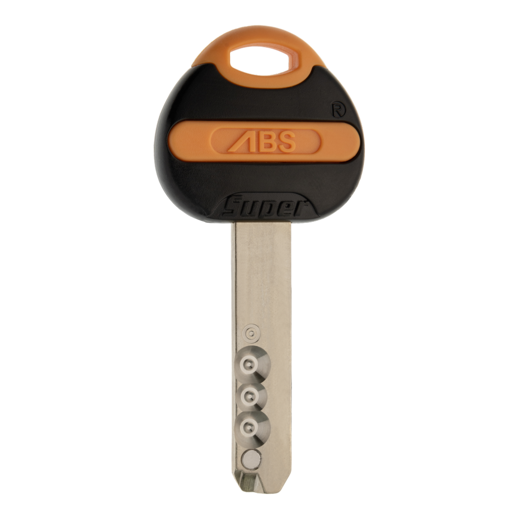

But I can say that I have a similarly styled ABS Avocet keyset, that does have a small chamfer and we've never had issues with it - the chamfer does help.
Ask Yale or a professional locksmiths... but I see no real reason why not. (Nor do I think it will help. personally).

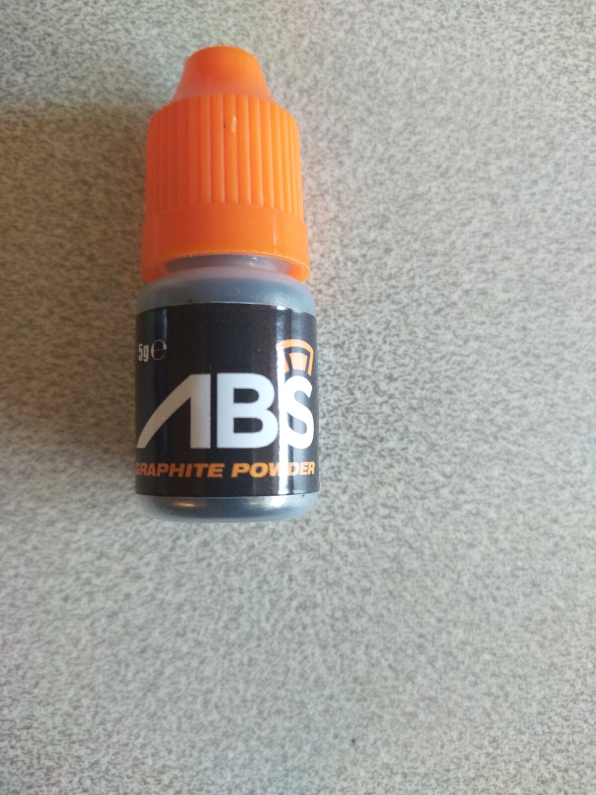

A touch of graphite in the lock and onto the key(s) may help lubricate the mechanism / shutter if that's the problem.
All my external doors have ABS locks and I swear by them.
Once fitted, I put a bit of graphite on the keys and operate the locks a few times.
Then once in a while, I will repeat this.
They are as sweet as a nut.

I'm going to try the graphite, cheers.
I have the same Yale keys, and suffer the same problem. As I got 6 keys with each lock, I may try grinding a bit off 1 key to see what happens.
Try the graphite first as suggested here, might be the solution rather than grinding bits off!

Hi. I would give the keys a gentle once over with very very fine sandpaper or fine steelwool to deburr the rough cut edges of keys. A quick swipe will do. Clean keys with cloth after. Invest in a can of graphite lock lubricant as some others here have recommended. Never use wd40 or anything but lock lube in cylinders. I stopped supplying dimple key cylinders on doors to the elderly- they often really struggle with using them even after months regardless of how rough or smooth the key fits. You’d be doing them a massive favour by swapping theirs with a decent anti snap normal key cylinder - they’ll sing your praises for going the extra mile for them - best publicity for business
Mine catches in the first 1/2-1mm of the tip of the key catching on the very front of the profile if it's not bang on straight. It doesn't even touch or get past the shutter so I doubt lubricating behind that will help a great deal.
You won't know if you don't try. Use a soft graphite pencil on the key if you don't want to get graphite powder (but that has other uses - e.g. on padlocks). Also try the angled attack Mottie mentioned.
