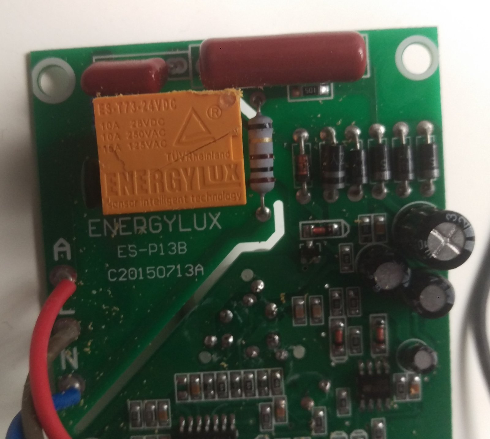

The model number of my relay is "ES-T73-24VDC" and the closet match I could find online was the T73 series from Tyco Electronics. All I know is that it has a rating of 10A 28VDC / 250VAC and 15A 125VAC as shown in the photo below:
Since I couldn't find a SSR of similar specification and realising that a SSR would cost more than the motion sensor itself I decided to simply remove the plastic casing entirely and muffle the sound the best I could.

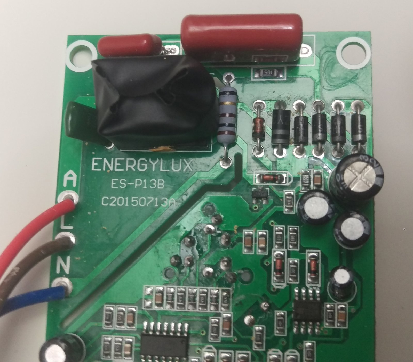

After placing some insulating tape between the coil and armature, top contact and armature and finally wrapping the whole thing in insulating tape I managed to dampen it enough not to annoy me.
