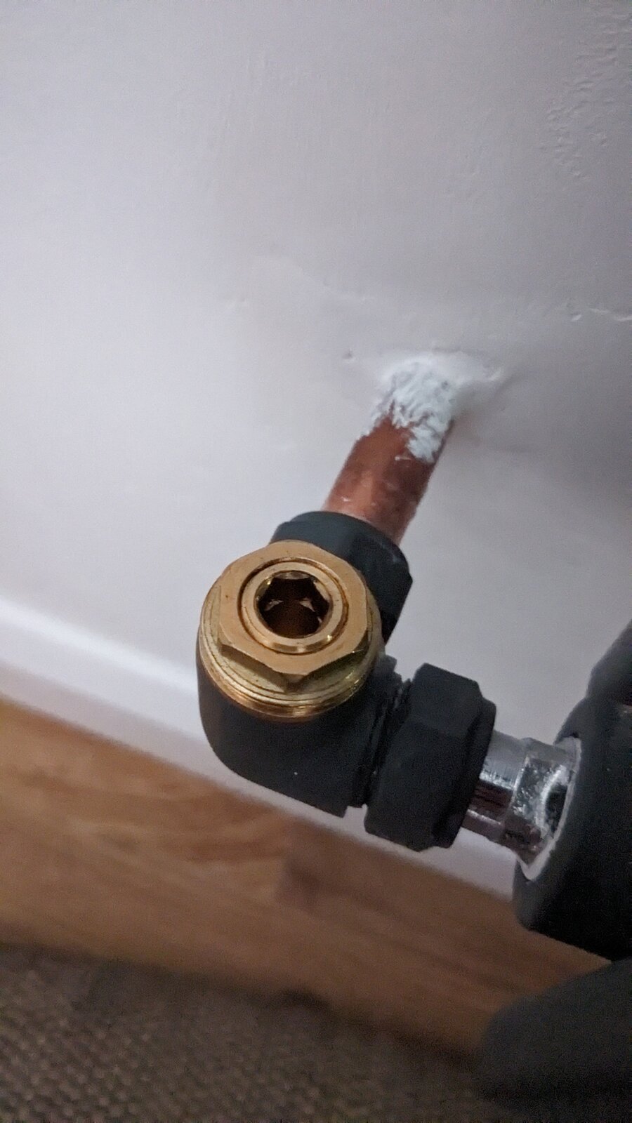

All valves are open everywhere, but not sure about the column one as its lockshield looks like one in the pic and dont know how to turn it ;) The guy who installed it says it is ON, although id like to see it myself ;)

It's an allan key that you'd use to turn the centre grub screw.
If that is the actual valve then it certainly looks fully open (up). Now it's time to turn another rad off and wait a little and see if it gets warmer and keep doing that till hopefully it does. The column will take a little time to react so that's why to wait some time till another one is turned off.

Yes it is the actual lockshield on the column rad.
