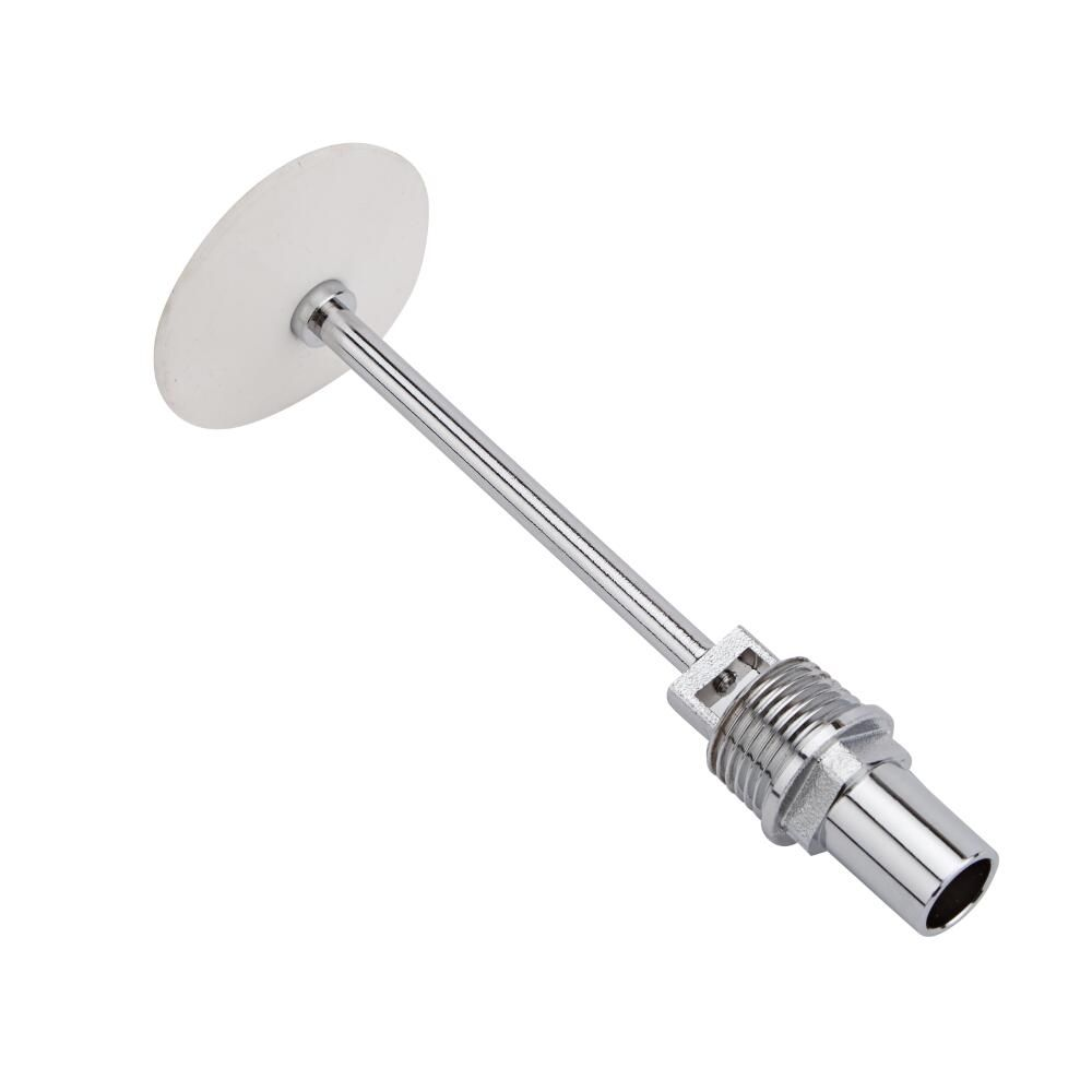

You should check for a internal baffle, you will have to drain down the rad and stick a bit of wire or a small dia rod into the flow and return ports, if a internal baffle is fitted it will be in ~ 100mm from one end, that is where the flow (hot) pipe must be connected. If no baffle fitted shine a light at one end and you should be able to sight it from the other. (do this first)
You can buy a baffle like this which will help to give a faster warm up IMO.

I would be inclined to take a refund and source a rad that you know has a baffle(S), (you won't be able to check it as I suggested due to the double panels), the only problem is, the hanging brackets are not universal so will probably entail drilling more holes/more expense.
