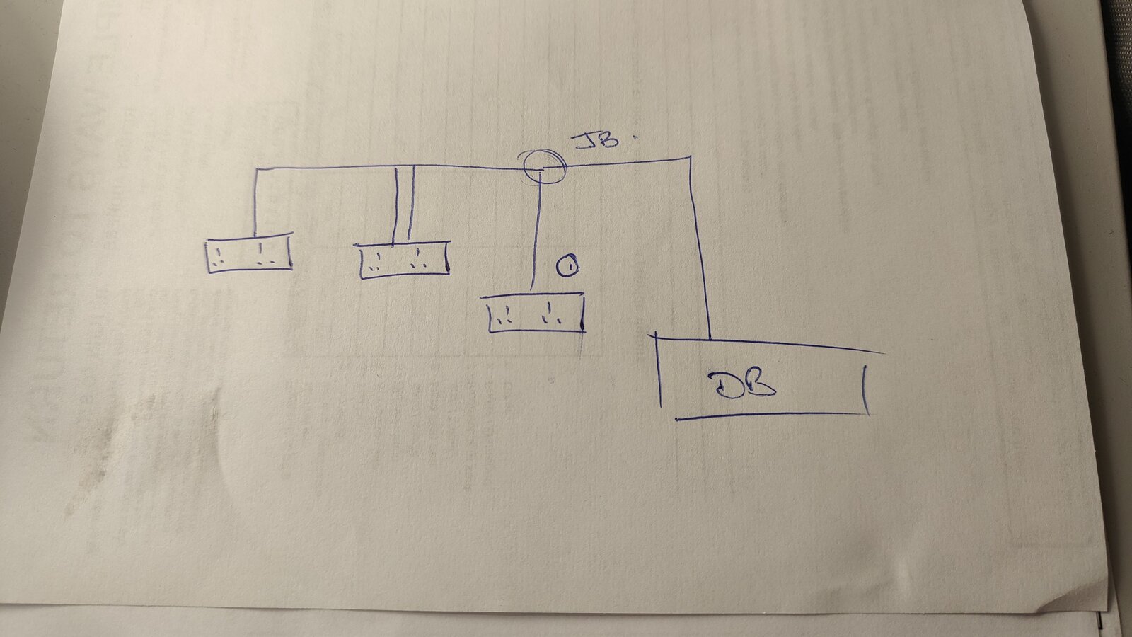

Radial circuit as below.. is socket 1 classed as a spur as it's fed via the JB? Apposed to having 2 legs.. one to the next socket?

A radial is all spurs, in a way.
It could be argued in a pedantic way that the two leftmost sockets are spurred via the junction box.
But yes, to keep things nice and simple, the socket on the right could be classed as a spur.
With a radial circuit, you can branch or spur off any point as many times as you like - so every point could in fact be classed as a spur.
I would say where BS1363 is concerned where the over load protection is the BS1362 fuse it is a spur, where the over load protection is a non BS1362 device then a radial or ring final.

Thanks all.. Just for my own piece of mind... you cannot double spur from a ring unless you introduce a FCU.. but with a radial as stated you seem to be able to spur off multiple times.. is that correct ?
Yes, if I understand your wording correctly, that's essentially correct.
As you have probably gathered, the terminology is confusing and many people (including myself) do not talk about 'spurs' in relation to radials, only 'branches'. As you suggest above, provided only that the same size cable is used throughout, you can have as many branches in a radial as you like.
Technically, the point is that with a ring circuit, the cable used is not large enough to carry the 'maximum current' of the circuit (usually 32A, defined by a 32a 'breaker'), so every socket needs two cables back to the CU/DB. A spur only has a single cable, not large enough to carry that 'maximum current', and therefore could not safely supply 'a string of sockets'. However, if it is feeding just one double socket, there is no risk of the cable being asked to carry more than it's rating - which is why a spur without an FCU is limited to supplying one socket. With a radial, all of the cable is capable of carrying the circuit's 'maximum current', so it does not matter how the circuit is arranged.
I am assuming that when you talk of "double spurring", you refer to having a spur from a ring, and then connecting a further socket (another 'spur') to that 'spurred' socket - in which case the above comments apply.
However, even with a ring you can (with certain caveats) originate more than one spur, each supplying just one socket, from the same point in the ring (i.e. a socket or junction box).
Not really. It depends on the size of the cable used whether fusing-down is required or not.
Whilst that is technically true, I don't think it alters the fact that the answer to the important/relevant part of the OP's question is 'yes' - i.e. that, provided only that one does not use smaller cable than for the rest of the circuit (which I doubt anyone would even consider) one can have as many branches one wants, arranged in any way one wants, without FCUs, in a radial circuit.

In terms of ring finals, although we talk about it a lot, as a theoretical possibility, have you ever actually seen anyone install a 4mm² unfused spur (supplying multiple sockets) from a 2.5mm² ring final?
I have not. I wonder why that would be.
Anyway, the fact that an FCU is required on a spur (with more than one socket) from a ring is because the 2.5mm² spur cable is inadequate for the 32A MCB - NOT because it is a ring circuit.
The same applies on a 32A radial.
I suspect primarily because it does not appear as an 'example' in Appendix 15, coupled with the fact that (for the same reason) people want to avoid subsequent hassle/arguments with 'inspectors'!
Quite so.
It does, indeed, and Appendix 15 does, in this case, indicate options for a 4mm² radial corresponding to the examples given for ring finals - i.e. an 'unfused spur' in 2.5mm² cable supplying just one socket and a 'fused spur' allowing an unlimited number of sockets to be fed with 1.5mm² cable following an FCU.
