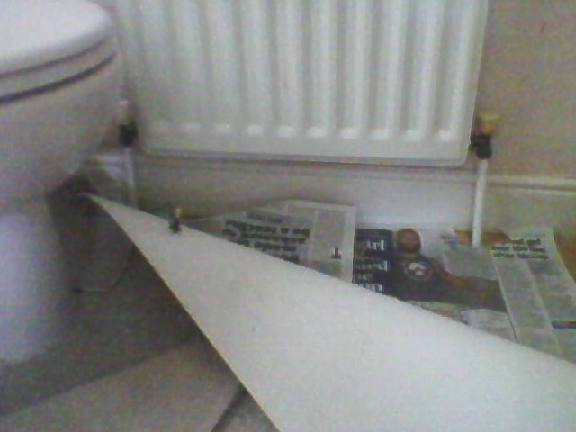

I'm painting the radiator in a small en-suite with shower, toilet and sink.
I took the earth clip of the bottom lip of the rad to paint. The clip is well rusted so, is the earth bond required?
The pipes connected to the radiator might require bonding, the radiator does not and never did.

I understand that bonding is to get two bits of metal, within arms reach, to the same voltage if there's a fault so I suppose someone sitting on a radiator using a hair dryer which has a fault, could make a circuit with the pipes via radiator?
I've tested the pipes and there's good continuity. The earth wire goes down into the floor. The electrics are the room light, shower light and shaver socket. The shower is a hot/cold mixer.

They could but that is not really to do with bonding. If someone touches a live wire then it would be better if no pipes were earthed - but some are.
There will be, won't there? They are both connected to the radiator.
The question is - are they connected to the supply earth by some route?
Ok. Not known.
So if there's continuity between the pipes because they're connected to the radiator, why the bond on the radiator?
I'll wager there are bonds betwenn c/h pipes, hot and cold pipes some where in the house.
Because some people don't know what they are doing.
As Flameport says; there has never been a need to bond radiators.
It very well could all be satisfactory. The CH pipes are joined by the radiator.
More important would be a continuity measurement between the CH pipes and the water pipes - if you can touch the radiator pipes and the taps at the same time.
