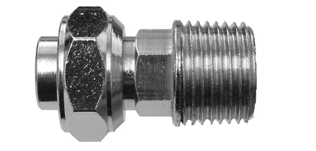

Radiator tails have two ends.
The tail would refer to the part which connects to the radiator. If you can get PTFE tape on the compression joint between the tail and the valve that would be impressive as they are quite different to a normal compression joint. This is all still irrelevant though.
