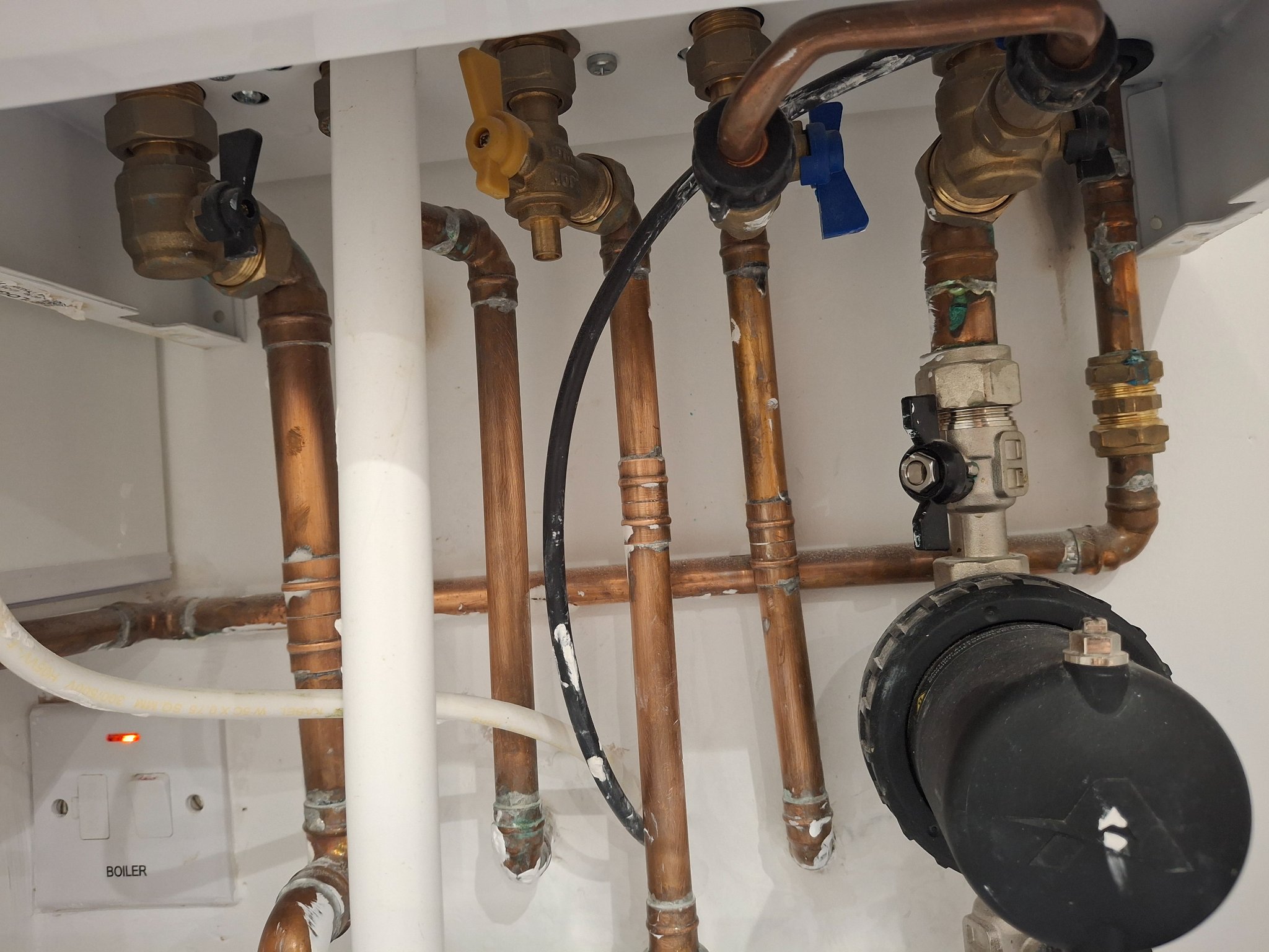

Just check the return is open under the boiler - maybe post a photo of the underneath?. Are any of the radiators heating up?
Ah yeah, it's open I think - both the left and right pipe heat up when it's on.

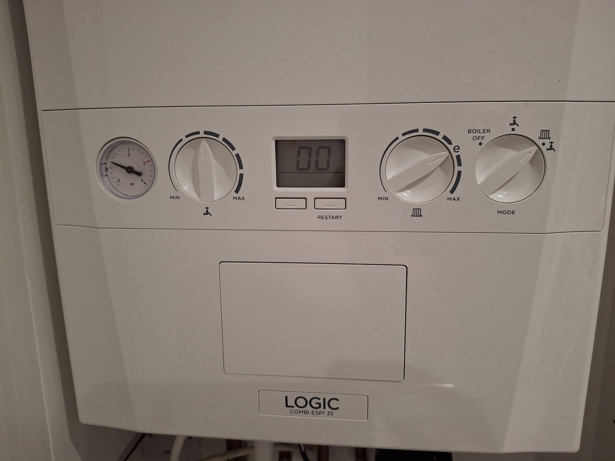

Also the 00 on the boiler says 51C when the heating is on.
Ok, yep, both are in the open position. No in-built timer, but irrelevant imo as it’s firing and in ch mode. The only other 3 I’d say is:
1: air lock - but I would expect some heat to some rads
2: lockshield valves closed - you said all valves are open (which will be trv’s). Lockshield Sam should have a white cap on - removable by hand or screw - if you can or want to post a photo? Otherwise just get someone out under the defect agreement
3: it’s on zonal Heating (x2 thermostats) and one or both not opening
