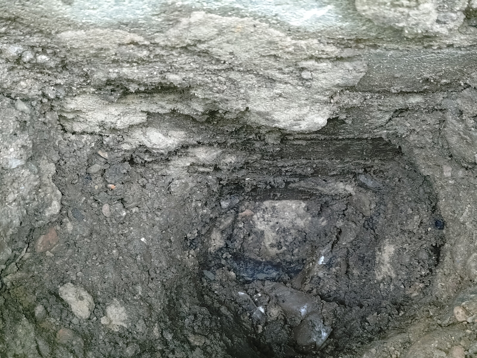

Does the picture confirm it's a raft foundation or is there any other foundation that uses a poured concrete outer?
All my ground floors are concrete. One I drilled got soft at roughly 20cm.

It could be a raft. It could be a ground beam sitting on piles it could even be a conventional trench fill where shuttering has been used.
You need to dig down and find the bottom.

You need to dig a bigger, deeper hole and expose more of the concrete, as said above.
A 'raft' foundation is a steel reinforced engineered structure with a distinct design, often with a 'toe' (but not always) protruding beyond the masonry.
You may just have a concrete slab.

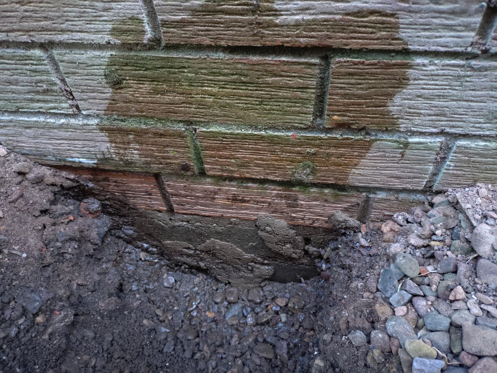

If it is a raft it probably doesn't go down that far, so someone else said? I'm continuing to dig...
Let's see if I've done enough...
There's 7 layer of standard concrete brick and then I hit concrete (doesn't seem that even). There's a black thing to the side which chips away easily (the wood shutter turned to charcoal?).
So it's not a raft, right?

It's looking like a traditional strip foundation, typically 200 or so thick.
If it is vital to know what you have then you need to find the bottom of the concrete. If you're talking about adding substantial loads then you need an SE's input anyway.
