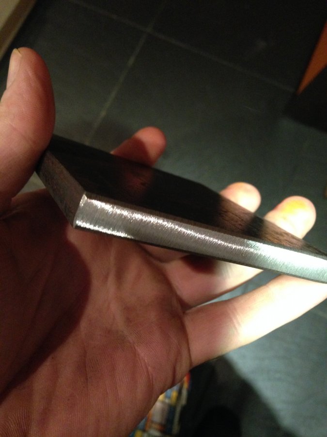

Ok, the place that got me the beam will sort me out a steel spacer.

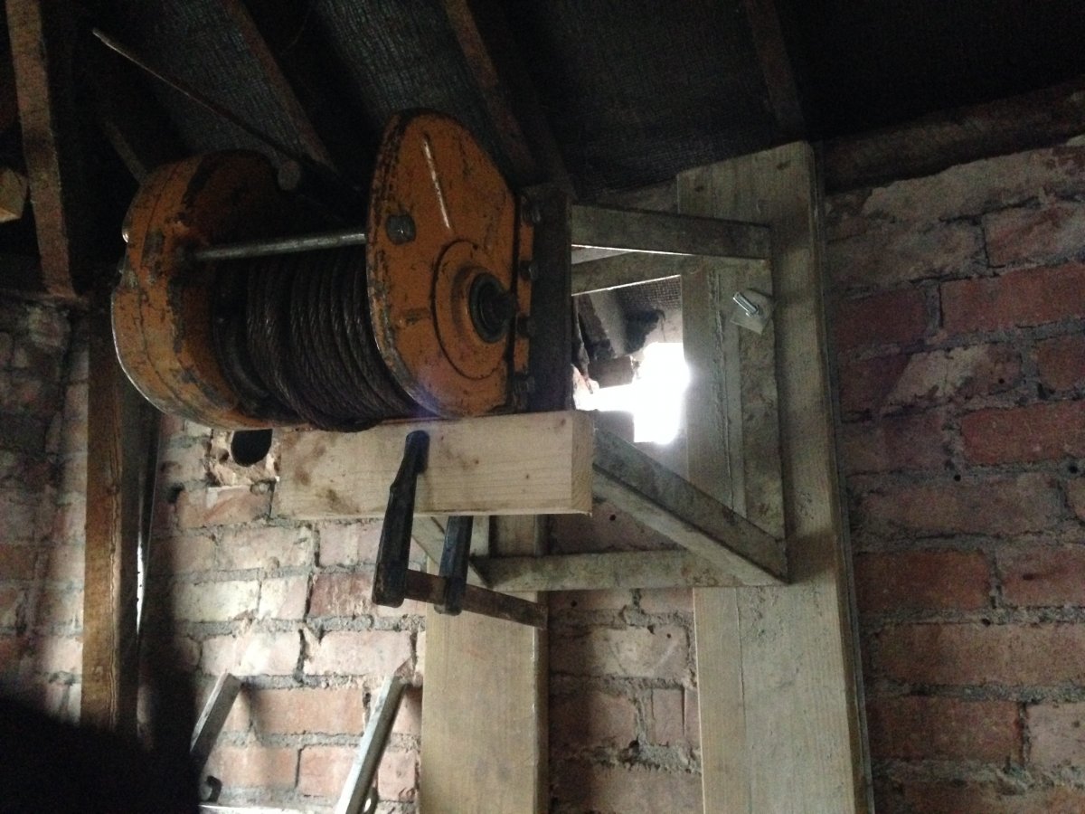

I used a winch to get the beam up, it worked out pretty well
Concrete padstones usually have a characteristic strength of 50n/mm². Allowing for the required factor of safety, that would probably be down to about 20n/mm². So a 100 x 100 plate could transfer a factored load of up to 200Kn onto the pad (approx 20 tons in old money). This would be well above normal domestic loadings for a beam so a 100 x 100 shim/packer would be fine.
What is that Wallace and Gromit contraption?
Surely, a steel pad, of the same material as a steel beam, and of the same bearing area dimensions of the flange of the beam above it, will perform exactly the same as the steel flange would?
It's a winch used for re rounding pitch fibre pipes, it would normally sit over a manhole rather than be bolted to a wall.
I had to lift the beam up 5mtrs high and through a hole in the side of the house, not just lifting it from the floor onto the pads.
Yes, of course it will. It was just a case of raising the beam 10mm. We don't know the actual bearing length of the beam (eg it could have been - say - 200mm), and OP perhaps concerned that a small packer might over-stress the concrete? Dunno?
It looks like something from a medieval torture chamber.
It's a bit of a beast!!! That's just half the frame that you would put over the man hole.
It made very easy work of lifting the beam up.
