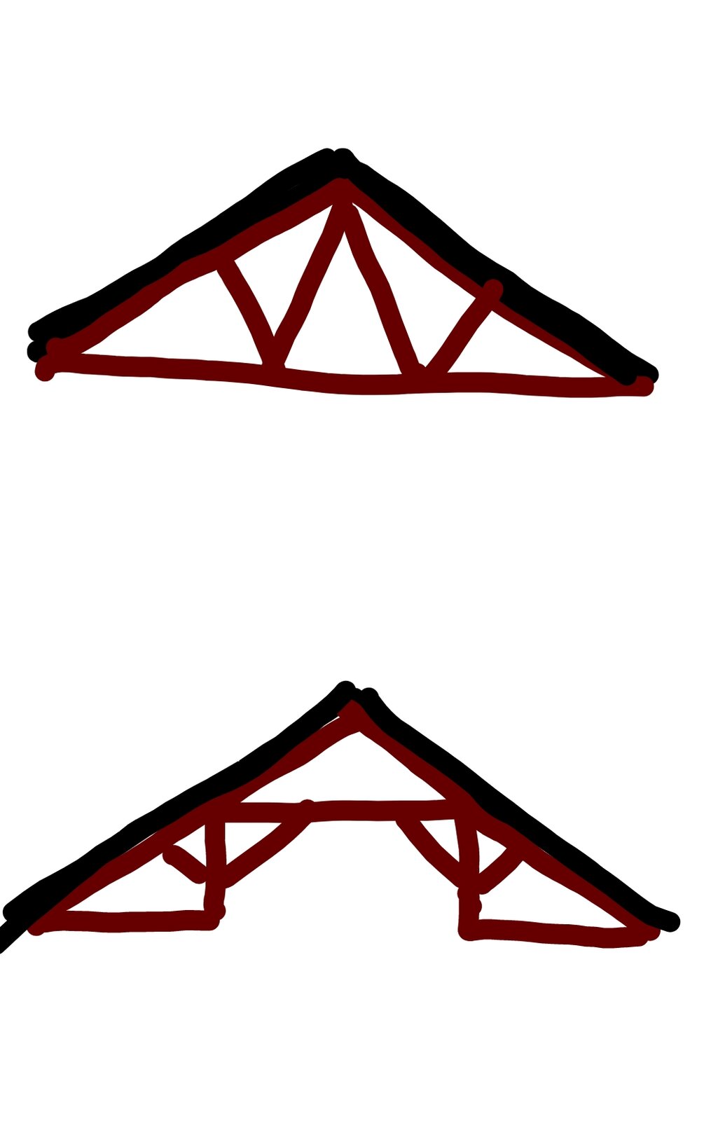

Hi,
Looking to see of this is possible in theory before getting too ahead of myself with ideas.
I have a single storey detached garage with an 8' 4" ceiling which I need to raise up in a small section.
I think I would need to remove about 3 of the ceiling joists to give me the overhead clearing I need in the centre of the garage.
Has anyone done something similar and I theory would the bottom structure in the attached image work? The top structure is what I currently have and is what would remain in place for all other joists.

You can’t just modify trusses (which is what your top pic is of), as they’re purpose built structural elements. If you take a chunk out of the bottom horizontal (ceiling tie) it’s likely the roof will spread/collapse.
you might need to introduce chunky timbers/purlins/steels for what you’re trying to do. Normally go to a structural engineer to get something designed. Or if you’re lucky there’s one around here sometimes...

2-3 trusses in the centre of a roof is unlikely to be an issue, as long as it's all braced (chevron braced) afterwards.

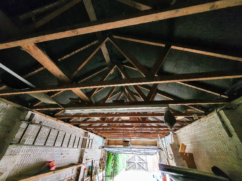

Sorry, I could have been a bit more specific with what I am needing it for. I will need about 1-2ft of additional clearing to allow me to install a golf simulator, basically enough to swing a club without putting a hole in the ceiling. The opening would be central widthways but not necessarily bang on centre lengthways, but not far from it.

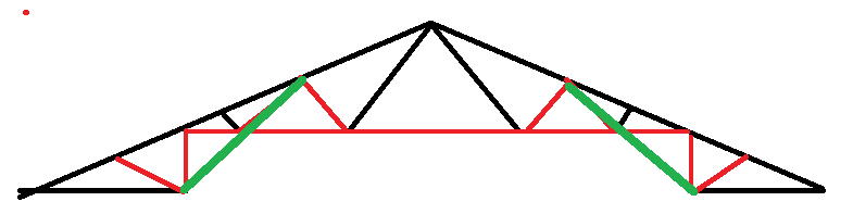

I have seen a similar topic on this forum where someone suggested the attached diagram as a solution, which I think is similar to what you are saying here?
I have also included a picture of my garage so you can see the structure.

That image is a bit dramatic. You don't have the height or span to require something that elaborate. Looks like a a case of just forming a raised collar.

Just to make sure I have understood this right, installing a collar tie in the upper 3rd of the roof and then attach new webs above them to replicate the previous truss system should allow the existing trusses and joists to be removed?
This would be repeated for the 3 or so joists I needed out of the way and the end result would be an increased ceiling height from wall to wall, rather than just in a narrow central section?
