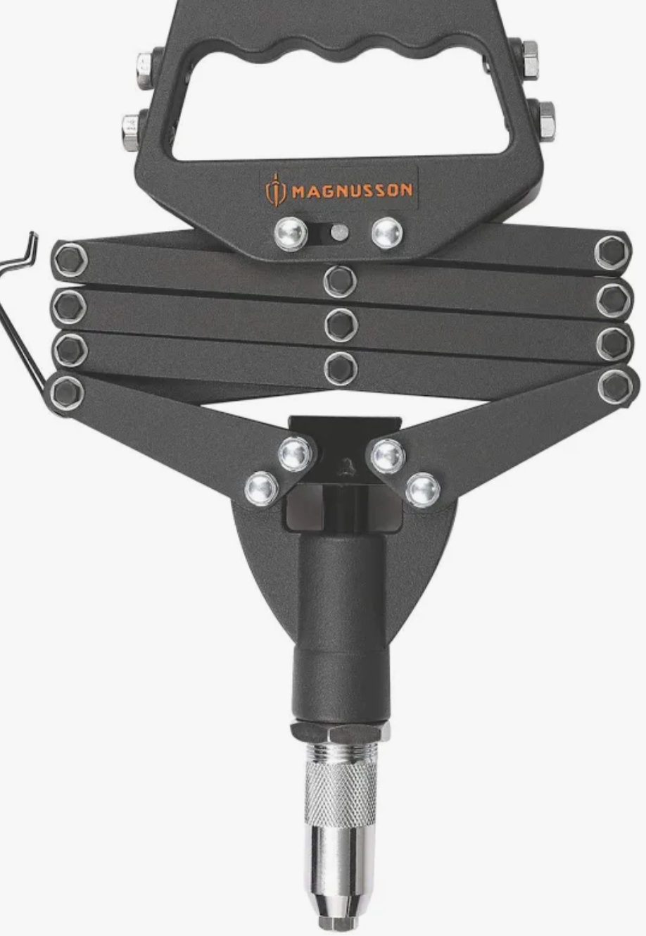

I use a lot of the interset (I think that's the right term) fixings, and have a gun type tool (90 degree head-to-handle) to fix them. But my grip is not what it was, and I saw a guy in a passing YT vid with what looked more like a trad pliers with the setting tool pointing out the end. And it was a ratchet.
Can anyone recommend one; or a really good 'gun' type with a ratchet. Ta.
One of these, you mean?
You could extend the handles using tube if it's too hard to squeeze (could do that with your existing too but I dare say it'd make it harder to use
I wonder if lazy tong versions exist, like rivet guns
