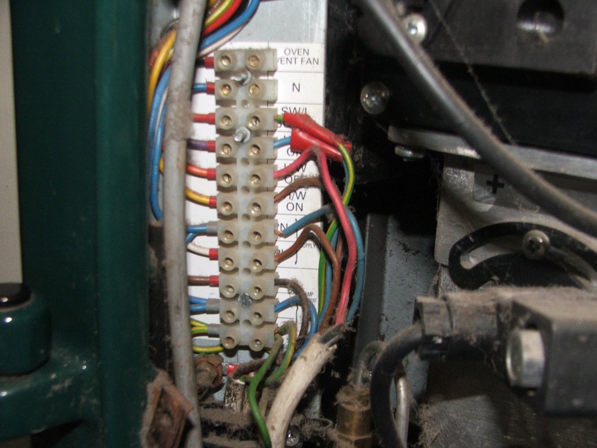

I have the above Rayburn, after engineers did some work on it I find that the central heating side comes on of it's own accord and pays no attention to the programmer. The only way I can get the central heating to stay of is to switch to Hot Water Only. Any idea where they have gone wrong with the wiring ? The until works well only I does not come on and off via the programmer.
There are a number of ways these can be wired/ configured depending on what controls you have installed. Before anyone can advise we need to know:
Do you have a room thermostat?
Do you have a cylinder thermostat?
Do you have a 3 port mid position valve or 2 2 port valves?
Do you have a frost thermostat?
What work was carried out on the Rayburn?
Can you not get the engineers back if they stopped it working?
The wiring on a Rayburn is totally different to what you would expect from a normal Y plan. You cannot have heating on its own, only with hot water. Get your engineers back. They need to follow the wiring from the the junction box adjacent to the burner. A common mistake is to wire in the hot water off connection to the wrong connection. Are you using a separate programmer instead of the built in one. If it is two channel, this is wrong, it should only be a single channel for the heating and hot water and you isolate the heating with the selector switch on the Rayburn.

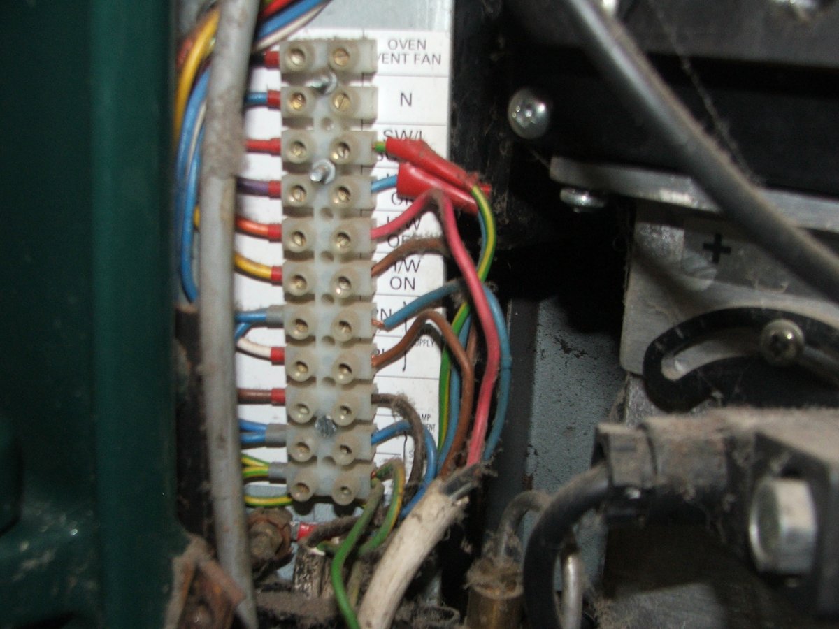

Can you take a picture of your wiring block in the burner compartment? Is there a wire in the hot water off terminal. Despite its nomenclature, this should only be used to connect a frost thermostat. I suspect this is where your problem lies.
There is one red wire going into the H/W OFF. It comes from a cable that has a black wife cut back and not used, only the red is used for the H/W OFF.
From the top
N spare not used
SW/L Boiler green/yellow
HTG ON blue
H/W OFF RED
H/W ON BROWN
PN Neutral BROWN
PL Live BLUE
Those colours don't mean much, without knowing where they go to, but from your description and the choice of colours used I expect the wiring to be very poorly installed. If you have a copy of the Rayburn installation manual you should be able to trace each wire and match them up with the 3 port wiring diagram, to see if the wires are all present and connected to the correct terminals. If they are correctly connected there could be a fault with one of the external parts.
Can you post some photos of the wiring? It's always useful to see and may show up a glaring wiring error.
