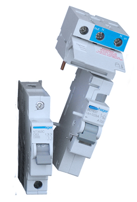

Well here is a add on to make a single MCB into a double pole RCBO with neutral away from buzz bar. Easy with Photoshop not so easy in real life why are they not made?
we have the fuse carrier already made all it needs is something to plug it in to.
The MEM RCBO pod (Eaton) attaches to MCBs, I have only used them on SP MCBs but I have an idea they also fit DP.

Schneider make DP Vigi Modules, which work in a similar way to Eric's picture, but from below (as they're schneider, and they like to be different) But the Vigi is a 2 mod thing, and even more expensive than the Eaton RCBO pods.
