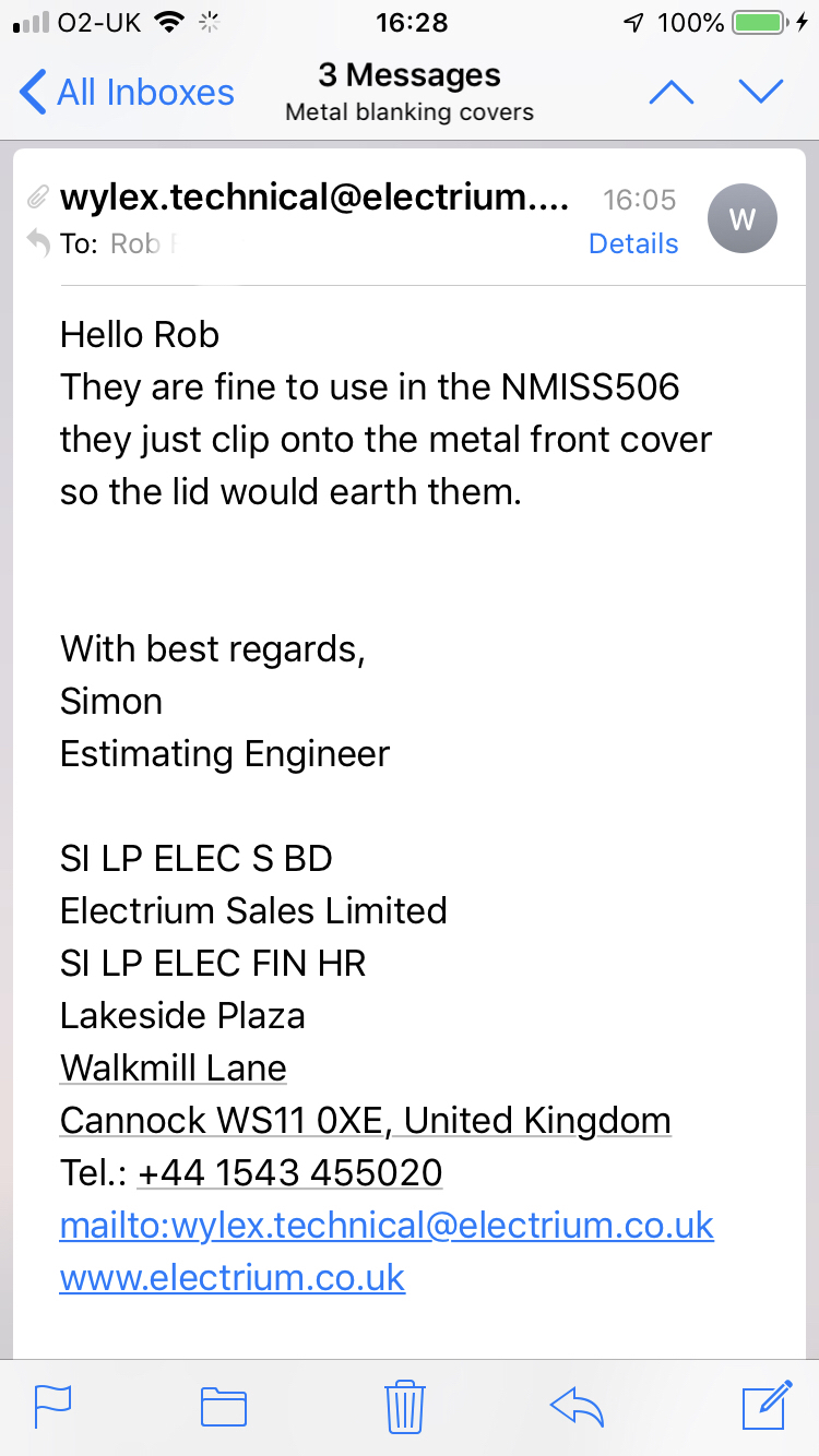

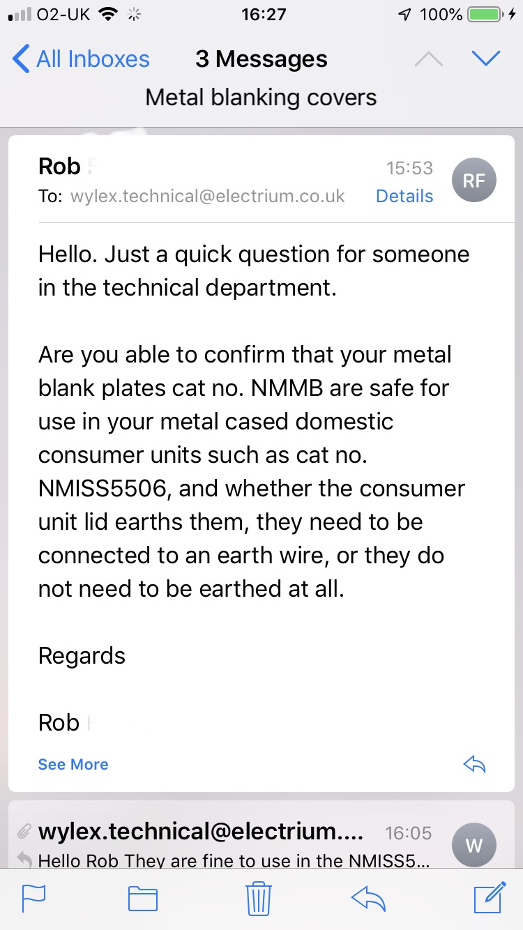

They’ll be as earthed as the front hinged cover appears to be.
TBH I don't think they are. Both side of the cover are white paint. There is little chance of them having an earth connection
Exactly my point. Thank you for spotting it!Same as the hinged cover then![]()
I haven’t been inside a Metal Wylex board. But I rather suspect that the front plate is no more earthed than the two securing screws through the painted metal to the (earthed,we hope) back plate.The cover is not likely to be contacted by a live conductor.
You’d like to think so. Does anybody know for sure.I meant the hinged lid.
The front (cover) certainly must be earthed.
