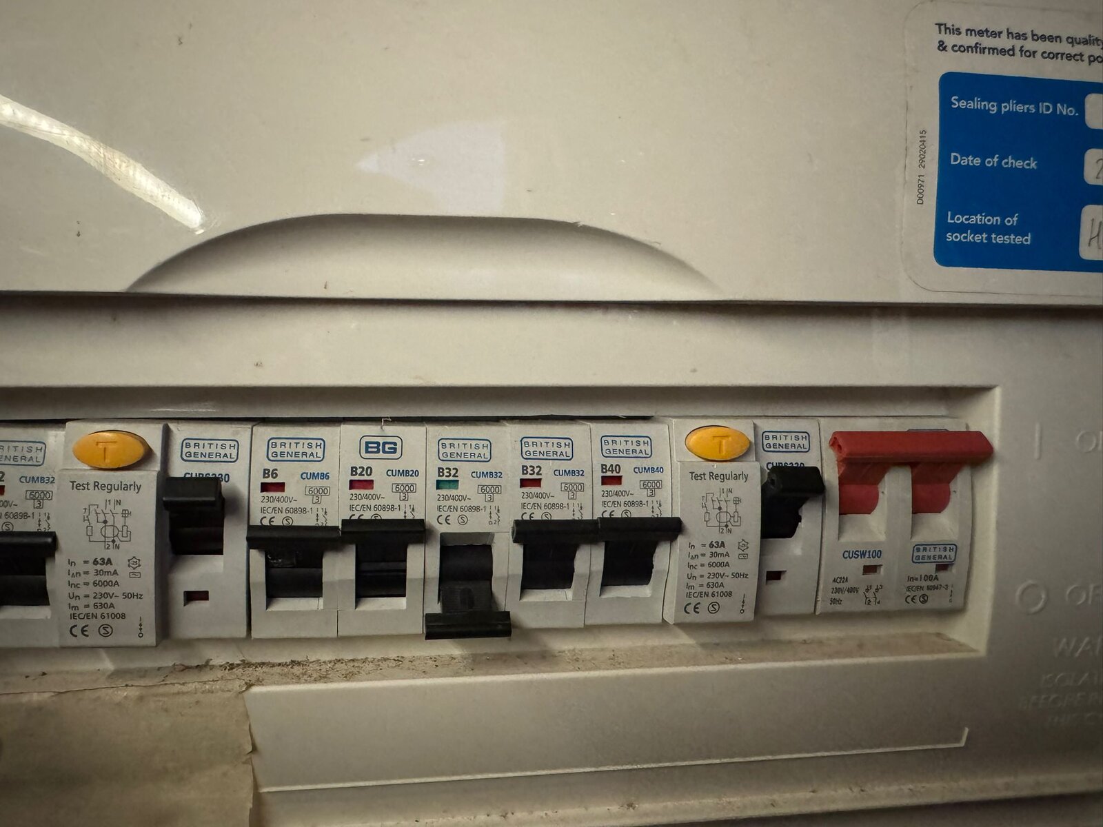

Please find attached an image of the fuse box for reference. The cables connected to the socket are 2.5mm in size. I have not had any electrical work carried out recently; the only activity was some painting and decorating, which took place approximately a year and a half ago.
The circuit initially tripped late last night, just before I went to bed. I disconnected all appliances from the sockets and was able to reset the RCD. However, the circuit tripped again this morning. Although all appliances had remained unplugged since last night, my partner had plugged a phone charger into the affected socket.
After removing the charger, I attempted to reset the RCD again, but this time it would not reset. This is when I began removing the sockets to investigate further.

That is an MCB (Miniature Circuit Breaker) that is switched off; not an RCD (Residual Current Device).
If that is what has been tripping then you must have a short-circuit fault (L to N) or an Earth fault (L to E - any E, not necessarily the Earth wire).
This is likely to have left a scorch mark at the location of the fault and as it won't reset likely to be still touching.
Mice? Are there any signs of rodents in or around your property, because rodents are a common cause of wiring faults.

The tripped item, in your photo, is a 32amp MCB. Is that what is tripping or the RCD to it's right, with the yellow button with a T marked upon it?
I believe it may be a radial circuit protected by a 32-amp RCD. I say this because the electrics were rewired in 2015, which is when the extension was built. The extension appears to be using the same circuit as well.
A radial on a 32amp MCB, would need to be wired in 4mm, not 2.5mm. 2x 2.5mm appearing at the MCB terminal, would suggest a ring, but you would need to test that to confirm it is actually a ring.
