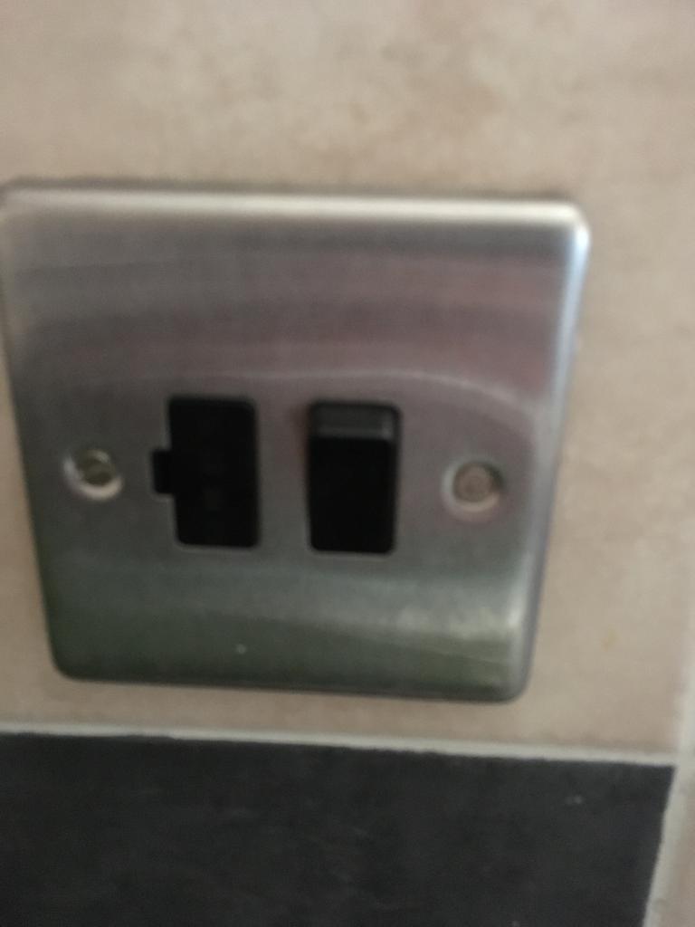

Thanks for all the replies & time - comments below - photo added

here is a photo - washing machine switch - which i sort of hoped was DP and switched off - would isolate -
I'm not sure whether they ever existed, but I haven't seen an FCU which did not have a DP switch for decades. Hence, if you still get trips when that is switched off, I think it exteremely unlikley that vthe vWM is to blame.

@ETAF the fused switch in your photo is double pole. But if is switched ON!
Tell them go switch it off and see if the RCD stays on. If it does, it’s a machine repair person, not an electrician that they need.

I thought most fused switches were DP to - but as i say on the phone he seems to isnsist may not and when i suggested unscrew and simply test i got the pause again
I will go back tonight and and ask why is that switch still ON , but it maybe photo before i asked them to turn off .. They did tell me it was off.... but that maybe during the discussion and phot

the switch was off , from yesterday - that was an early picture , trying to identify it
