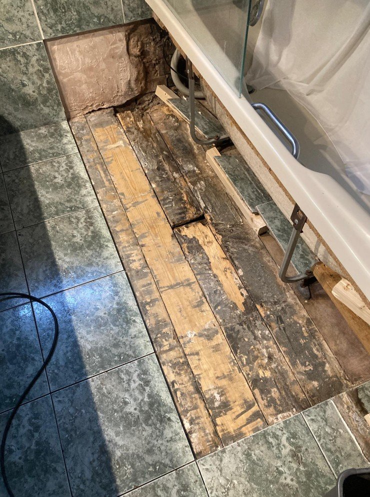

Hi All,
I have 4 x 40cm x 40cm tiles to go back down in our bathroom as we had a leak from the bath and I've replaced a couple of rotten floorboards. All the tiles have been put down 30 years ago directly on to floorboards using flexible adhesive. As I've not mixed up powered adhesive before am I okay to go with this Mapei product?
My concern is although I've only got 4 tiles to go back down I've not used rapid set before and they say it starts going off in 10 - 15 minutes which doesn't allow me a lot of wiggle room.
Any help or advice would be really appreciated.
Cheers
Daz

That adhesive is not for wood.
Needs to be flexible adhesive and for wood.
I kind of think use CT1 then flexible grout as only 4 tiles.
Lay dry.
Maybe a couple of nail pins in floor as a guide.
Shouldn't take more than 5 mins to put tiles down then walk away and don't mess with it.
Adhesive will start to set after 15 mins but probably workable for another 10+. Don't worry about it. Crack on
