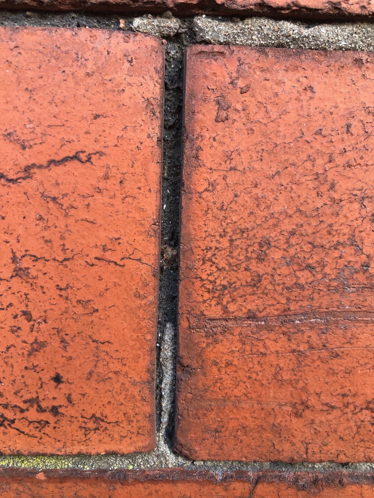

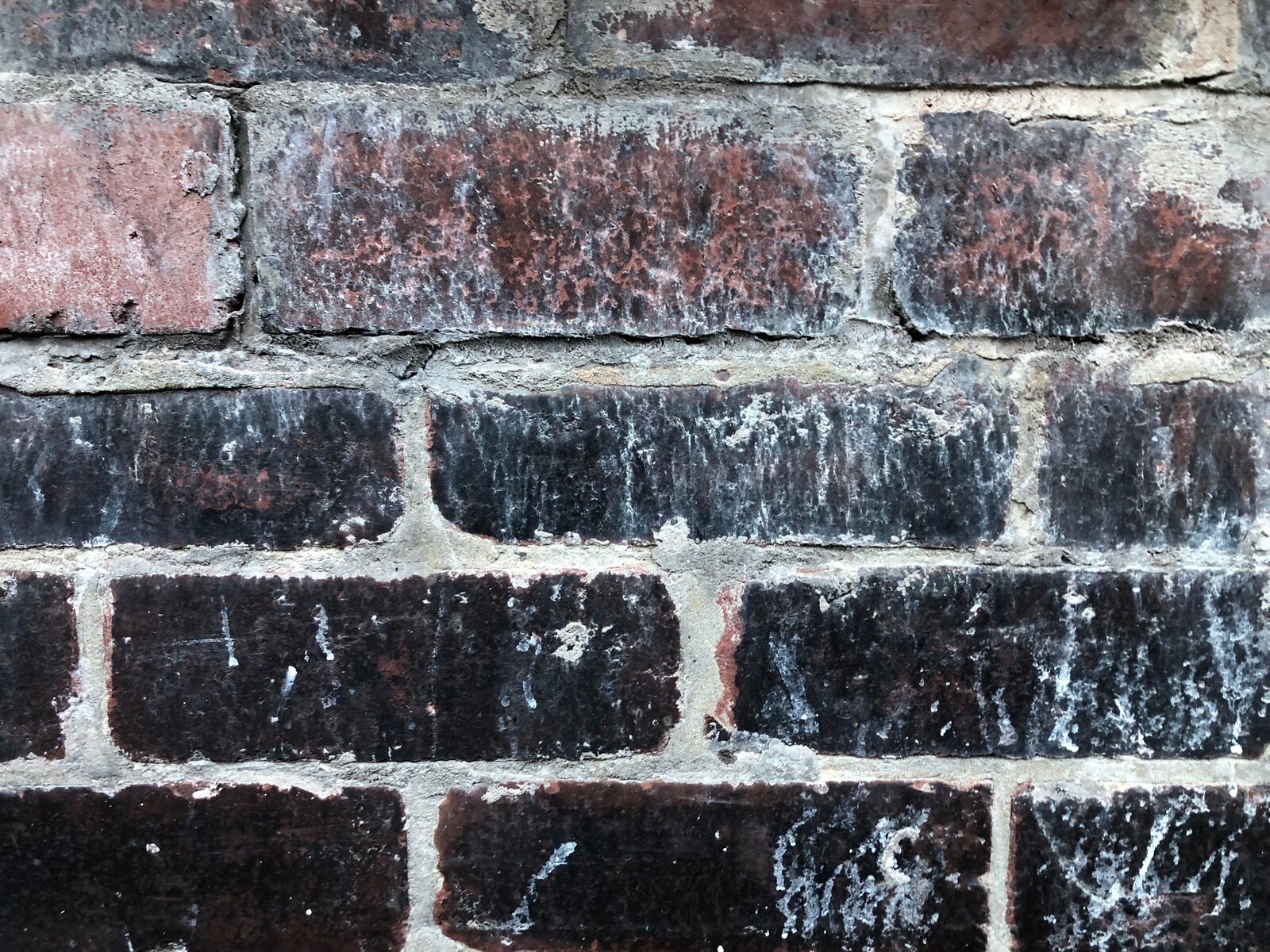

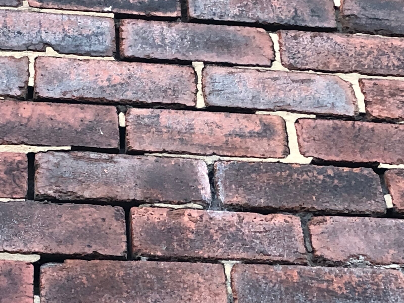

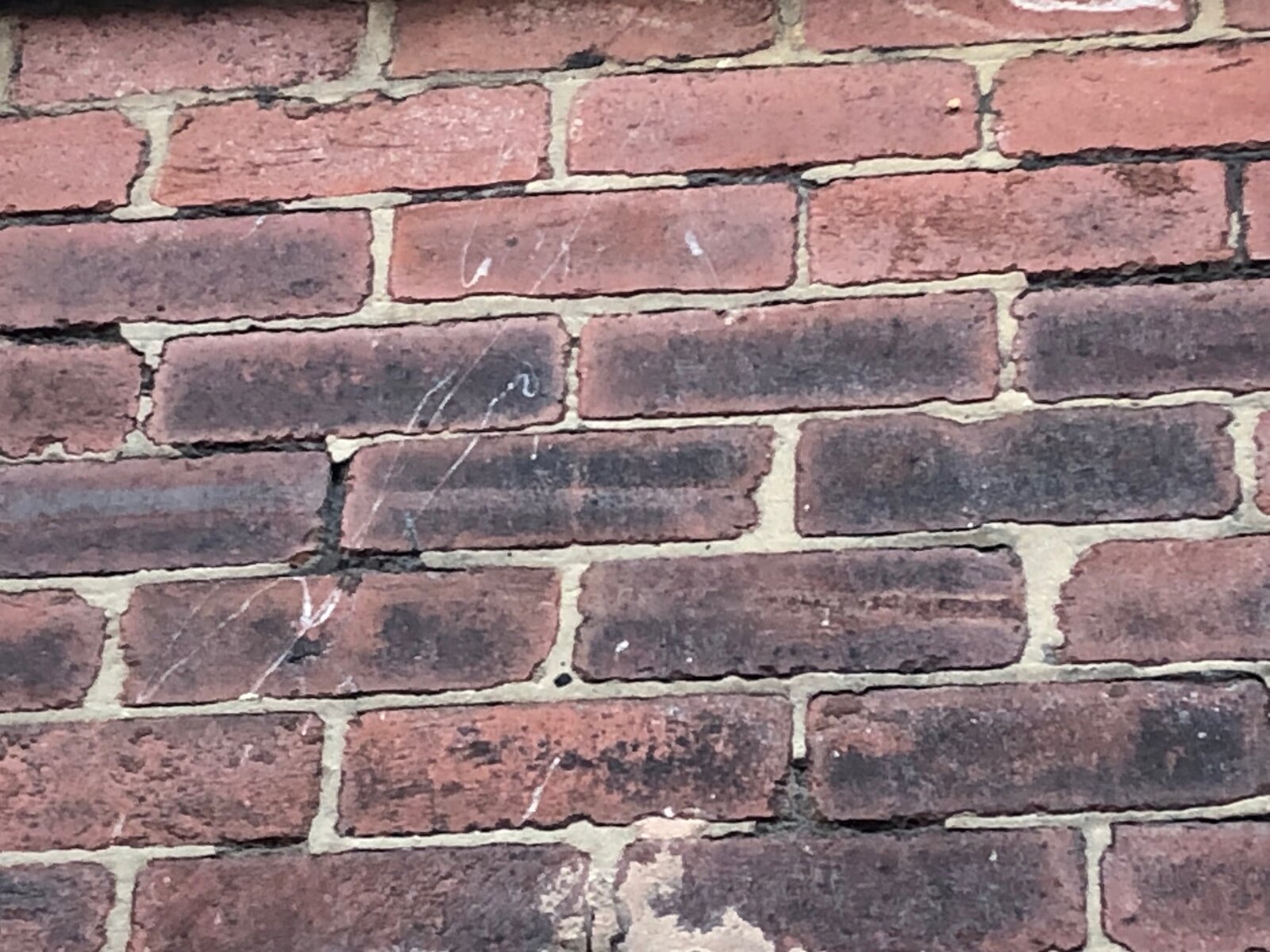

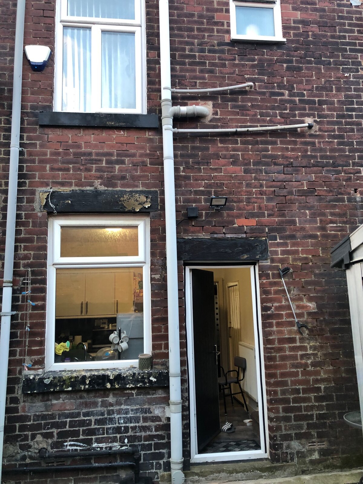

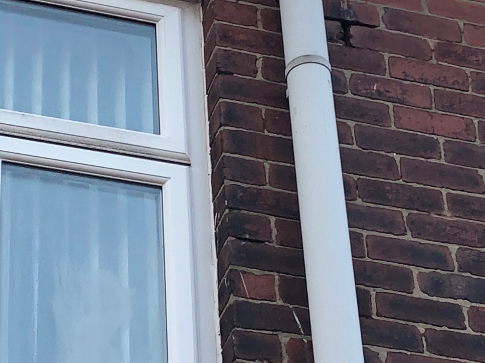

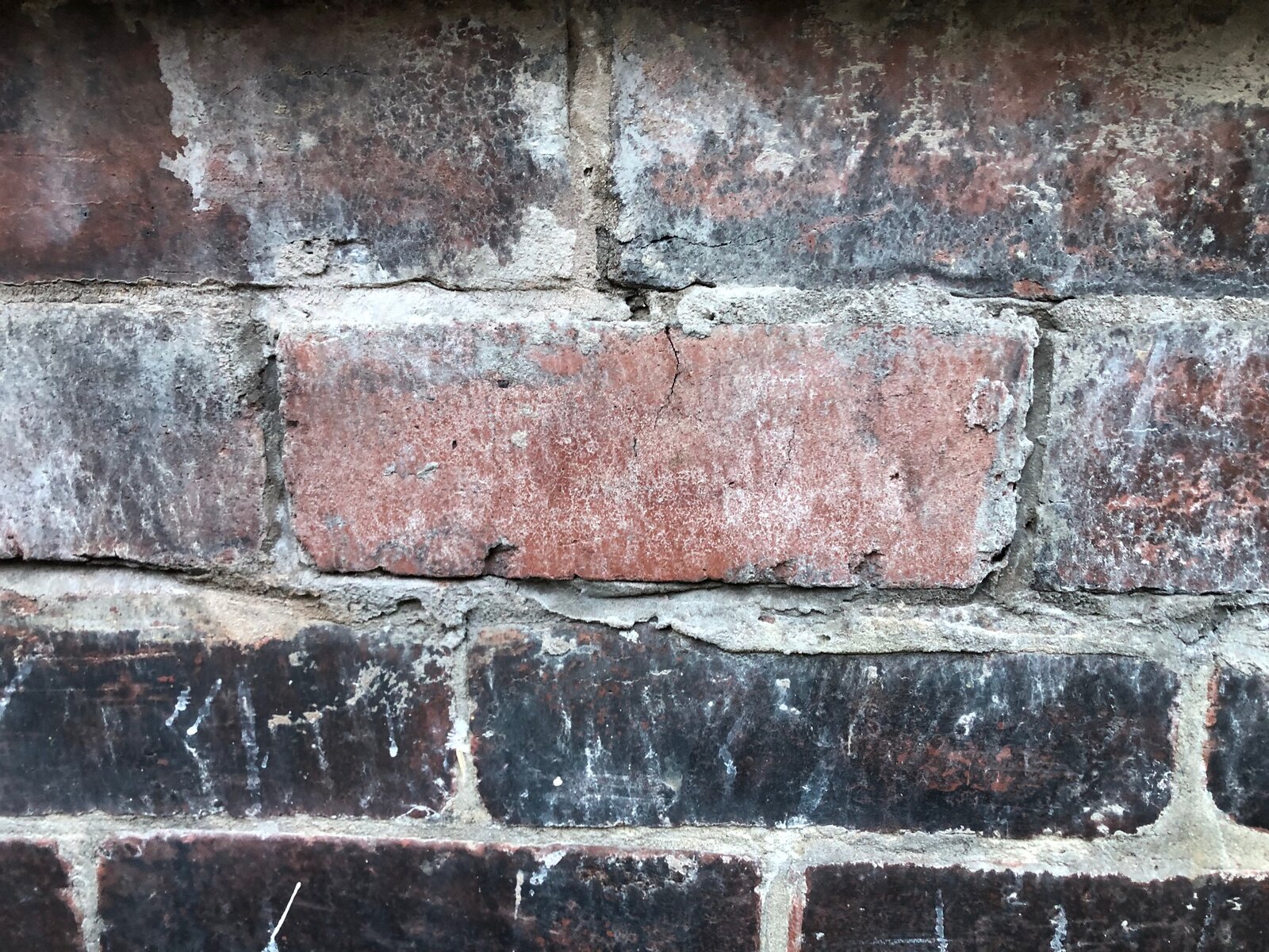

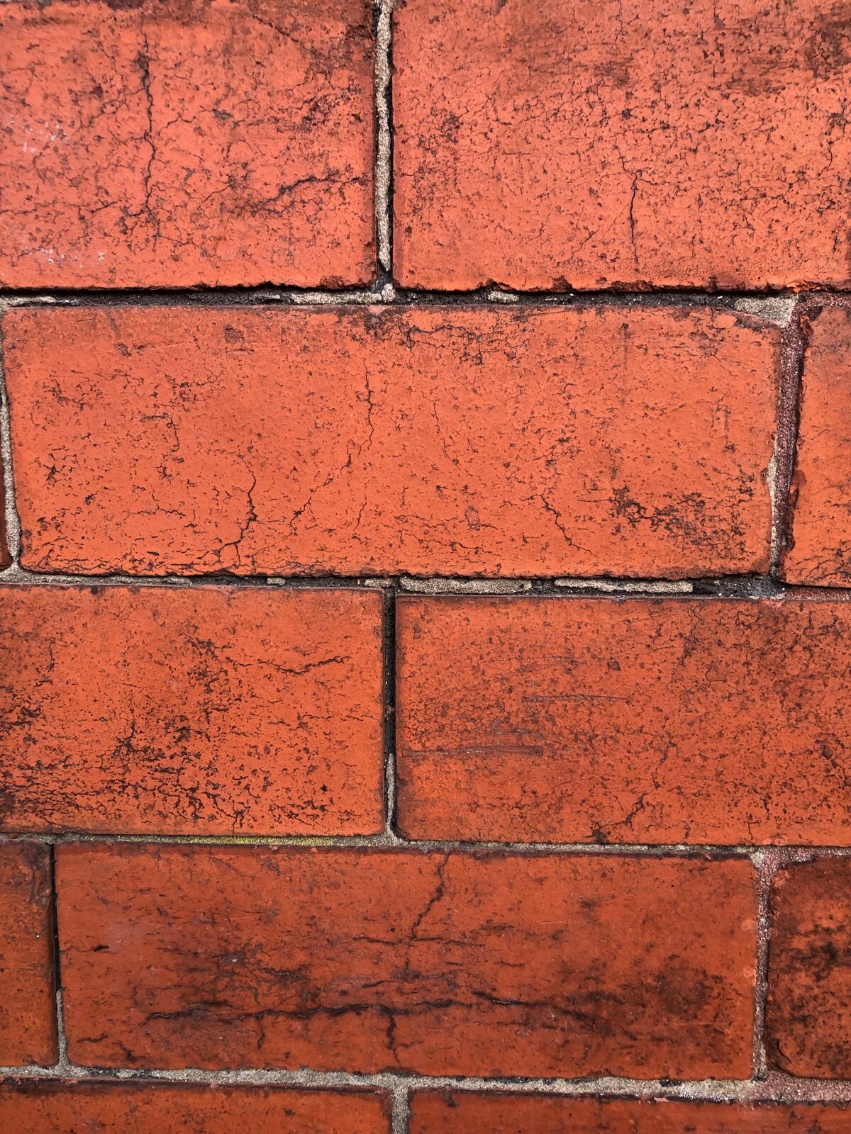

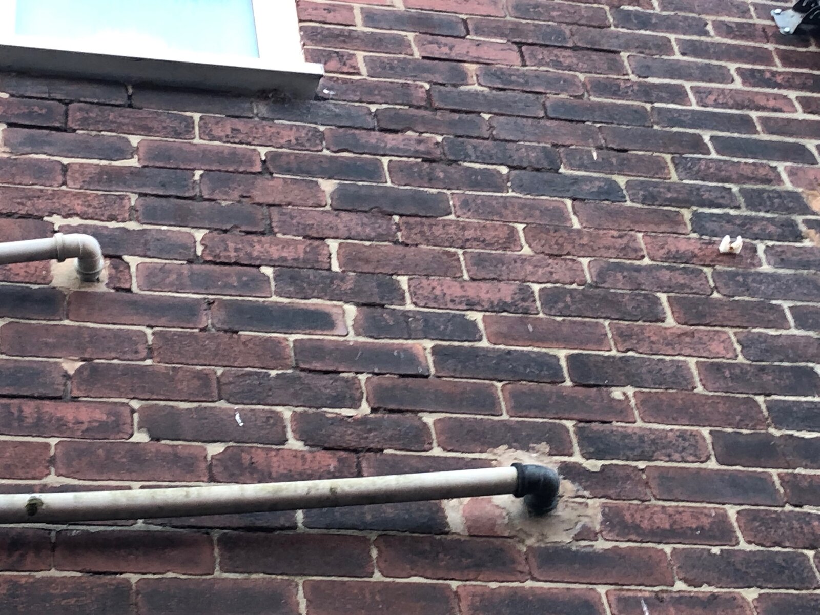

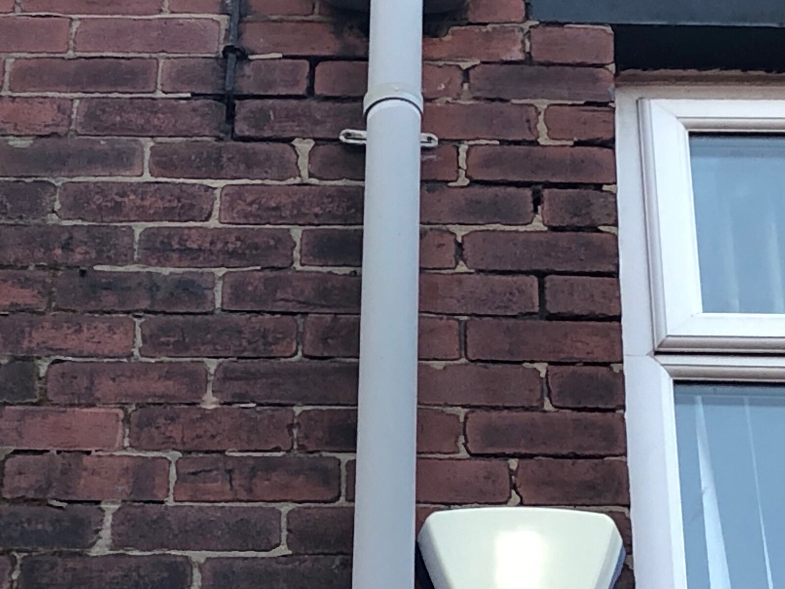

See attached pictures.
First 8 pictures are of the rear of the house, south facing. Last 2 pictures are the front. Wouldn't allow me attach more but the front is in better condition than the rear.

OP,
Thanks for the pics & info.
The price you have been quoted is a good price.
1. A previous DPC has been injected - not much use in a cavity wall unless no original DPC exists?
2. There seems to be a sand & cement plinth - usually its best to remove S&C plinths.
3. One 9" x 3" air brick can be seen (remove it, its too high) - you need, say, three 9" x 6" a/b's front and rear. All installed below FFL.
4. No blown-in CWI has been installed.
5. "grind out" to a 25mm depth.
6. The last pics show stock bricks on the front elevation - stock bricks have very thin beds & perps. Care req'd.
7. Do you have signs of damp damage anywhere on your inside wall surfaces?

Responses below, apologies for my lack of knowledge on this, I'm not in the trade and have never had this type of work done before.
Yes no original DPC, the injected DPC was done way before we purchased it.
Do you mean the black bit to the bottom of the front of the property. From memory I don't think there was one to the rear.
Would a a couple high level (top of first floor) ones be a good idea in addition to these? The floor is concrete not an elevated wood floor does the affect the location.
There is, the guy who quoted pointed out the drill holes for this, I suspect this is why the air brick has been sealed.
Ok - thank you.
Thank you.
Yes damp to internal walls, we had a survey done and they concluded the moisture was being absorbed by sub-floor, underneath the asphalt, through the holes in the pointing and making its way to the center of the house. The chimney was removed to below the roof line many years ago so it was definitely not that. Also the rear garden floor (all flagged) was at an elevation sloping towards the property so rain water would flow towards the house. I had a channel drain installed to cover the width of the property and flow into the existing drain.
OP,
2. I can only glimpse a possible S&C plinth in the rear elevation pic #8? The front elevation is not shown.
3. As my previous, air bricks "ventilating the cavity"are a very bad idea.
4. If all your floors are solid then air bricks are not needed.
5. My bad - after your correcting me, I can now see the CWI holes.
7. Pics showing the interior walls damp damage will help?
I'm assuming that, over ground soil, you've got concrete floors with an asphalt DPM on top of the concrete - if the asphalt is failing then pics showing failed areas will also help.
