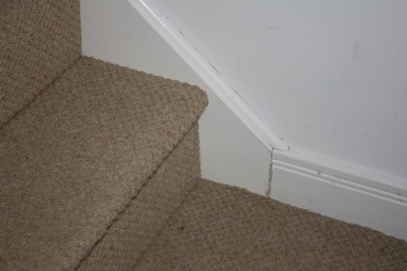

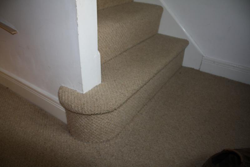

I've attached a couple of photos that hopefully make my situation clear (and I hope I've inserted them correctly):
The first image shows the stringer coming down to meet the skirting board - as you can see, it doesn't meet with a newel, but meets the floor and butts up to a skirting board.
The second image shows the curved bottom stair, which would be a pain to cut around hence my question about trimming the bottom riser and fitting the flooring underneath.

Can I trim or rebate the bottom of the stringer to fit the flooring underneath it ? I'm worried it may affect the structural integrity of the staircase.
Can I trim the bottom of the bottom step's riser without any problems - it won't make the step squeak or effect the integrity of the step / staircase in any way ?

Looking at your pics, I think it's fairly safe to say you can undercut both the stair string and the curved riser at the bottom of the stairs (called a bullnose)
The stair string should be fixed to the wall anyway and you'll only be undercutting the bullnose by 15mm. You may find that at the front of the bullnose (across the bottom of the stairs) that you'll cut right through to underneath the stairs (depending upon the age and construction of the stairs)
Some bullnoses are made of plywood. Older ones will be made of solid timber about 3/4" thick. ;) ;)
as JJ says the string on the wall is not a problem
if you are leaving the carpet on the stairs then just remove carpet and underlay and roll up/unpin the base off the carpet to give clearance as you lay the floor

I'll undercut the stringer and the bullnose riser. I am keeping the carpet on the stairs, but will remove the carpet from the riser to make the undercutting easier and will trim the carpet and re-fit with some adhesive afterwards.
