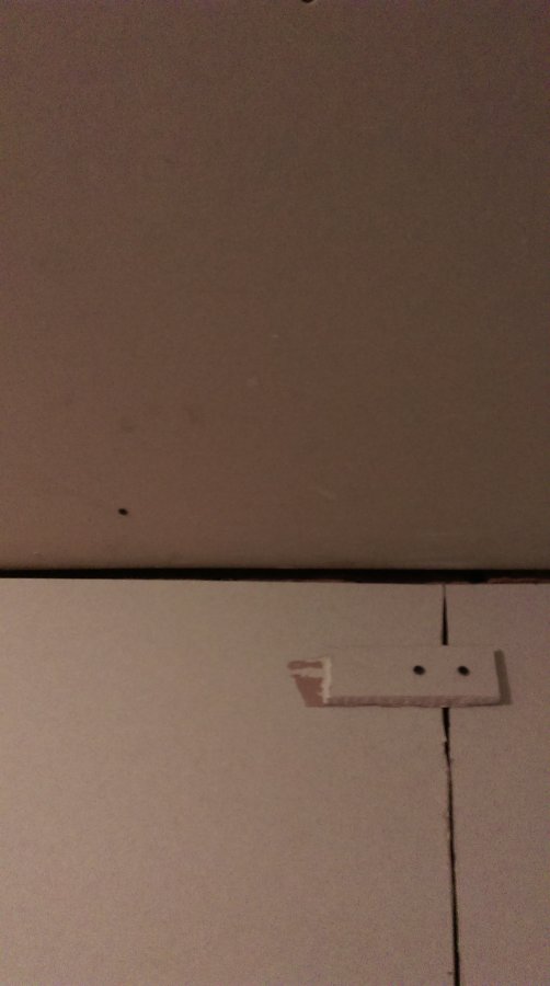

Hey folks!
Well I really made a bit of a #$%& of this bit of plasterboard in another room I did. I forgot to screw in one of the plasterboard edges to the ceiling rafters, upon realising this I decided to put the screws in and get rid of the bowing board then all of a sudden I get this nice 20mm gap appear where the wall meets the ceiling. The wall board isn't long enough now so how can I get around this? Whack in some dot and dab before it gets skimmed?
Iv attached a picture of shame!

Haha nice . Even that might not cover it !!
Should have known it would go wrong at some point. Best of it is this was the last room and the easiest.
Other options I thought was to cut a patch out and place another board in it. Pretty sure I could just fill it with dot and dab but really not sure!

It sure is mate. Iv done most on my own but our house is funny sloped ceilings and as you said beams are miles out. good point on being wide enough I had that issue too. Probably why it annoyed me so much not noticing those screws when I did the walls!
Skim shouldn't have any issues sticking to the drywall I wouldn't have thought so going to fill with adhesive then. Thanks for the replys guys.
Bit of an update. I found out why I never put the screws in that board. I had forgot that the ceiling rafters was out by a mile and I forgot to correct it before wall boarding. Popped the board down and lowered the rafters now it's about a 5mm gap so all sorted!
