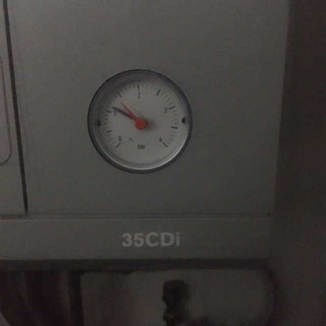

The iom for the combi does not require a bypass.
Are you sure it's the model type you say?
Do you have a photo?
I called up Worcester Bosch Tech Support and they said it does need a bypass valve
