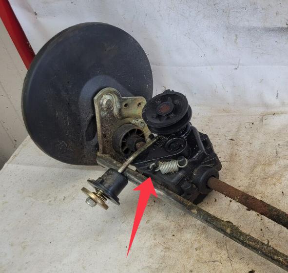

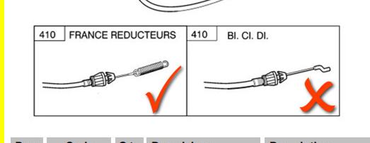

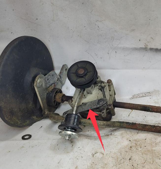

I supply 2 photo of axles available & i also supply photo of the cable i have fitted.
Do you see a difference in the 2 axles available ?

All I can see is that the dog clutch mechanism - that makes the axle actually drive - has different return spring system.
You have chosen the correct drive cable.
Either should work - if they physically fit!
