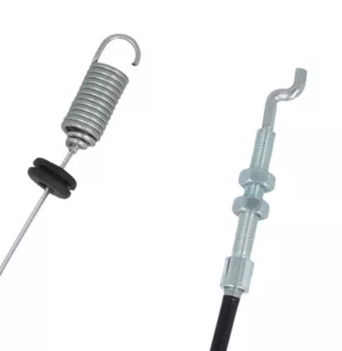

Morning,
Attached is the cable in use.
The spring that you see is what passes through the vertical post i mentioned & the hook on the end sits over the arm & in a small cut out.
When I pull the handle at the bar the spring expands pulling the lever. So when I let go the bar because it’s an expansion spring this doesn’t then allow the arm / lever to return so the other spring I mention must be pulling the arm / lever back which then disengages the driver Correct ?
Are you saying the cable could be wrong when you mention it’s length ?
Do you devise me to drop the axle out & see what’s going on.

At this stage I would turn the machine over and see if you can work the engage lever by hand, maybe with the cable disconnected?
The lever should have it's own return spring somewhere, and lubricate the lever externally.
If that works well, then it has to be cable adjustment as far as I can see.
Regarding the new cable, it's the coil spring and threaded adjustment lengths that should be identical.
John :)

I dropped out the axle again to get a better look. I removed the cable & operated the lever on the gearbox with my hand & it returns all the way 100%
I fitted the cable at the gearbox end only & whilst holding the outer casing I then pulled the inner cable at that goes to the bar handle. As the axle was out I could see everything. The arm seemed to return 100% but if I pushed the inner I could then see it move back more. Removed cable returns 100 % fit cable returns say 80%
The return spring was removed & I cut some of it off & made a new circular hook.
I fitted it back over the lever / arm & the other end on its post.
I’ve now fitted the axle & also the cable back on the side arm & made an adjustment. I could see that I had more adjustment on the threaded part which has 2 locking nuts.
Once all back together I engaged the self propell & I wasn’t able to pull mower backwards. I let the bar go to disengage and was still able to pull the mower backwards. So seems ok until I try it out cutting grass this week if dry enough.
