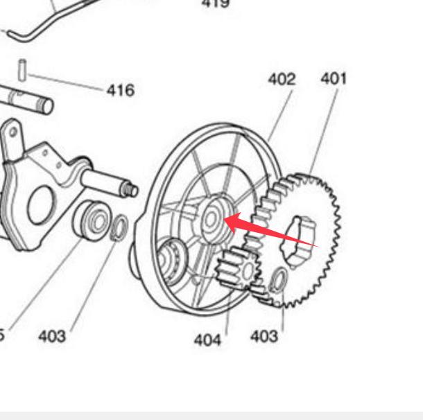

In the attached photo can you advise what im expecting to replace please.
Im looking at 402 or 405 but think 405 might be a metal bearing as i dont see how else the item would spin true.

The gears 404 and 401 are getting out of alignment, it would seem.
401 is actually connected to the wheel and it's my guess that the wheel bush is worn to cause this.

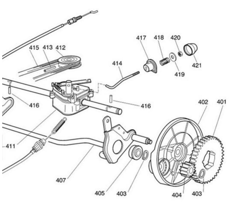

Can the metal shaft that passes through these bushes we are talking about have an effect for what ever reason ?
If it was a metal shaft passing through a metal metal then maybe some rust etc but as its a metal shaft & a nylon bush im not sure if the drag is going to happen or not

Plastic bushes are what they are - cheap and nasty but we are stuck with them!
Something is binding here - so it's either bush / spindle wear, maybe the fit of 404 on the axle shaft.
Spin 404 - if it free wheels in one direction that's fine, but make sure that pin 416 is free in its hole, and 404 has clean grease in there.

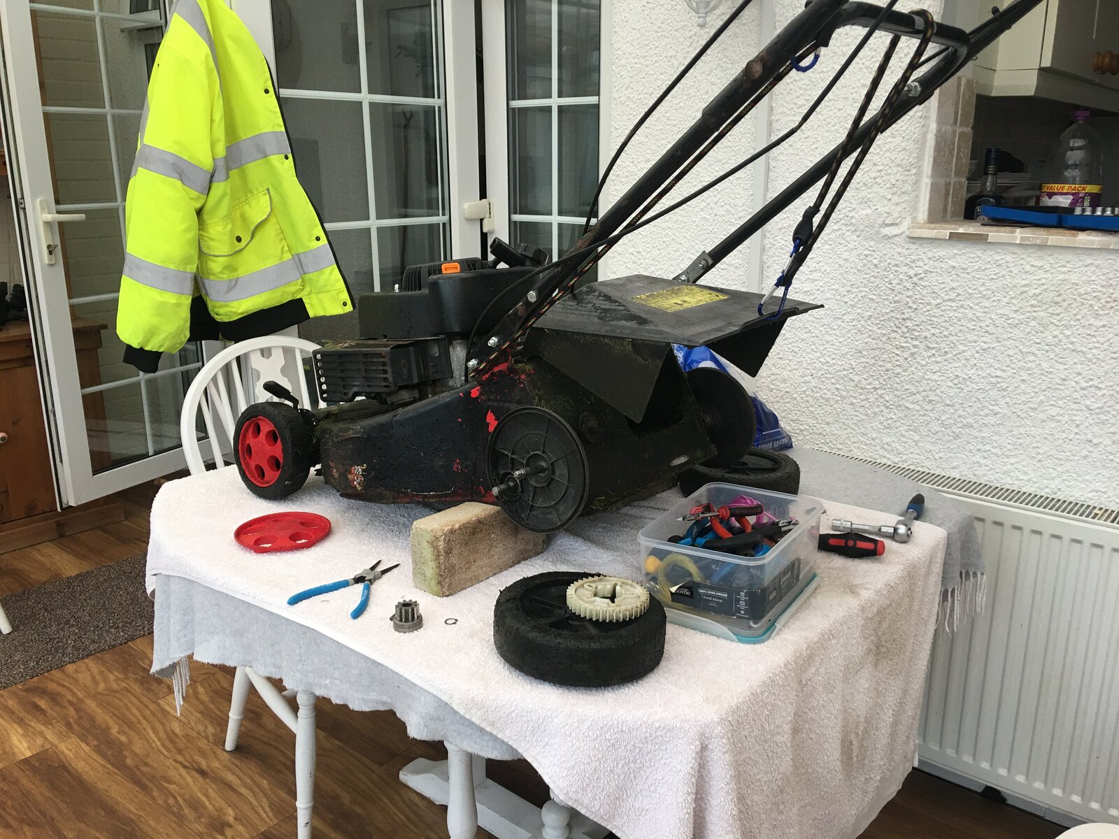

Started early

I have taken the wheels, plastic white gear, metal her cog all off & give it all a very good clean. I then started to put it back together a piece at a time then trying the wheel to pin point the issue.
So one side is perfect still but the other locks up or stutters.

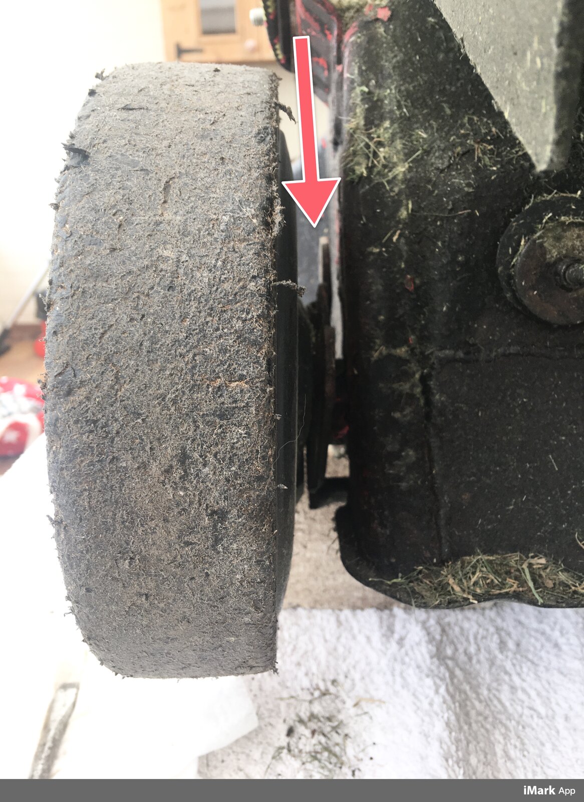

The reason that I see is the bracket between the mower & back of the wheel.
Placing a screwdriver in the so it pushes out the bracket a touch allows the wheel to spin perfect. Screwdriver removed & issue is back. Bushes are fine & it’s this bracket. I’m going to place a 1/4 inch piece of wood in there & see how it goes.
When moving the screwdriver in the gap you can see the wheel straighten up & this is why the plastic gear is worn slightly on one edge.
