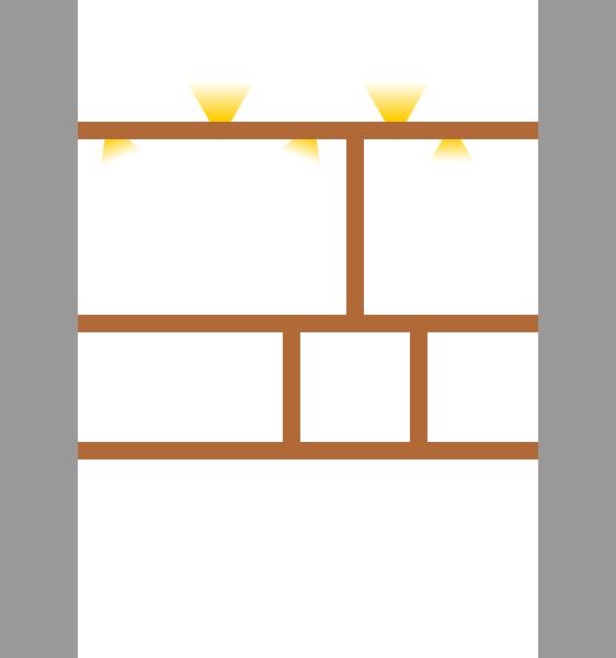

Hi.
I want to build some box shelves into an alcove, basically using a simpler design of picture 1 (attached below).

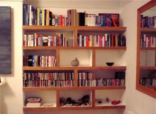

I want to recess some downlights and uplights into the unit (see picture 2). They would both be recessed into the top shelf of the unit (shelf width approx. 40mm)
What would be the best downlights to use? I'm tempted towards some 10w 12V halogens (the transformer could sit discretely on the top shelf as it is way above eye level). Do halogen downlights like these need 'open' backs to prevent overheating?)
What would be the best uplights to use? Would I be able to use halogen spots again? Or would there be a problem with dust landing on the halogen bulbs because they're pointed upwards?
Any help greatly appreciated!
Image 1 (I found this on brightoncarpentry.co.uk):
Image 2:
You would be much better off with LED lighting. Any form of halogen lamp that's bright enough to give off enough light to be useful will also get far too hot. Perhaps not so much a worry about the wood itself, more whatever might get placed underneath the lamp that could be flammable - i.e. books!
Recessing everything will be a problem, as any conventional downlight will require far more than 40mm for the lamp & fitting to sit in. You could consider surface mount lights (those using LEDs or perhaps GX53 CFL lamps), some manufacturer's fittings only protrude by 20mm or so and should be fairly inconspicuous. I guess you could even recess such a fitting if you made a large enough rebate into the wood to provide adequate ventilation around the fitting.
Another option to consider is a T2 fluorescent batten hidden behind a wooden skirt/plinth in the same style as the rest of the shelves. It will provide a very even light distribution along the length of the shelves, and T2 fittings are relatively small and easy to conceal.
