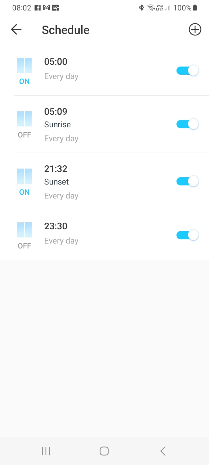

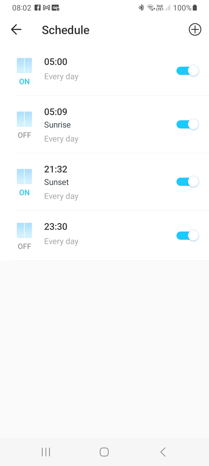

I have ended up with a collection of lights, adaptors, switches and relays from different manufactures and ideal would have been all from one. I still have one or two lights with PIR's around the house there are eight lamps, latter lamps have made some no longer required, two back of house are not really powerful enough to light the rear of house parking area, steps both sides of the house have some dark spots, lights down front drive to main door are now good, lucky google home brings them most together, so hey google turn on outside lights turns on 6 of the 8. Dusk and Dawn commands on the light switch means they are not powered in the day Outside_light_schedule_Tapo.jpg so with a 12 watt bulb the power used is low, there is at the moment still a PIR on that lamp, but cats, squirrels, and foxes can set them off, not had badgers as yet, also using my ham handy. But the main problem is turning off the lights, when you have hands full with shopping being plunged into darkness is not fun.
