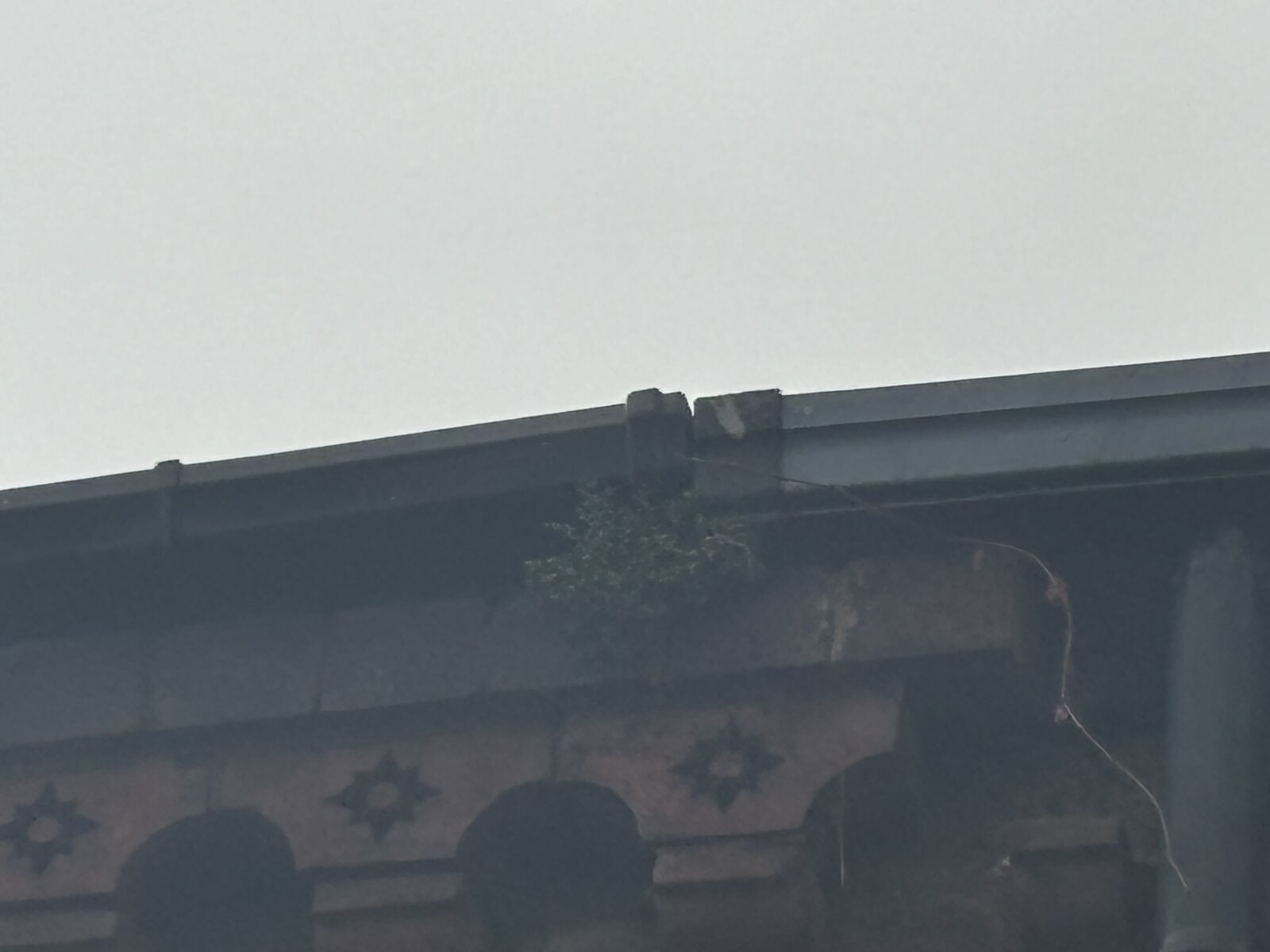

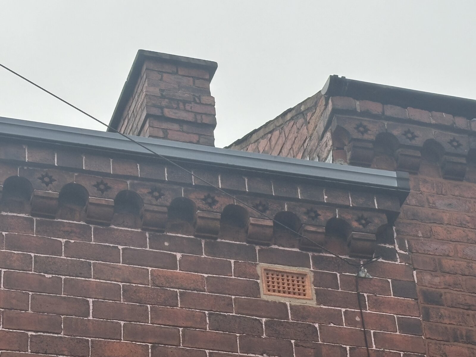

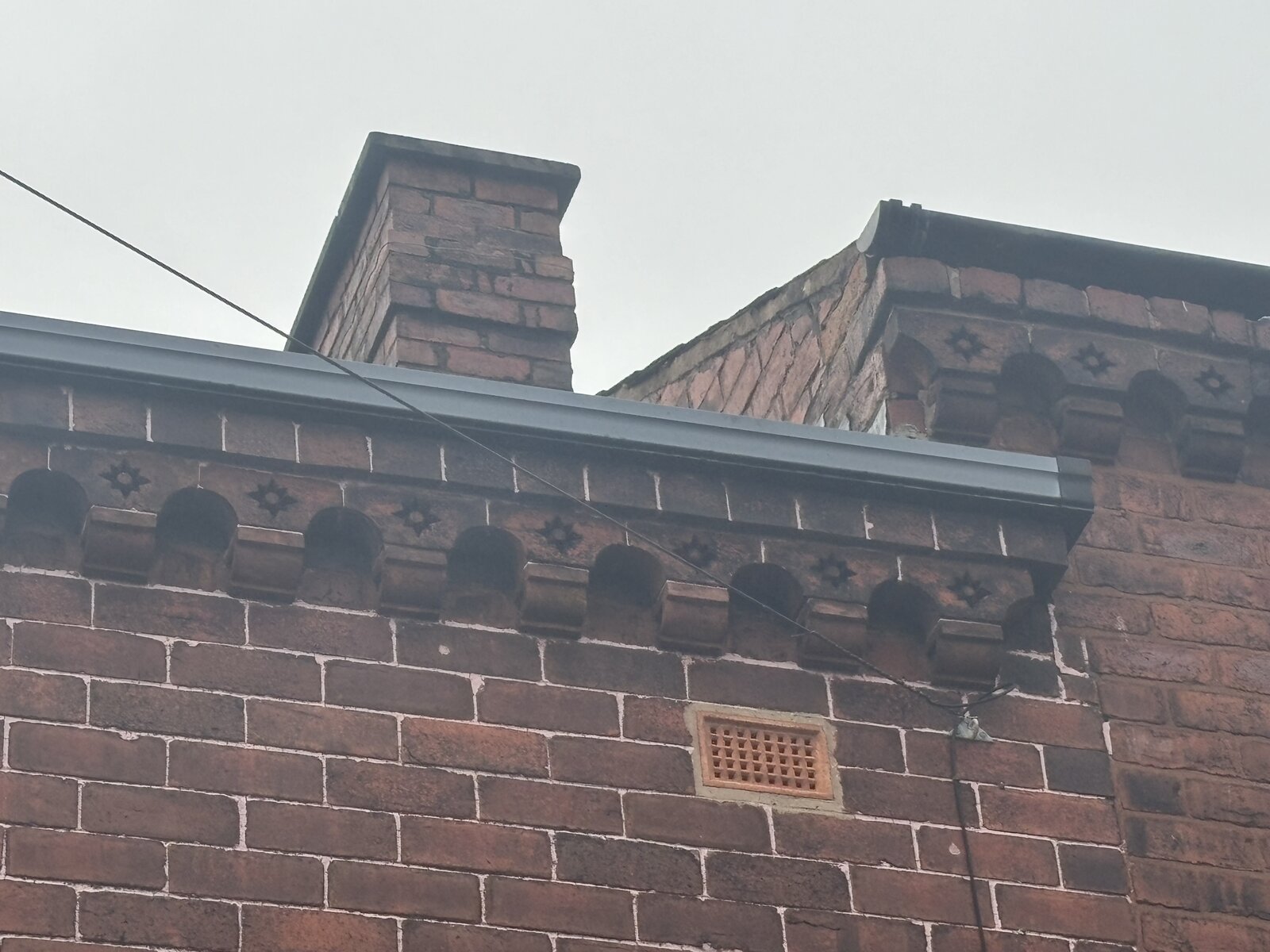

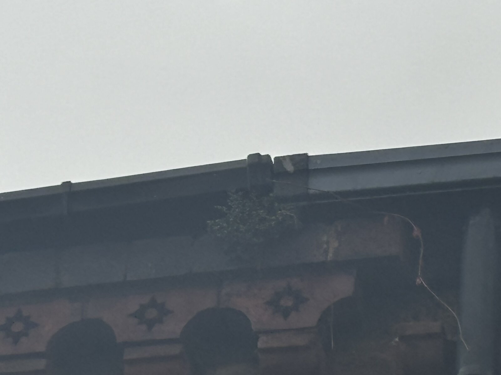

I wondered if anyone knows the profile guttering to the right of the picture, need to join two house gutterings together due to leaking from where they meet up.
Pics attached….
Can’t get the information from homeowner on the right of picture, due to no longer alive and did not pass details on.
Any help would be appreciative thanks
It looks like the Twinplas style as below....
Yes, absolutely agree after looking online so spot on thank you DAZB now need to find if they do a connection from that profile to
FLOPLAST PVC SQUARE GUTTER BLACK 114MM​
So that they both join up correctly, says they are based in Burnley so will speak to them tomorrow, hopefully they have a connection to match the two together….
Worst case scenario option 2 is replacing the whole gutter system to the left side house, to remove leaking issue.
Many thanks, and will let you know the outcome…
