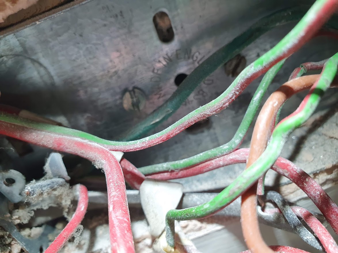

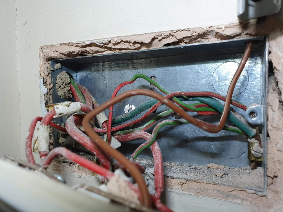

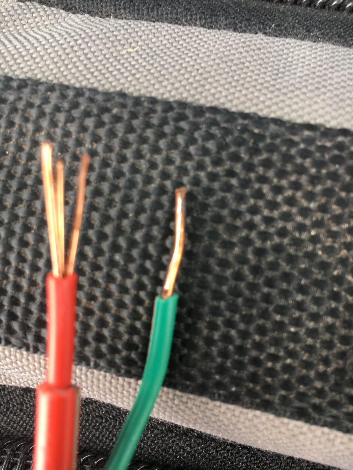

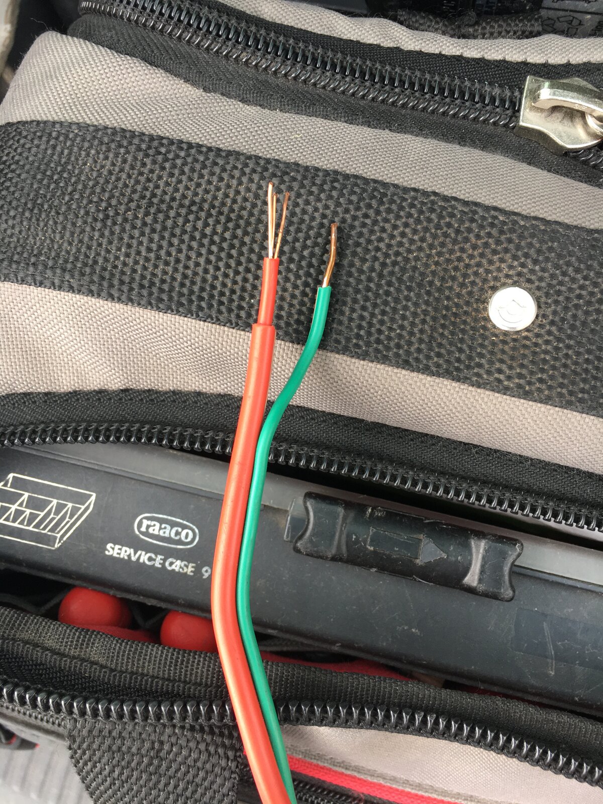

Never come across this type of cable before. A red & green twin that strips like bellwire.
The red is double insulated, but when it's been separated the cpc still has some (a lot) of red on it.
Very strange.
(none of my work by the way o_O)

Very strange, indeed!
The green (plus 'a lot of red') looks to be fairly loose on the conductor, as if it were sleeving rather than insulation ...

It does look a bit like that John, but I think it's just a bit brittle perhaps. I'll take a closer look when I go back.
You can see where they're not actually parted (as a pair) that the colour continues.

Agreed, but the thing which struck me most (as visible in both the photo-snippets I posted) is that the conductor seems appreciably smaller than the inside of the 'insulation'- which one would expect with sleeving but not with 'moulded on' insulation. Whatever, it's certainly very odd, and, for what it's worth, not something I've ever seen!

Can't think of any actual advantage of using this stuff instead of the more usual 1 core+earth sheathed cable.
3 strands in the core doesn't seem as normal as 7.

I'm not quite sure what we are being shown. Did the 'switch drops' consist of two separate insulated-and-sheathed singles (the other one presumably being black) plus a separate green CPC - or was there a further sheath around all of them?
The norm for lighting circuits was 3/0.029" (around 1.5mm²), wasn't it - i.e. 3 strands, not 7?

Come to think of it, I think the old imperial lighting wires did have three strands.
Presumably the old switch drops would consist of two or three of these red and green cables. I don't think blacks or neutrals were brought to the switch, particularly around the 1960s as suggested.
I should think the switches were wired to two plate conduit method.
With this method, there would be single sheathed and insulated neutrals running to the lights. most likely without an earth wire.
As I understand it, the red is sheathed and insulated, the green in only insulated, and two are 'stuck together' sort of thing.
